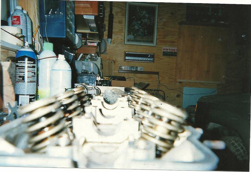

    Be sure to thoroughly inspect everything when you get the valve cover off...make sure you don't have a valve guide that has dropped down (like I did)
    Note the brown plastic seal on the left [normal position] and the one on the right [popped up]
    ...and note the position of the existing valve seals...make sure they're in place and not popped up, but also take note of how the new ones should look when installed. Be careful removing the old valve seals so you don't scratch their seats, and watch for little plastic boogars left behind from them...they can glog the oil system.

    Hey royster, I got everything apart and all was fine until I put pressure on the number one cylinder and then the center of the jet valve on the back cylinder shot out. Well I took the rest of it out and it looked like the end was burnt off of it and the strange thing is this is the only cylinder that the spark plug looked like it was burning clean. I went ahead and took the other 3 jet valves out and they looked fine. Since it is the weekend what do you think about me tig welding all of the jet valves up on each end and replacing the O ring and putting them back in the head or should I order the elimnator and put them in? I hope that the end off of that one jet valve is not laying down in that cylinder, I took my pin magnet and ran it down that cylinder and found nothing. Hopefully you and maybe someone else that has been through this will chime in. Should I pull the head? I do have one of those small camera that I can look down in that cylinder with but my friend borrowed it and I can't get back until Monday. Somebody give me some suggestion on what to do!!! Thanks
    1,267
    Wow, what a discovery, ay?
    This is one for the experts, as my experience with the 2.0 is pretty limited. However, my racing friend spoke about how they used to weld those jet ports shut. That, of course, would involve removing the head and sending it out to have that done. Most everyone I have heard talk about these jet valves find them worthless. My vote would be to take the head off and see what you've got going on. Wait and see what the forum pros have to say. And look around your area to see if there is someone who CAN weld them shut.
    But it seems to answer your question about smoking, doesn't it?
    I can offer replacement jet valves should you decide to keep them intact...I have a 2.0 head I won't be using and could take them off. Eliminating them seems the best way to go, though...for the reasons you just discovered.
