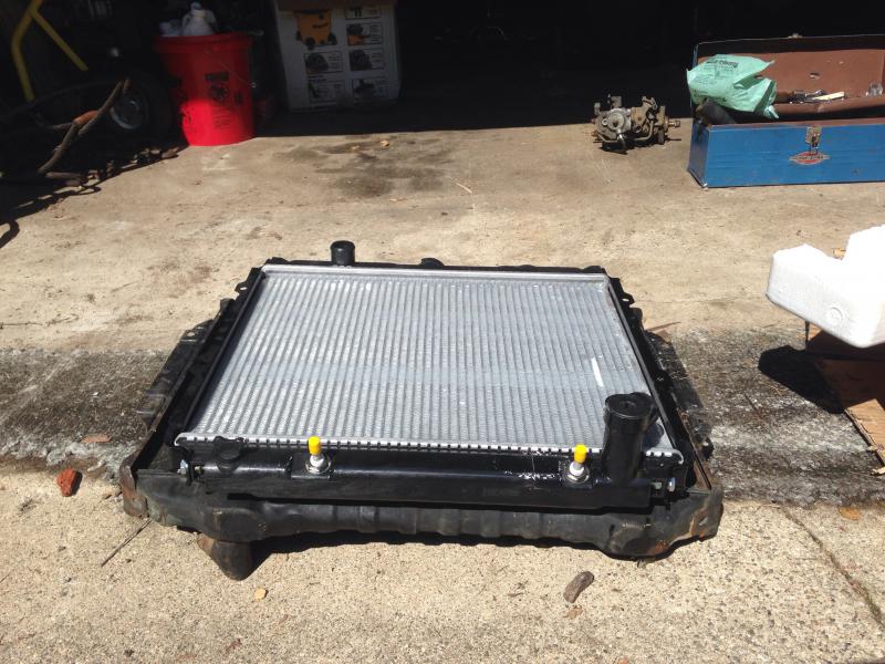

I ordered that $103 radiator from

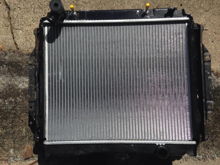

Rock auto for the ram 50 2.6. I typed the year 1985 as well. Well I just got it in the mail and the holes DO NOT line up. The 2.6 radiator seems to be about 3 inches side to side shorter. I can make it work by making some sort of bracket but it won't look as good as just bolting up.
They sent you the wrong one. That has a cooler for an Automatic transmission. That's for a 2.0

That looks identical to my 2.0 radiator, but yours has that Automatic transmission fluid cell for the transmission fluid to flow in and out of. Some people cap these off and don't use them if they have a manual transmission, but if you can get the right one that doesn't have them, it would be golden for a manual transmission.
