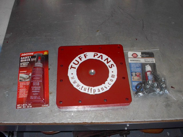

    Use the stuff on the left, Loctite 518 Gasket Maker
    11-03-2013
    58
    Centerville,TN
    1984 Mitsubishi Montero
    Is that the anerobic kind?
    4,817
    no, that is silicone gasket maker
    04-04-2011
    711
    Columbus, OH
    1992 Mitsubishi Mighty Max
    Yes, thick and goopy, no leaks.
    11-03-2013
    58
    Centerville,TN
    I know that we used an anaerobic type (if that's even spelled right) in the farm equipment shop that wouldn't setup unless it was compressed. You could wipe the excess off even the next day after assembly but it would seal excellent.
