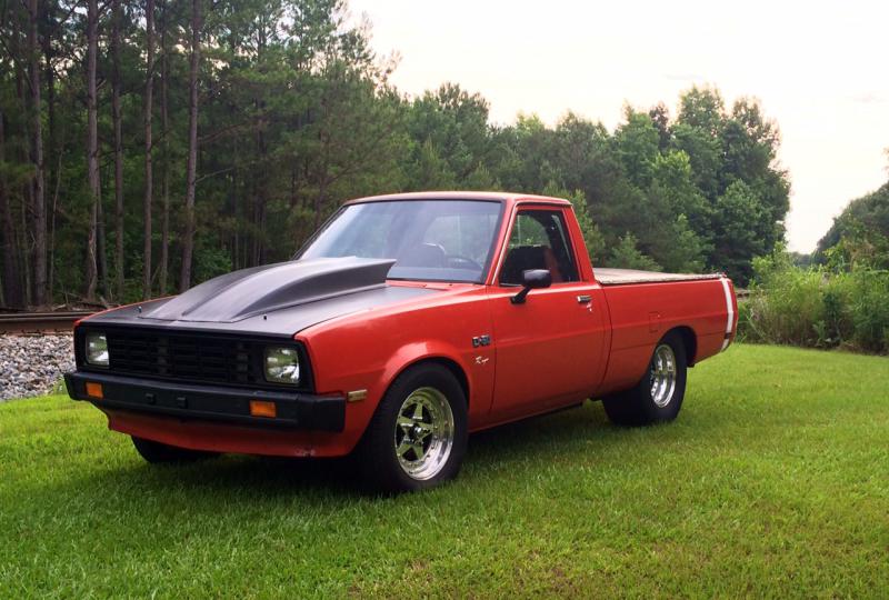

    I have a stroked 340 (394) in my 1980 D50. It is a pump gas motor and made 662hp and 533 tq. There is plenty of room for a small block. I had to build my own headers. Ran a best of 6.21 @110 in the 1/8. I can drive it anywhere.
    07-02-2013
    35
    Alabama
    Dodge V8
    Picture..
