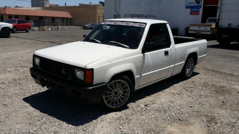

    Looking Back on the Year
    I swear I just bought the truck yesterday, but it was pointed out to me that this thread was started one year and four days ago. I've pretty much owned my truck for one year. It's hard to believe it has been a year already!
    Progress and plans have changed over the past year, but the majority of it, though off schedule and full of setbacks, has been pretty good. I have received a lot of compliments, PM's regarding "how" I did some of it, questions regarding what parts I used, and all kinds of thanks for helping and even inspiring others. I am truly honored. This group is really awesome!
    I have always wanted to make a kind of "timeline" post that shows the beginning to current status of my truck, so here it is. Everyone is welcome to comment in any way - I wont be hurt if you think my truck looked way better before I started it
    I only make that statement above about the comments because I went back through this thread and pulled the pics for it. Some of them show the truck looking MUCH NICER than current hahaha.
    The Exterior
    This was the truck as I purchased it in January, 2014.
    Despite having some dings and dents, it wasn't really that bad at all for being 23 years old. I later found out I am the 3rd owner, and the first owner was a local bread company. This was a dealer maintained delivery truck! I totally scored.
    Even though it was clean, it wasn't good enough. First I gave it some better looking mirrors (F1 style) and face lifted the front end with the '93 plus bumper and grille and a set of projector headlights. It didn't take long for me to realize that that wasn't enough. After attacking the chassis mods (314mm 4 pot big brakes, narrowed Ford 8.8 LSD, and suspension drop), I finished it off with a set of 17" Enkei wheels that are similar to Evo X factory wheels.
    This was was where the exterior started to go down hill. Some full readers of my thread recall "The Crackhead" that banged out and painted my truck back in June or '14.... Long story short, the dude was literally a crackhead and turned my simple Flat White paint job into drywall texture that is impossible to clean.
    I banged out Phase 1 of the chassis plus the interior in 4 months. I was going to debut this truck at MOD 2014. Once the crackhead finished texturing my truck, I cancelled my debut appearance. Some may even recall I wasn't able to get hood and tailgate back from the crackhead because he went to jail. This whole jacked up paint job literally derailed most of my plans and caused me to say "F**K IT!!" for a couple months. I even had a friend of mine make an artistic "rust look" on my hood and tailgate because they were never finished and painted when the truck was. I was so pissed.
    I o owe some thanks to the members here and all over that kept expressing interest in my truck even though I stopped posting and updating for a bit. I was totally derailed after that crack-ass paint job. It's still on there, but I have a few new additions I will take care of before I sand down all the texture and paint it again.
