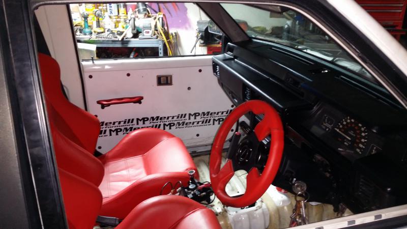

    It's easy enough that the truck is finished today lol. 5 day RHD swap (personal best). I still need an alignment, but no biggie.
    I'll finish updating the last few days later on.

    I promise I'll get more pics and stuff up later. My intentions were to update every night, but it was intense work and I became exhausted. I have only a 5 day window to do this so I had to focus and get it done.
    Total work time is 36 hours. This is the easiest RHD swap I've ever done over the years mostly because I didn't have to swap the firewall out completely. Since the firewall is mirrored, all I had to do was cut and paste. It was so easy to do. Welding and fabrication is my profession, so it comes out looking really easy to do. Truth be told, anyone with basic skills can duplicate the work I have done. This swap is really that simple.

    Ok so I will have to bring this back up to speed real quick.... probably a 2 post update or so...
    After driving around for just one night and this morning, I have been stopped by other drivers all over to ask about the truck and what it's like to drive a RHD. The funniest part is I was at a light being asked about the "first time" I drove my truck like this only 2 minutes after I got in it the first time I told the guy "Thisis my first time. I just finished the swap 15 minutes ago..."
    Driving a RHD isnt strange to me at all. I've built and driven many over the years and I am kind of used to it in a way. Sitting on the other side, shifting with my left, and getting in on what would normally be the passenger door is not awkward to me. What is awkward is that it is my truck that is the RHD lol. I've never owned or driven for a lengthy period of time a RHD that I had previously been used to as a LHD. The very basics like feel and position as you take a corner, or knowing what "fast" feels like all completely washes away with a new feel as you control the truck from the other side.
    I still do habitual things like grab for the seat belt over my left shoulder and automatically let my right hand off the wheel during accelerating to shift, but I think that will stick around for a bit lol.
    And there you have it. I highly recommend getting a damn good alignment after you are finished with the swap. You'll be doing yourself a huge favor with that...
    I must make one thing very clear about all of this. Everything I have written and updated here is NOT by any means intended to be a write-up so you can go do it yourself. This job is for the professionals. I don't want to sound rude, but if you "need" a picture perfect write up on how to do a right hand drive swap - you have no business doing it.
    Please do not attempt this swap if you have no professional experience in this field.
    If you have any questions or comments - Post up of PM me!
