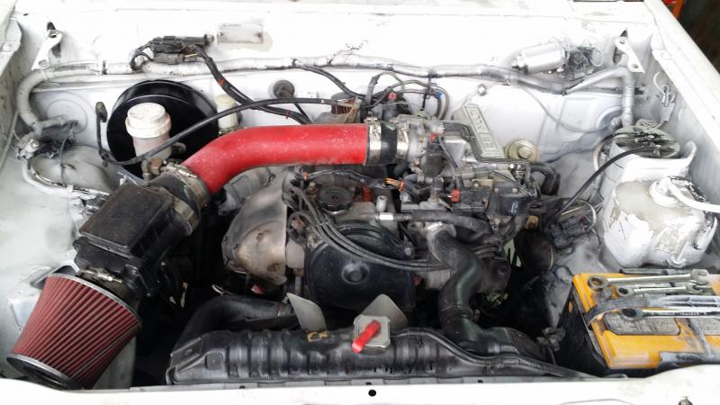

To make works very easy, I stripped the whole truck. This literally took 3.5 hours from start to finish. Engine, transmission, complete interior, and harnesses came out. Here's the thing.... The engine does NOT have to come out, but think of it this way - 30 minutes to pull it vs. 3 hours of lost time trying to work around it.

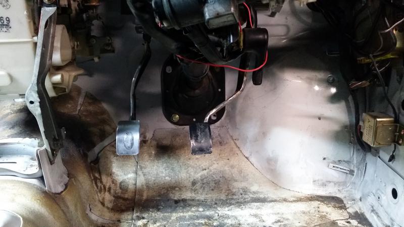

Next is the clutch master and brake master cylinders. This takes nothing more than a few precise measurements and a drill. The big holes are cut with a hole saw, the small holes with a drill bit. Very simple. After making the holes, mount it up.
Mitsubishi Mighty Max Right Hand Drive Swap Merrill (13).jpgMitsubishi Mighty Max Right Hand Drive Swap Merrill (14).jpgMitsubishi Mighty Max Right Hand Drive Swap Merrill (16).jpgMitsubishi Mighty Max Right Hand Drive Swap Merrill (19).jpgMitsubishi Mighty Max Right Hand Drive Swap Merrill (20).jpg
This is what you end up with when you do not have RHD pedal assemblies.... I'll fix these later.

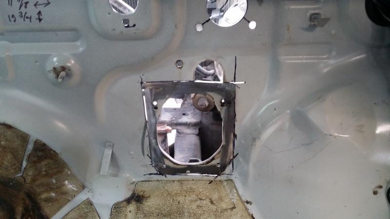

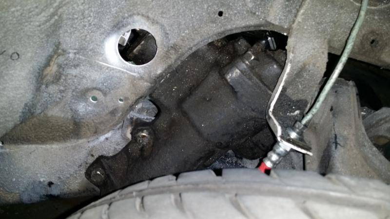

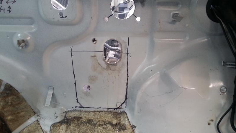

Now we get to the fun stuff. The steering hole needs to be transplanted to the right. This isn't terribly difficult to do, but is easy to screw up if you don't take your time. You dont need any special kind of shape to cut it out, but the simpler the shape (like a rectangle), the easier it is to cut and fit to the opposite side. Remember to measure the placement of the steering gear box in relation to the opening. I used the same parts of the firewall that are mirrored on both sides as reference points for placement of the steering hole.
Mitsubishi Mighty Max Right Hand Drive Swap Merrill (24).jpgMitsubishi Mighty Max Right Hand Drive Swap Merrill (25).jpgMitsubishi Mighty Max Right Hand Drive Swap Merrill (26).jpg
If you have looked closely at your truck you may have noticed the firewall is reinforced around the brake booster and steering hole. Since this truck was originally LHD, the right side must have reinforcements added to it. If this step is ever omitted, every component will likely tear itself out of the firewall like the cable clutches often do. This is nothing more than adding some sheet metal plating like so...
