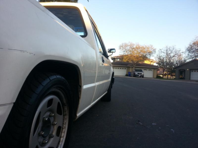

    So after a short trip up to San Marcos for my buddy to look at a mini truck for himself, I decided real quickly that this Mighty Max diff simply will not do. With the smaller tires, my engine was screaming, the speedometer read 87 MPH while the GPs pegged me at 79 MPH. As if that wasnt bad enough, it sucked my fuel tank near dry from all that continuois high rev. To hell with that....
    I sold my factory 14's already, so the quickest fix I could think of without spending too much money is going back to the yard and grabbing an Explorer 8.8 with 3.73's and a locker. It is also equipped with rear disc, so it's definitely a good buy. The only money I have technically lost is 30 bucks for 2 of my 4 Rodeo wheels I just bought.
    The entire rear assembly, plus wheels and tires was $170 bucks. I will narrow this down and prep it for the Montero Sport rear sway bar as well. I will also provide a write-up on how to narrow the 8.8. Its very easy if you have the means, or access to the tools.
    Every Mini-Trucker has their own right of passage during their build process. For some it is when they get their first set of ball valves and air shocks, for others it is the first peak they cleared after a torsion bar lift. All are moment in time where you know you crossed that point of having the "normal" truck, or the average mods. Before I started manufacturing aftermarket performance products, or built a single race car, I was a bag 'n dragger. Lowriders and Mini trucks were my scene, and chassis were all I built. My right of passage for every truck I built (for myself or clients) was the first time it rashed a speed bump.
    Even after all these years, I still get a kick out of the little things
    Here is a decent shot of the truck. I really need the new '93+ front end already.... I keep buying everything else instead.

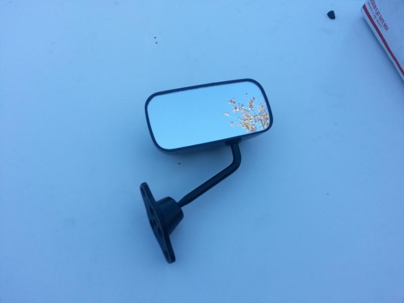

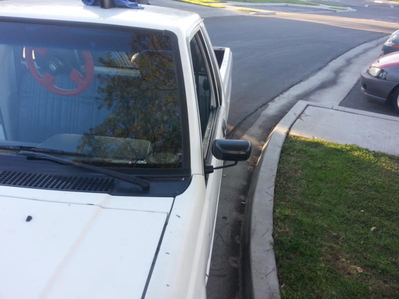

    I made another appearance gamble on this truck..... I always liked the clean look of F1 Mirrors, and I can't stand the Mighty Max ones. To me, they just look out of place on the Mighty Max. I tool a stab and spent a few bucks on some F1 style mirrors.
    The only problem is there is no adapter for a Mighty Max. My vendor sends the mirrors with or without adapters for the same price, so I looked at the Evo 1-3 versions. They looked close, but if they didnt fit I have back up. These trucks were often equipped with the giant towing mirrors that bolted to the door. Since the small mirror isn't used, the factory installed a blank cap in place of the mirror. I snagged a pair of those just in case.
    Turns out I needed them. The Evo ones are really close, but I wasn't going to bother with it since I have the factory blanks.
    Here's how it looks
    20140310_180917.jpg20140310_180939.jpg20140310_182904.jpg20140310_182916.jpg20140310_183411.jpg
    I've never seen these on a Mighty Max before, but I think the gamble paid off again. I love them!
