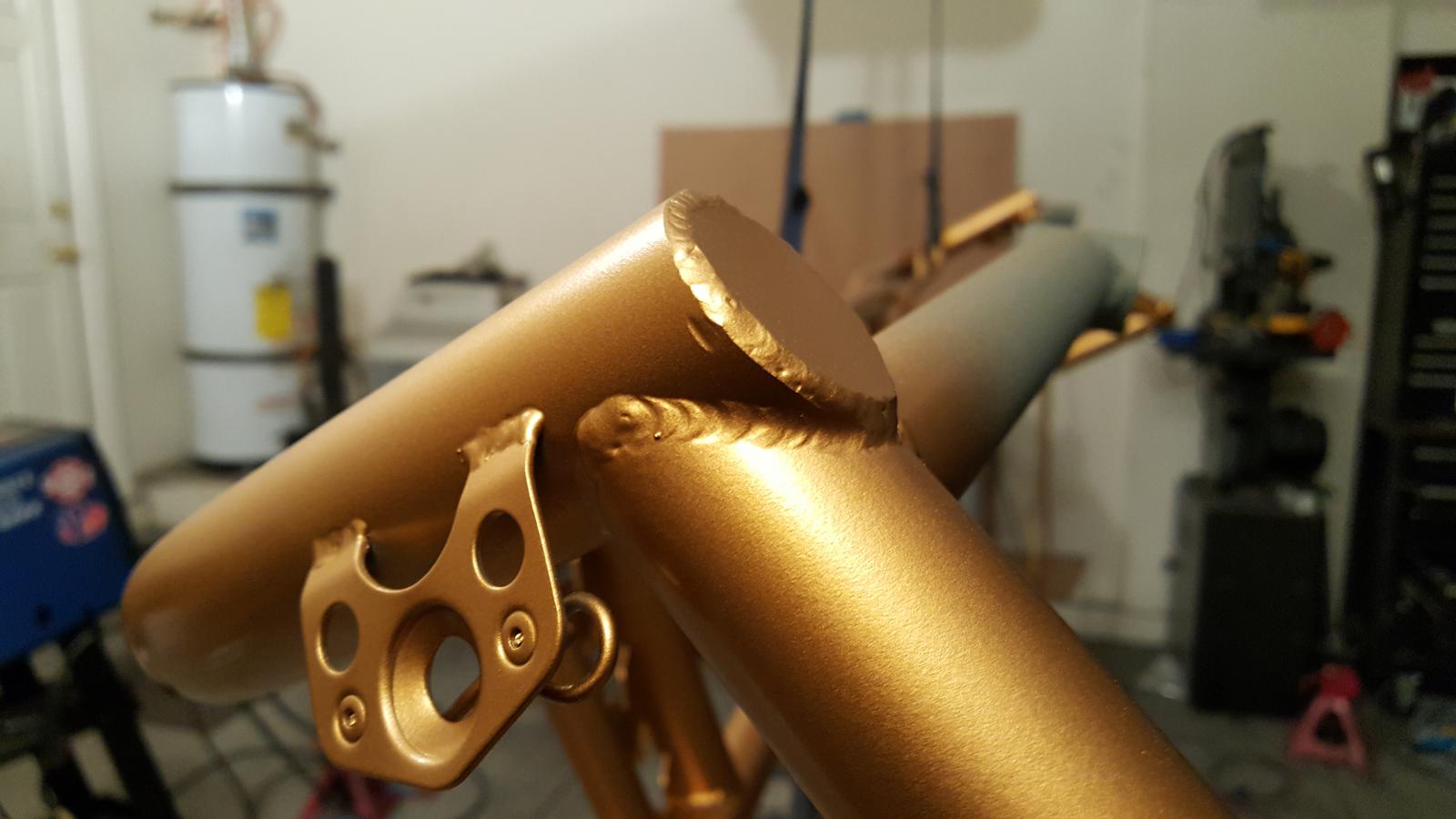

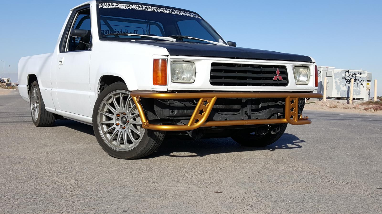

    This year I decided to dress up the front a bit and have a little fun. I' had some left over steel tubing from a previous build, so I decided to update the front a bit. The 93+ front bumper is my favorite out of all the MM front ends, but the brackets I built years ago didn't really do anything except hold the bumper up where it needed to be. It offered no safety at all, but then again, it's not like the factory ones are much better haha.
    I decided to build up a nice little combo piece that would offer up better protection in the unfortunate event of a collision, and hold the bumper on the truck. This could have been anything to be hidden behind the bumper, but I really wanted something to show off. I decided to go with dual purpose a Bash Bar design.
    Bash bars are very simple in their own design. All one really needs is a few tubes and a mounting location to make one. In this instance, I wanted the Bash Bar to be tucked away and completely hidden under the bumper cover. I would like it to not be seen unless I take the cover off. This required a bit of clever fab work to make the Bash Bar take the shape of the bumper itself.
    While I was putting it together, I figured I might as well have something more than "just some tubes" to show off once the cover was removed. Since the Bash Bar is designed to take the general shape of the bumper, I decided to make it look somewhat like a bumper when the bumper cover is removed. This also gives the viewer something to stare at while the bumper cover is removed.
    I believe in practicality (for the most part haha). The idea of having a handful of tools to pull the bumper cover off sounds a little impractical to me. I really don't know when I'll really "need" to pull the cover off in only a few seconds, but the ability to do it is appealing, and makes sense. Nothing really says "race car" like actual race car parts. Dzus fasteners can be found all over the racing scene. They can even be found holding most cars together. The genius of a Dzus fastener is that they only require a flat shaped object (screw driver, a coin, or a key) to give it a quater of a turn to pop it out. They sit flush with the panel they are mounted to, and they hold up well. I decided to use 4 of them to mount the bumper cover to the Bash Bar itself. The result is nice and clean, and the cover can be off in only a few seconds.

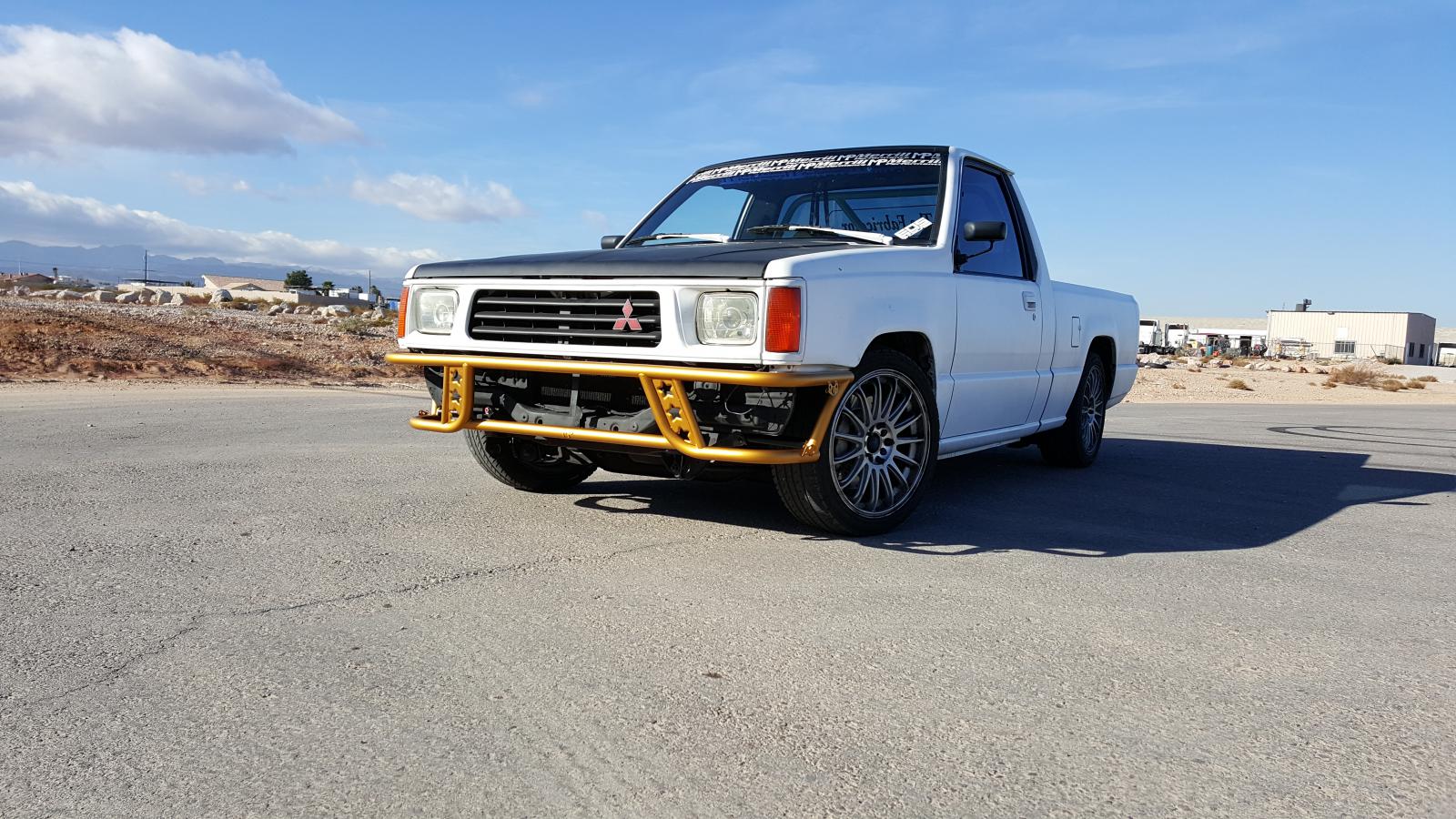

    Here are some of my favorite shots of everything all put together.
    Finally, I found a deal I like on a set of wheels. There was really nothing wrong with my 17" Enkei's, but I plan to get stupid on my brakes again and jump up from the 12" rotors up front to a set of 14" rotors. This will require bigger wheels. In addition to that, I really wanted something a little less "hover craft" on the truck. I wanted a decent lip on the wheels to fill the gap a bit. The result s a set of 18" XXR wheels. They're cheap, but they'll do for now. Once I get more build time, I'll definitely switch up a higher quality wheel.
    That's all I really have for now. I do have a few other pieces to build for the truck which I will post up at some point. Hopefully it wont take as long to update as this time.

    My hat off to you Merrill, that is some very clever and well executed fab work on your bash bar. No wonder it has been a while since your last update. Now you're gonna have to detail the sub frame behind the front bar lol. It looks naked back there. What about the front indicator housings? Are there any legal issues with not having those connected while driving?
    Thanks! It's looking like I'll just barely have the time to build my intercooler and oil cooler setup which will fill that space in nicely. I just started on it tonight. Im converting the corner lights to dual filament bulbs for the indicators and running lamps. The front lenses will go clear to serve as fog lights while the bumper cover is attached. Technically it is illegal here not having them, but I have yet to receive a citation for it.

    That bumper is serious stuff man
    Are the stars press cut using a dye? Id like to see the mitsu diamond logo like that.

    The stars are dimple die panels which are CNC laser cut. I get the panels from one of my sponsors called IHeartGussets.

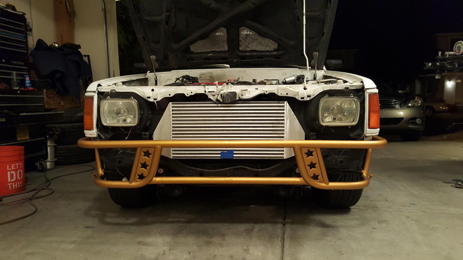

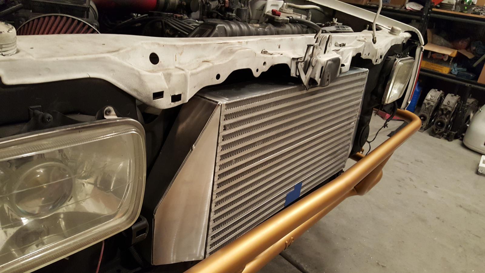

    I managed to find the time to build my intercooler and il cooler setup. It was so awesome to see it come together so quickly after getting it all drafted up and calculated for the truck. It was so perfect.
    The day after I finished the oil cooler bracket/latch support, I was involved in a collision. The part that sucks is the other driver was at fault, but said she doesn't have insurance, and none was provided on the report. It has turned into an investigation, and it's looking like the truck is a gonner. I'll keep it updated as I know more.
    Here are the pics of the intercooler and oil cooler systems.
    This is the last pic of everything assembled. All I was waiting on was my oil cooler relocation pieces to arrive so I can finish mock-up and get the assembly pressure tested and coated. It was taken the day before the collision.
    I always try to look at the bright side of everything. It sure beats sulking in misery for ever. The bright side is I was able to collect data to further back up the design behind my products. The bash bar did exactly what it was supposed to do which is bend ONLY the mounting brackets. That means the brackets themselves, about $5 worth of steel, can be rebuilt and reinstalled to the Bash Bar without the bash bar needing to be completely rebuilt.
    The best news about all the data collected from this collision is calculating the damage based on a rather "unrealistic" circumstance. Bash Bars are primarily used in racing where there is contact to another vehicle or wall - not necessarily a collision. I T-boned the car that I was involved in the collision with. After running the math on it, I exceeded the average contact load on a bash bar and the intended damage remains the same. That is fantastic news regarding design and engineering principals.
    The second bright side I see here is the intercooler is undamaged due to the design of the front end. Most of this is due to the design of the Mighty Max core support and how it impacts, but the intercooler was mounted to the sheet metal of the core support just like the radiator. The sheet metal is easily deformed which means the intercooler was simply pushed back. The oil cooler itself is destroyed, but oh well. A new Setrab Oil Cooler is about $150 or so.

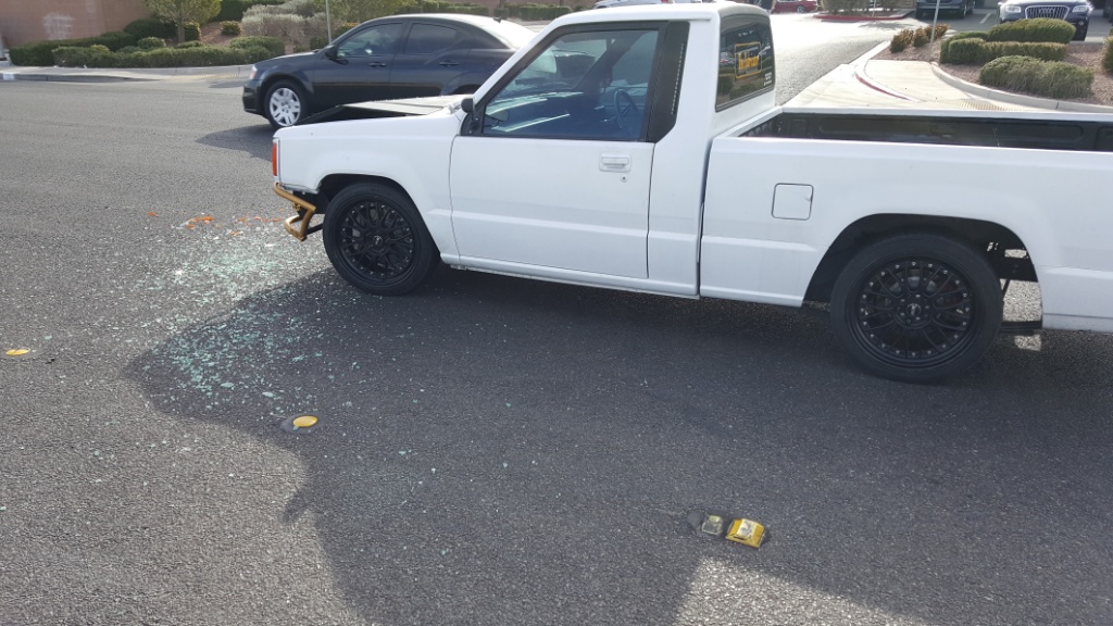

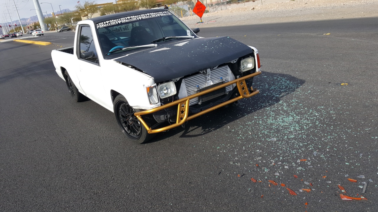

    Here are some shots of the accident itself
    While you might be looking at the pics and thinking something like: "Well, that doesn't look so bad."
    You're right. It doesn't look that bad, but unfortunately lurking beneath the twisted metal is the real damage. I hit a Cadillac at the left rear door (mostly), but the C-Pillar of the car is what caused the whole right side of my truck to get pushed rearward about 4-5 inches at the top front corner where the corner light is. The whole right side of the Mighty Max structure is crushed. My door doesn't even open and close correctly anymore.
    While it may be repaired, and it is not out of my ability to do, I'll lose entirely too much money and time in the end to only end up with a salvage titled vehicle. I have to assume that's all I will end up with since the other driver is not insured. Of course, I'm still waiting on the answer from the insurance company.
