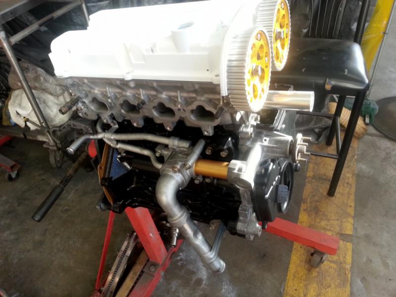

    Today I was able to finish the mock-up of all the parts minus accessories. Here are the corrected heater pipes. I think they look much better, like they actually fit, shortened.
    Here is the whole engine coated and assembled.
    Next will be the valve cover vents and coating. With any luck, I will be able to solve the fitment of the accessories after converting to a single 6 rib serpentine belt.

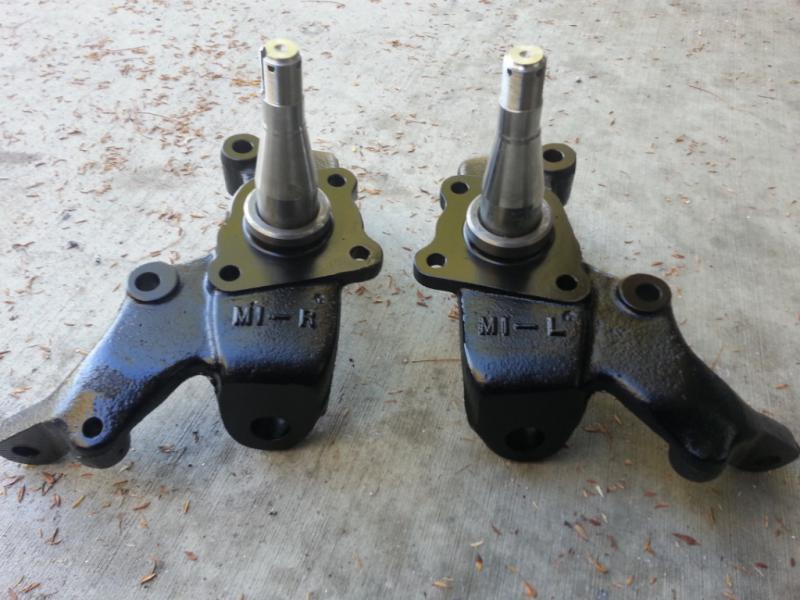

    EVEN COOPER NEWS for today, my drop spindles showed up an hour ago. They arrived in one day. Already being coated with a protective epoxy coating and I'll have pics a bit later.
    I did a fit check and the caliper fits without any obstructions so that's great news thus far.

    These pics don't do the size of these calipers much justice, so I found something to compare it to
    And here we have some assembly and coating action. Nothing fancy.
    One thing I will do is change the wheel studs from metric to standard. The Explorer studs are 1/2"-20, and both Mitsu and Toyota use 12mm. I want extended studs for my race wheels (when I use them), and its easier to find an extended stud with the correct knurl diameter needed for the Tacoma hubs, so I will swap it all over to 1/2"-20. I'm still waiting on the extended studs, brake rotors, pads, and a couple other pieces to show up from my vendors. Hopefully sooner than later....

    Those calipers grab a lot hard than the stock ones, I have been using for while now,nice to see somebody else trying them out

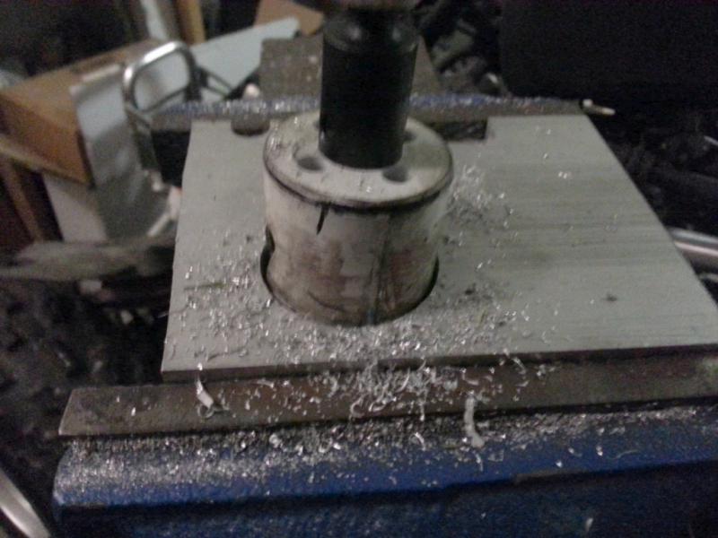

    I do have to modify the hubs to fit these though. Its easier to find the right knurl diameter for 1/2"-20 studs than it is to find 12mm. The price is better too when you do find them. Since the Ford 8.8 is equipped with 1/2"-20 studs, I want them all to match, and these were easier to source, I chose 1/2"-20. I couldn't find a close enough size to the Tacoma hubs, so I will drill them bigger.
