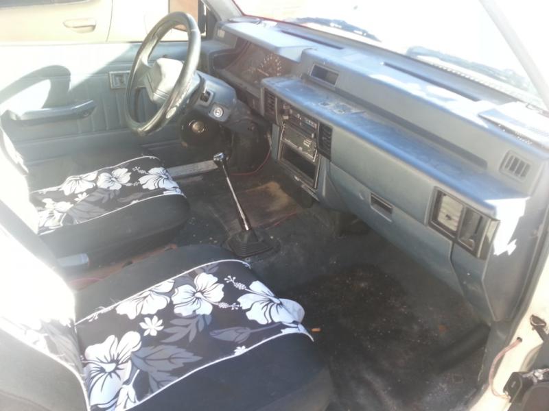

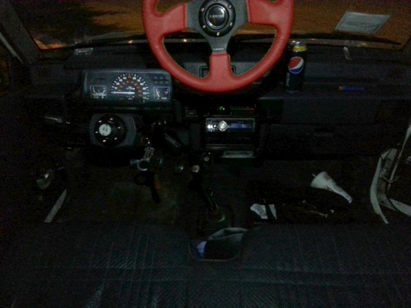

    Here are a couple quick pics I snapped before heading back down to San Diego this week (I travel back and forth all the time).
    Interior - extremely dirty and blue... Gotta color change it eventually.
    And the current 8 Valve lifter ticking engine that could

    I couldn't help but notice the flowers on the seat covers. Don't tell me...your wife picked them out or it came with them?

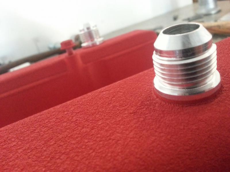

    Those brakes look real nice that your doing. As well, the valve cover is looking good too. Will the wrinkle paint hold up to petroleum products possibly getting on it and not softening the paint? I know the epoxy should be fine, atleast with my experience of using a 50/50 epoxy paint on RC Nitro boats.
    I want to paint my valve covers on my MR2 and the wrinkle paint looks pretty decent.

    Thank you. Wrinkle paint is rated to 350*F and resistant to the usual paint killers like oil, grease, and de-greasers. I have seen them fail, but I am about 99% sure the reason was incorrect application of it to the piece coated. I have never had a failure with wrinkle coatings personally and I have definitely abused many of them.
    The key is following the "principal instructions" like cleaning, coating according to instructions, baking the coating one, etc. They are rather flexible though. I sand blasted this, cleaned it, heated it, primed it, cleaned & scuffed the primer, heated everything up before coating, laid 4 very heavily misted coats (about 3 misted passes per coat) 5 minutes apart, let it sit for about 10 minutes, then baked it for 12 minutes at 325* on our coating oven (you can use a household oven too). This process was modified from the VHT instructions, but the principal instructions and prep are the same.

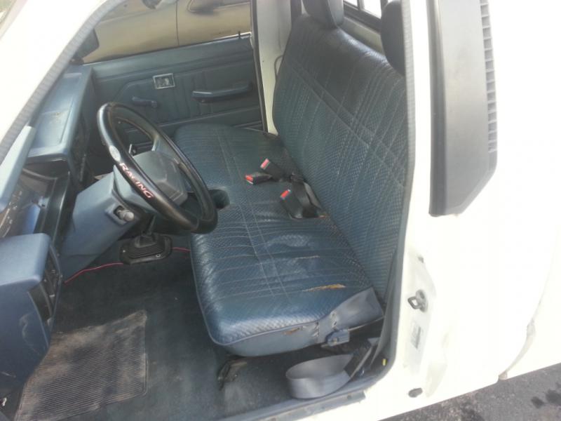

    Those pretty seats are no longer in the truck
    The last owner could tolerate them more than I can. The way they mounted the buckets pushed them forward about 3-4 inches. I am 6'2" and hugging the steering wheel isn't my style. I was lucky on this one because the owner still had the bench seat. There is no way in hell I could drive that thing back to San Diego with my knees on the dash, so I tossed the flowers and put the bench back in.
    I also cleaned up the interior a little bit. It is really messy and a bunch of stuff is ghetto fixed/modded/rigged. I really hate seing half-assed work. There is absolutely NO REASON at all to not take an extra 30 seconds to run a wire under the sill panel instead of stretching it across the floor.

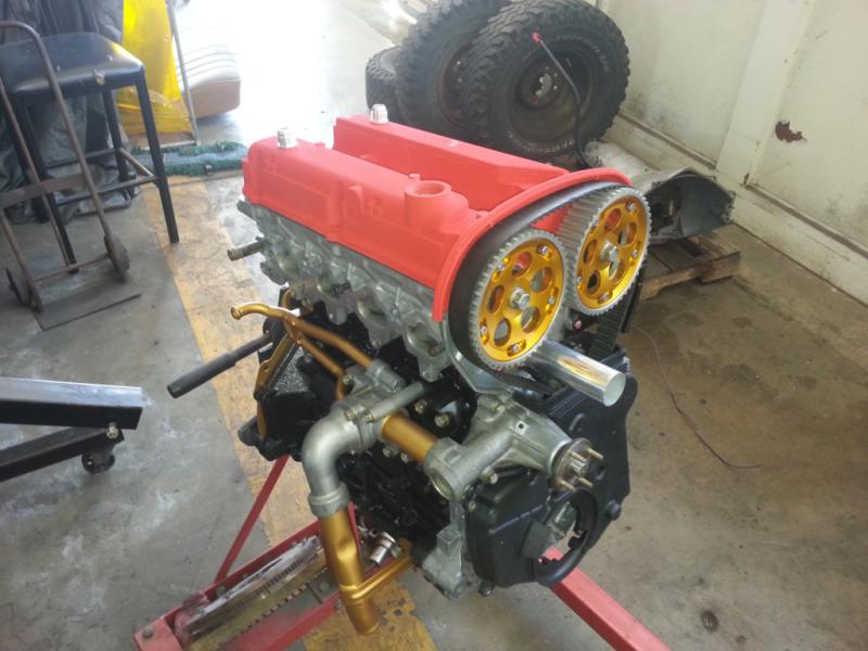

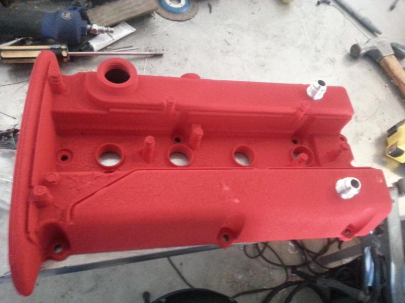

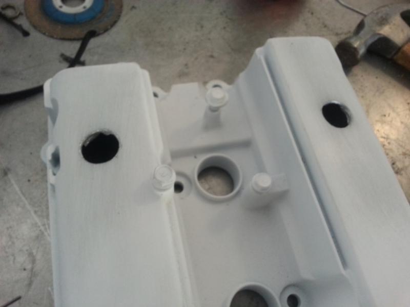

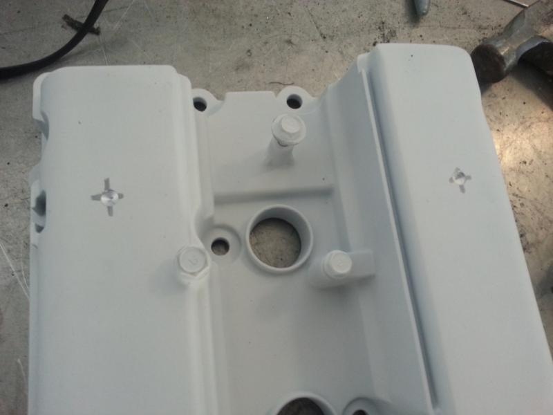

    Speaking of engine..... I was able to get the valve cover done today. We modify valve covers for high performance engines all the time, but if you ever wanted to know how it is done - here is a quick picture how to.
    Simply measure, mark, cut/drill, and glue (epoxy). You need a very strong, high strength, high heat, 2 part epoxy to make aluminum stick for ever. We use an industrial formula bought in bulk, but there are probably some over the counter brands that will do the job.
    It's very easy to mod, only takes about 10 minutes. After the epoxy cured, I wrinkle coated it and stuffed it in the curing oven for a heavy wrinkle. I did end up with a couple blemishes, but they are very easy fixes.
    I have to run back to Vegas again tomorrow to take care of a couple clients, but I will be back Monday and will get a couple shots of this on the engine. I'm anxious to see how well it blends with the gold.

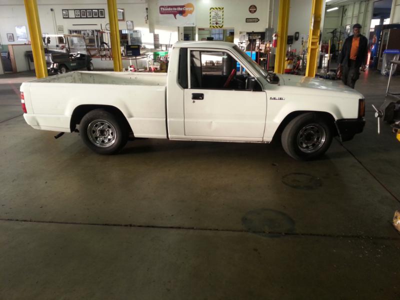

    On another note, I serviced a set of lifters, gave it a full tune-up, drove it around for a bit, smogged and tagged it, and now I'm good to go. Not bad for a days worth of work and the truck runs better than ever. I'm kinda liking this little 8 valve.
