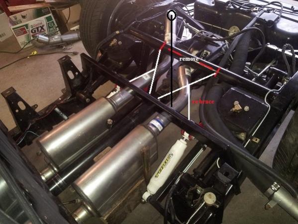

    I really hate the exhaust pointed down giving me that Yard blower effect on a 15 year old gravel drive way, next complaint the Rumble under the truck and lastly how ugly it looks.
    I've been brain storming trying to get the exhaust out from under the truck. Sounds stupid but I must cross and tie the tail pipe to get out. You see where I need to be and the notch I already cut out for clearance.
    It would be a tad easier if the stinking fuel tank wasn't there, but the brace is my heart burn for now.
    Here's what I've been thinking and I do always over build things.
    Question: Should I add cross bracing?

    Cut it all off then just dump it under the cab(i know leaf blower effect still)
    Can you run the pipe under the axle then do an S bend using 2 45 degree elbows to run along the frame beside the gas tank to dump out the back. Fill the bags to their full height and see if there is clearance, then dump the bags and see if they would scrape. I almost ran into the same problem so I put the mufflers under the cab and modified the middle x-member to pass the pipes through.

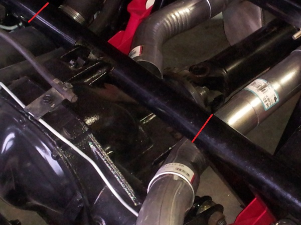

    I read your post a couple days ago. That looks nice and clean, did you have those ceramic coated?
    You made me think about a Y under the cab, then going single out is my best move.
    One of those times of, I couldn’t see the forest because of the trees. The thought of cutting that cross member is gone.
    I’m running small catalytic converters and their under the cab.
    Oregon, these old trucks still have to pass DEQ, so the first time I made a slip on with spring clips a dual to single tail pipe so they wouldn’t have to crawl under the truck and reveal it’s not stock.
    (It’s a closed hood inspection and just needs to blow 86 emissions standards, so I play it safe.)
    Deflated with it on I can lay (my hack job) exhaust pipe.

    Amazing how long you lay under a truck just staring and thinking no doubt I am a professional procrastinator.
    The way I figure it is orange county choppers can do it I can too, but you must start somewhere even if you do it wrong the first time, you can do it again.
    So with a zip cut disc on the grinder you start some where even if you screw crap up, I didn't but I’ve be working metal for a long time so this took me a couple hours, even less if I hadn’t loaned my plasma to a friend but now I really need it to notch the cross member. I do have friends with tubing benders but no dies to fit 2 1/4" and using a pipe bender crumples, dings, and flat out squishes exhaust pipe. As you can see
