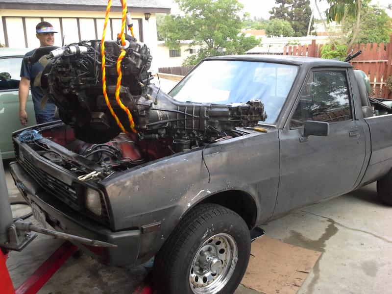

    1982 Mitsubishi Mighty Max
    20140120_143137.jpgits coming along
