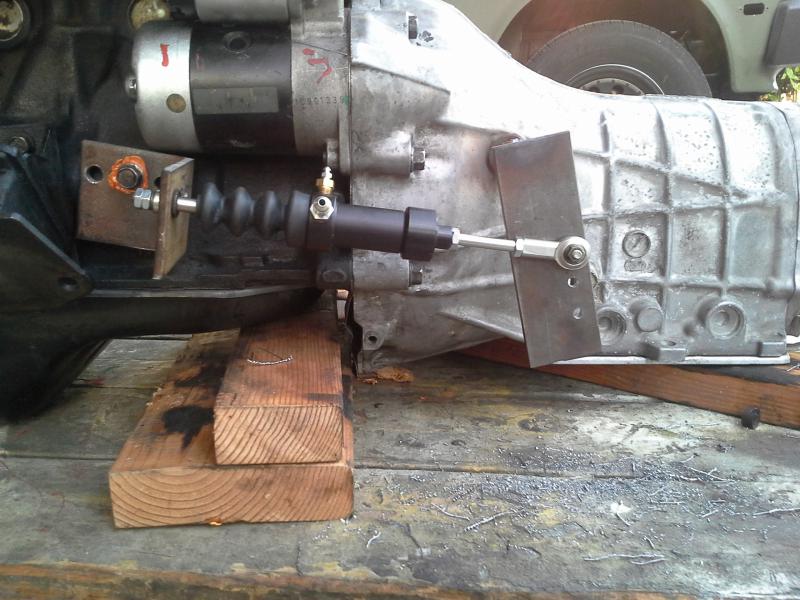

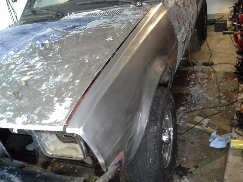

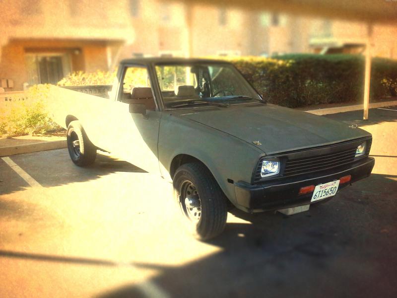

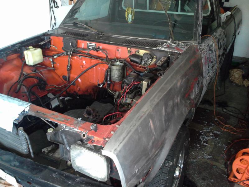

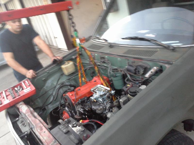

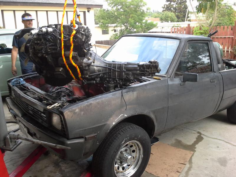

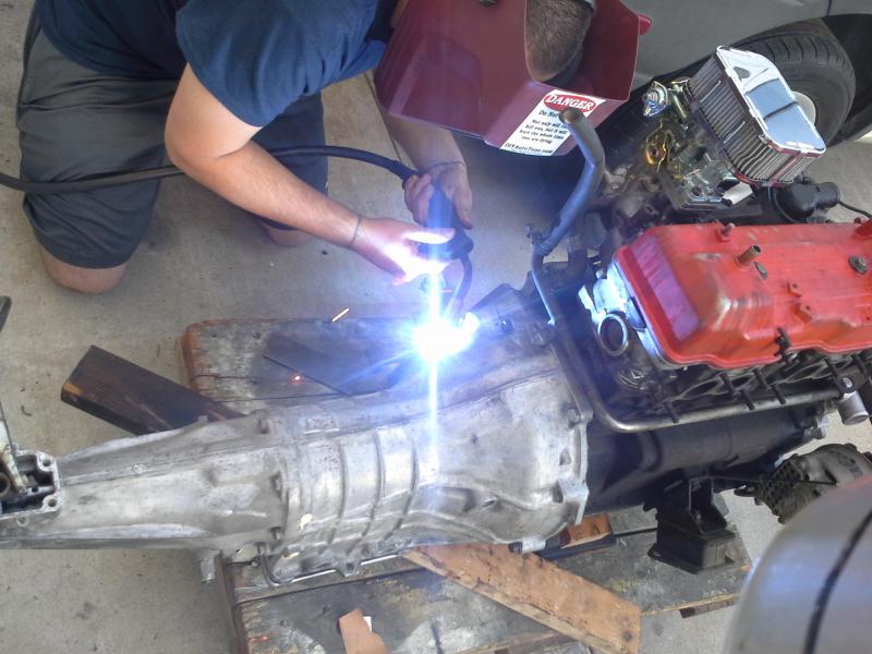

    still a project in progress, the body is an 83 mighty max but the engine is out of a mid 80s dodge d-50
    and its a diesel (4d55) to gas swap 4g63, 4 speed stick, with a new carb. i have spark and its timed, but its still wont start just back firing and spitting out of the carb. checked the plugs, wires, idk i could use some ideas. im going to do a compression test this weekend and see.

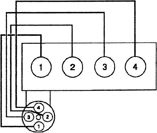

ID:	7898 this is what i was using and the handbook tells me the same thing
    789
    the Dis could also be out 180* so it's firing #4 not #1 which will cause it to backfire through the carb. Take the cap off, undo #1 plug, slowly turn the engine with a breaker bar on the crank bolt, Put a finger over the plug hole and when it push's your finger set it to the timing marks at 0* at that point. check rotor placement and see if its pointing at #1 or #4. I've been doing this for 30 years and even I get it wrong sometimes as the crank goes around twice to every once of the cam.

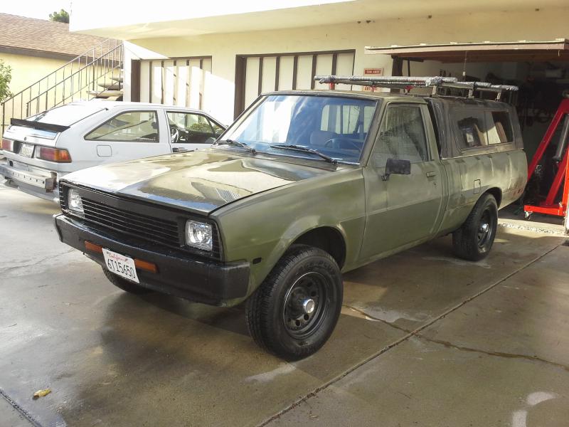

ID:	7930its coming along
