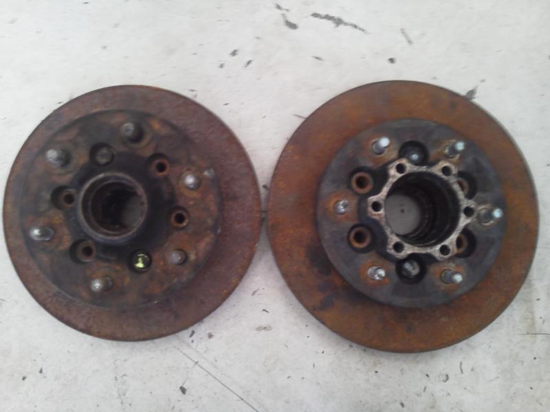

    I have been working on finding some bigger rotors that bolted to our hub, I found some about 3/4 of an inch bigger, I will try some more rotors on monday, This what i have so far

    Very nice. What is the year/make/model of these rotors as well? Are there any requirements as to the caliper brackets to fit these?

    The 4X4 rotors have a different offset compared to the 4X2,when you bolt the rotors to the hub there is not enough room for the caliper bracket to fit between the rotor and spindle.

    The 4x4 has to be drilled to fit the 4X2 hub, but there still the wrong offset, once you tighten the nut on the spindle the rotors wont move it's hitting the back of the spindle

    the montero caliper will work with stock rotor and you will notice a big difference in how well the truck stop,the problem is the stock rotor is too small for the montero brake pads, it sticks out about .25 of an inch.I am still trying out different rotors from every 6 lug application, I havent given up, just been busy my racing season started in january, as im typing this im coming back from Gainesville Florida
