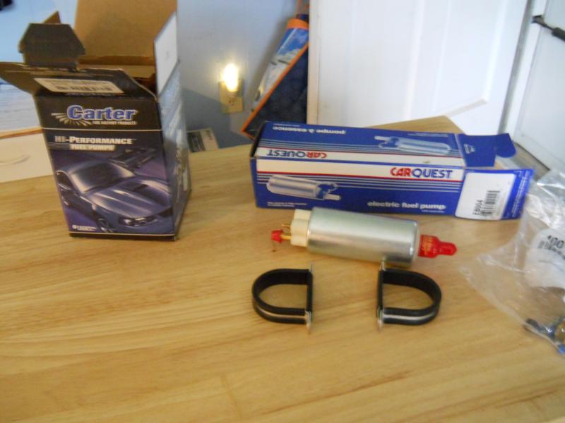

I bought a new insulator and gaskets for a mechanical pump for that purpose. The template is 'parked' next to the box the Carter P4070 came in.
Photo #8- The easiest and neatest way to wire the pump is to get a 10 amp 'Add-A-Circuit' from a national auto parts store chain. [I]Use the fuse slot for the horn because it is 'switched'. At first I used the slot for the dome light because it was the one of only two 10 amp fuses on the truck- howeva...it is un-switched which means if the door was left ajar by accident the pump would be running. USE THE HORN SLOT. The guy at Carter told me those pumps don't have a big draw- around 6 amps IIRC. An 'Add-A-Circuit' just splits the circuit in two.

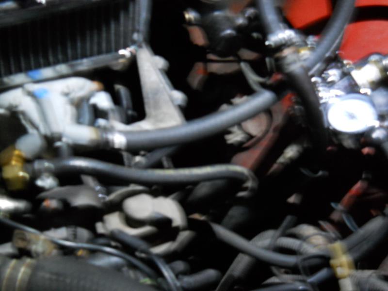

Photo #9- This illustrates where the power wire runs through the firewall. I have 2 wires running through the firewall in that area because one is for the power amp for my stereo. No measurements needed- just S.W.A.G it using the photo as a reference.
