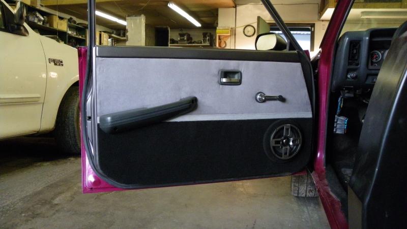

    I stripped all the old material off the door panels then used 1/8" Fiberboard to make new ones. Did the kick panels as well.
    used spray contact cement to attach the fabric.
    The panels are laying on top of the fiberboard.
    A 4x8 sheet of the fiberboard was $5.00 at home depot.

    Nice! Clean look, too.
