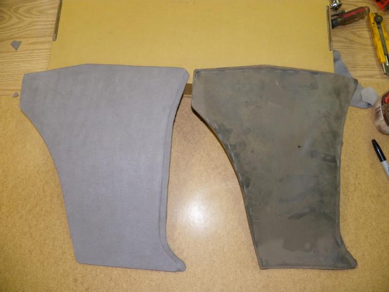

    I stripped all the old material off the door panels then used 1/8" Fiberboard to make new ones. Did the kick panels as well.
    used spray contact cement to attach the fabric.
    The panels are laying on top of the fiberboard.
    A 4x8 sheet of the fiberboard was $5.00 at home depot.

    Nice! Clean look, too.

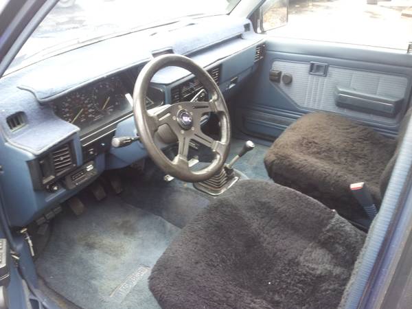

    Photo from a Graigslist post MyLittleShitty found. Nice looking panels with larger arm rests.

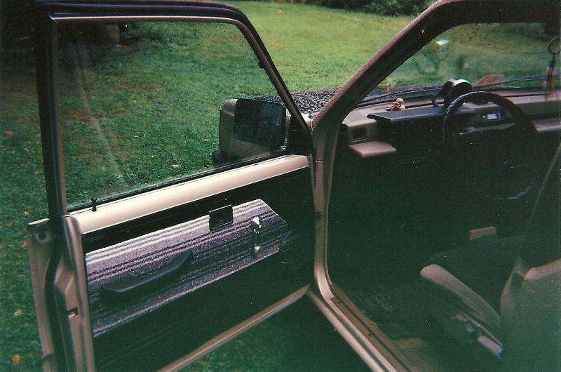

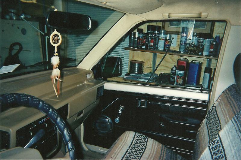

    Painting my door panels was only intended as a "quick fix": if I wanted to see Baby-Poop-Brown all the time, I would have had children. Not personally possessing a birth-canal, I opted to have cars, trucks and cats, instead. Neither of them demands college expenses or fashionable clothing. Sure: they talk back from time to time, but they won't put you in jail for smacking your truck. Unless you're drunk-in-public when you do so. And I know better than to smack a cat that can piss in all of my shoes.
    1,249

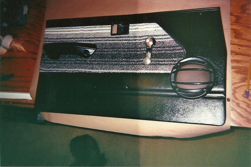

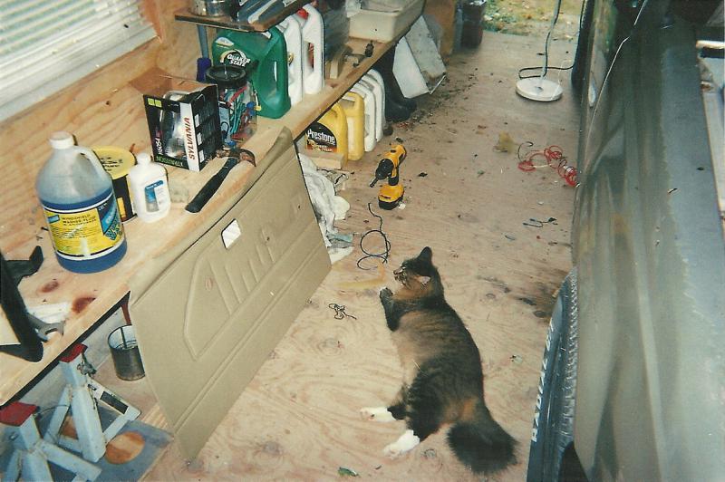

    I have templates for both the door panels and the rear-of-the-cab panel. The door panel pattern is simple, and only one template is needed: simply flip it over for the opposite door panel. As well, i have a template for the center of the panel so you can cut fabric that shape and keep it fairly original. An industrial-strength adhesive is holding the fabric onto my door panel, and it's working just fine, though 1/8" staples can be used, and originally were used by the manufacturer. Lowe's sells a 4' x 8' sheet of 1/8" masonite which is perfet for fabricating new panels...about $9 a sheet, and one sheet gets you two door "cards" and a rear panel and surplus.
    If your present door panel is too shot to pull a template from...remember, you only need ONE good one...then send me a note and I'll be happy to mail you the templates on craft paper, gratiis. Lowe's also sells the plastic fasteners for these panels in the "specialty drawers" section of Hardware.
    Below: on the work bench. The brand of paint I used was marked "satin". I learned "flat" for that brand (Krylon) looks a lot better. This gloss just sucks.
    I like the old-school look of metal door tops: easy to do with these panels.

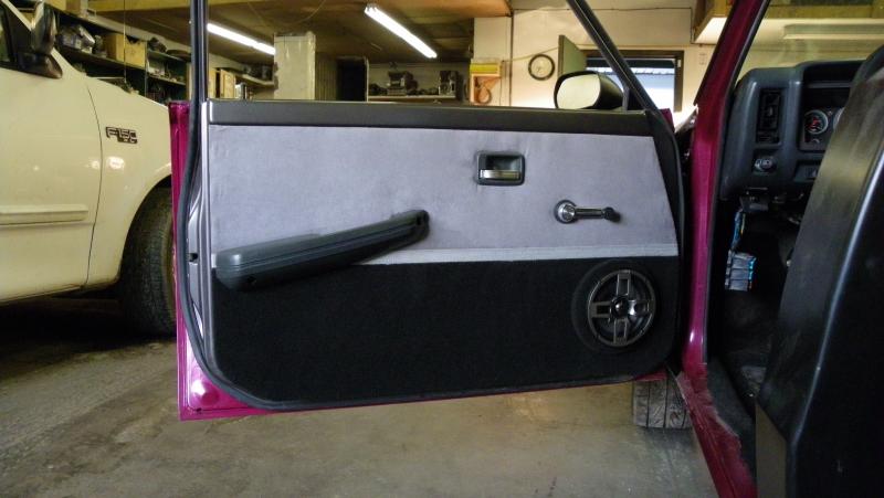

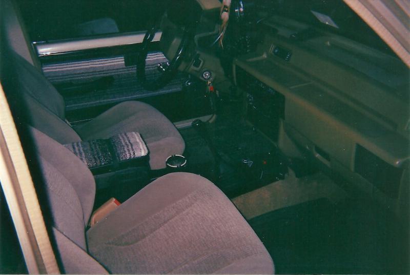

    Here's my attempt at a replacement door card on my L200 -
    I used plastic 'scrivets' to secure the door card as it was an easier option to work with. (sorry about my image sizes, they are blocking out the sun lololol - got no idea how to resize them...)
    1,249
    That's a nice, clean look. The scrivets were a good choice for the overall affect. And a chrome door handle! I can't find those, here. (Window cranks are much easier to replace with chrome ones).
    The oversized picture is exactly the problem I had with my digital camera - hence my using cumbersome film-and-developing. This next digital camera I get I'll be sure to pay attention to downsize options and settings when it gets hooked up to the computer.
    6,052
    The chrome handles were a mod I needed to make as the L200 door handles are notorious for snapping off - and it's always the drivers' side door that gets it. So I procured the door handles from my Colt hatch and modified the mechanisms. It required drilling and filing out holes to install the nylon threaded lugs and shortening the mechanism rods and bending them to lock into the backs of the donor assemblies. Then I had to redesign the door cards to suit the new handles and buckets. The Colt handles are really robust and easy to source. When I do the other door I'll take a few pics of the handle mod (it is relatively straightforward to perform but take a bit of time to file the holes out square).
