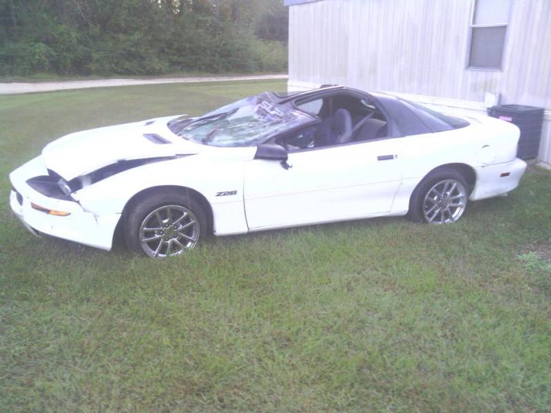

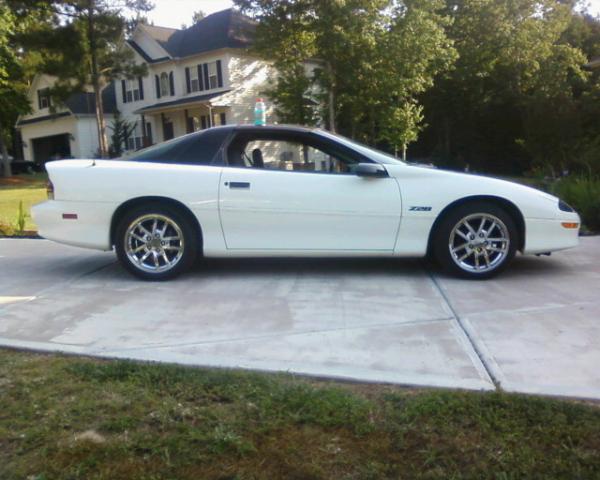

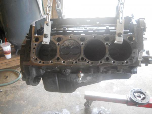

    This was my baby, first bought the car back in 2011.

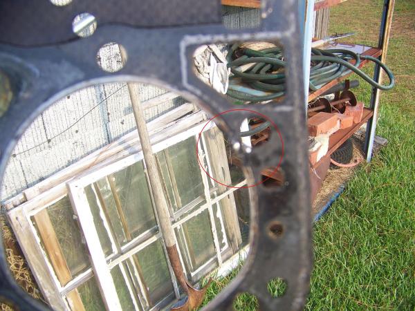

    Blew the head gasket on the way home from purchase.

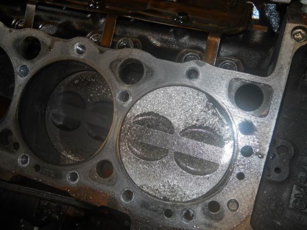

    Reassembled drove it a month on crossed wire this happened ((DETONATION))

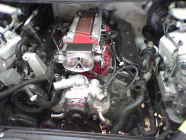

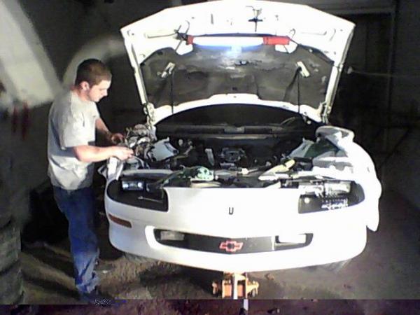

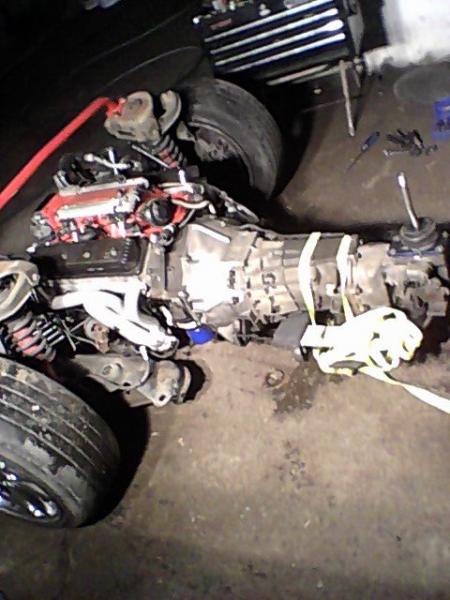

    NOW IT'S ON! MOTOR OUT! The bottom
    Comp cc306
    Comp 7.200" hardend push rods/guides
    Comp Beehives/retainers
    Comp roller lifters
    scorpion 1.6" roller rockers
    speedpro hyperutectic .030 pistons
    machine balanced crank
    port polished heads/intake
    BBK TB
    ARP BOLTS. head/intake/rocker studs/mains/flywheel/connecting rods
    pace setter full length headers/ORY/SLP LM2
    POS! 300$ RAM clutch
    LT4 knock module
    STARTUP NO TUNE 2012'
    http://www.youtube.com/watch?feature...NkE-uc2yk0#t=7
    3 pints of E&J
