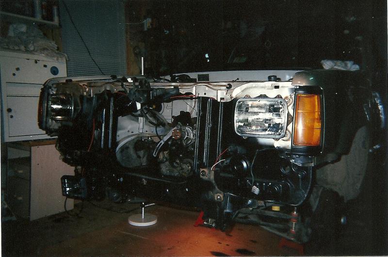

    I don't have that under-bumper skirt on my truck, but if you DO, you'll be fighting it every time you want to get under the engine. You might want to take it off. These are all opportunities to clean and detail parts...maybe paint the bumper, behind the grille and perhaps the radiator tank.
    If you're replacing the oil pump, then your truck has lots of grease and oil on it: take the time to clean this off before you start, and you'll keep the job from getting gunked up. HERE is one idea for de-greasing the engine. If weather permits you to use a high-pressure car wash spray, it's a good investment.

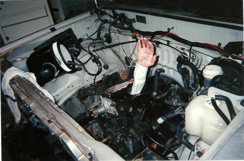

    Again, many opportunities are available: the radiator out means you can turn it upside-down and back-flush it with the garden hose or shower hand-held sprayer. Spray the cooling fins from the engine-side of the radiator, to push out the dirt and bugs from years of trips to the 7~11. When it goes back into your truck, it will now give you better service…all for a few moments of attention.
    And before starting out, be sure a good space is cleared for storing the parts you’ll be removing. Removing a part amidst clutter, and trying to find a place to put it results in a frustrating job. If you take the time before you start, you eliminate 90% of the frustration naturally built-in to haphazard mechanical tasks. If your work area is neat from the start, it sets the pace for a successful repair. In my home-improvement work, I always clean up before and after each phase of a project. I do the same for mechanical repairs. It provides clarity, locates missing tools, and gets rid of empty containers that get kicked around. Take out the trash. Eliminate distraction and confusion. Take out used shop rags. You have a 4-hour repair ahead of you that might take days to complete because you can only work on it 20 minutes a day: make your work space accommodating to a job well done. Clean up after each session, or resolve to start the next session with a clean up and tool re-organizing. You’ll have continuity to the task, and you’ll always know where you left off.

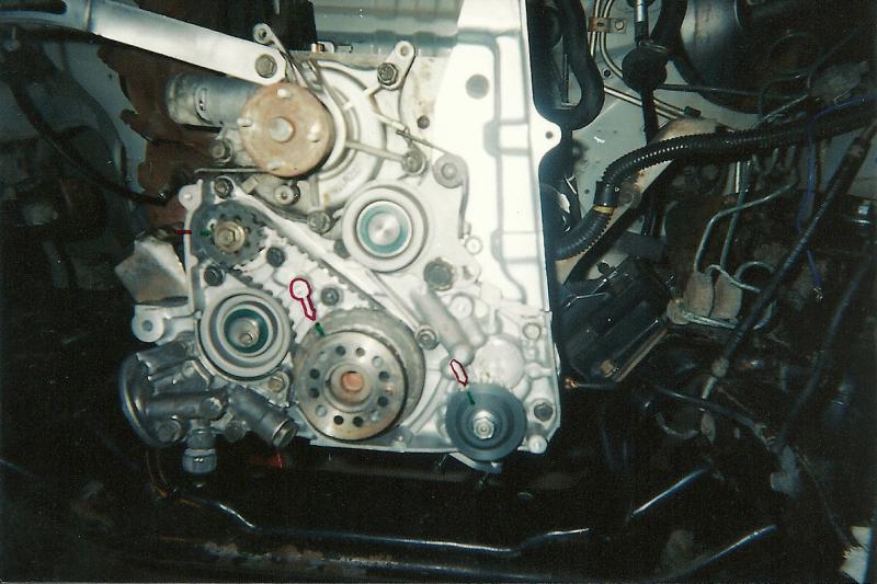

    Now it is time to make sure the #1 piston is top-dead-center, and that your timing marks are all aligned. Take the distributor cap off, noting (by the book or the marks you’ve placed on the distributor) where #1 firing position is. It should be just past the bottom cap clip. I marked mine so it’s a no-brainer, and is now second-nature to me. But only because I practiced sure-footed learning.
    Use the center bolt to turn the engine to where #1 is at TDC. You can put the bottom timing cover back on, then the crank pulley, but there are timing marks on the timing belt pulleys and oil gear to show you where the timing marks are. Before we go any further, let’s highlight a problem that occurs all the time: the timing mark for the cam gear. It is a little bump on the cylinder head, and NOT THE TOP OF THE HEAD. This distinction is the difference of being off one tooth, and that difference is huge.
    You can mark that little bump with a drop of paint or marking pen. The main thing is to know it's your primary timing mark for the cam.
    1,271
    There are clear illustrations in your manual as to where the timing marks are. Don’t worry about the oil gear mark: you’re replacing the pump and will be re-setting it. Once you are sure of the TDC position, remove the timing belt.

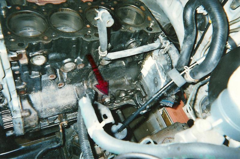

    Here comes another crucial point that is missing from my manual: the nut that holds the mysterious Silent Shaft. And the conspiring bolt that protects the Cave of Ali Bubba…he’s the redneck version of the Arabic story. Facing the engine, there is a bolt on the right-hand side, back there near the starter. This bolt is how you access the Silent Shaft secret society.
    Remove the bolt, and try to get a phillips screwdriver into that hole. Dinner and drinks might work, with a few personal complements thrown in, but since the timing belt is off, it’s perfectly okay to turn the oil pump gear and get that shaft to turn. Get a feel for it: regardless of your heterosexual inclinations, you’ll be handling The Shaft a bit more during this operation. It’s okay: everybody does it, but no one talks about it. That's one reason it’s CALLED a Silent Shaft, based on secret society principles.
    Place that bolt in the cardboard holder in that designated single spot.
    Turn the shaft until the screwdriver goes all the way in, and when you turn the oil pump gear back and forth, you can feel it bump against the screwdriver. Leave the screwdriver in there, for now.

    NIT-PICKY DETAIL: Trim any gasket material from the oil pump gasket that might be hanging down along the oil pan surface of the block. I used a single-edge razor blade to insure that the block bottom and oil pump bottom had a smooth transition, keeping the oil pan facing nice and flat all the way way around.
    After coating the engine block side of oil pan gasket with silicone sealer, smear it real good with your finger; the inside-the-pan-side of the bolt holes is the most important: we want to keep oil in the pan. Sealing the outer edges only allows oil to possibly seep up and down the bolts. Be careful not to block bolt holes...that can haunt you later.
    The photo below shows the important area to coat with sealer highlighted in orange.
    Reinstall the oil pan, getting a bolt on one of the corners to hold it. (Hold the pan in place so it doesn't sag or drop down from that one bolt). That frees your hand up to get another bolt in, to hold an opposite corner. Get the rest of the bolts in place, all of them finger tight. Work the bolts from the center, outward, in increments of ¼ turns until tight, then torque to specifications. (In all honesty, after tightening all the bolts equally with 1/4 turns, I just tightened mine good n' snug, but not too hard). Make sure you put the drain plug back in.

    In the photo below, engine block timing marks are highlighted in red, and pulley/gear marks are in green.
