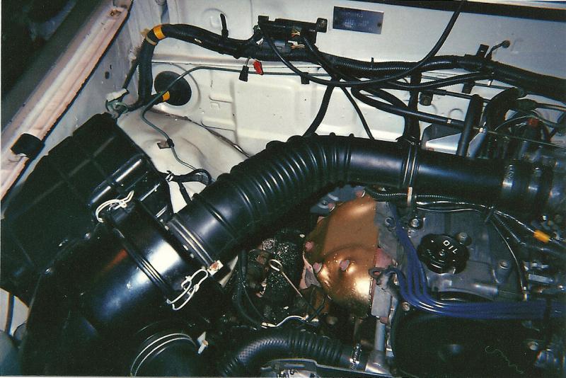

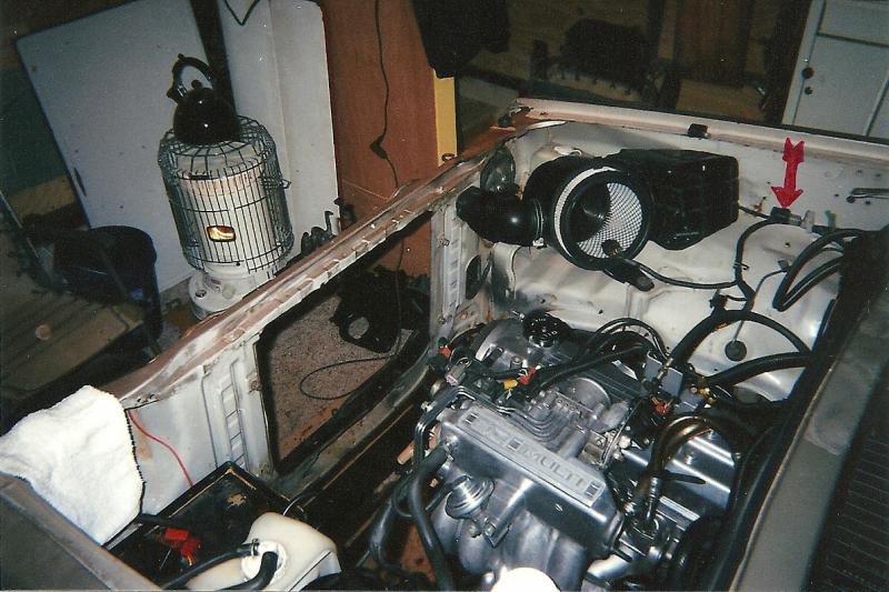

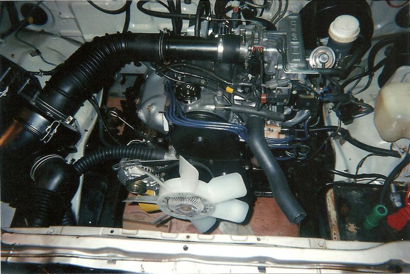

    Many's the time I needed to look at a photo to see what placement was proper. I offer the following photos of my own 4G64, absolutely stock and all components are in their proper places.
    The only contention is the placement of the ignition wires: in these photos they go over the radiator hose. I have since opted to place them under the hose, to minimize subjecting them to heat.
    Identification Tag on Firewall [v] (top of photo under red v) - Tells you your engine number (i.e. 4G64) and original paint code
    General Engine Layout

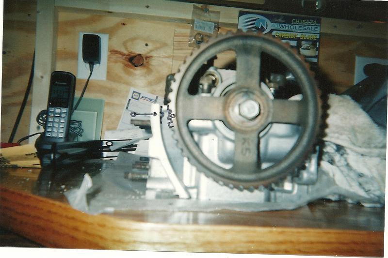

    Timing Mark On Cylinder Head
    Engine Layout
    Arrow points to Silent Shaft Access Bolt
    Oil Pump-Side Silent Shaft Access Cap [photo by Camoit]

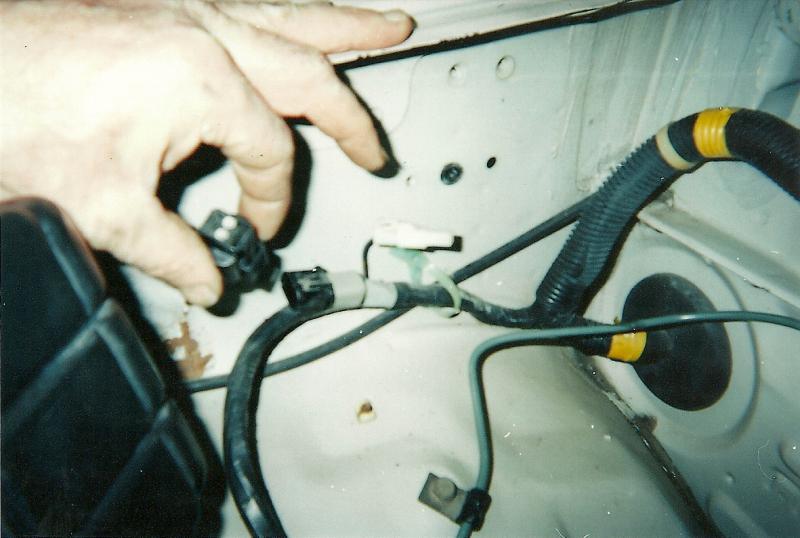

    Ignition Timing Jumper Connector Location
