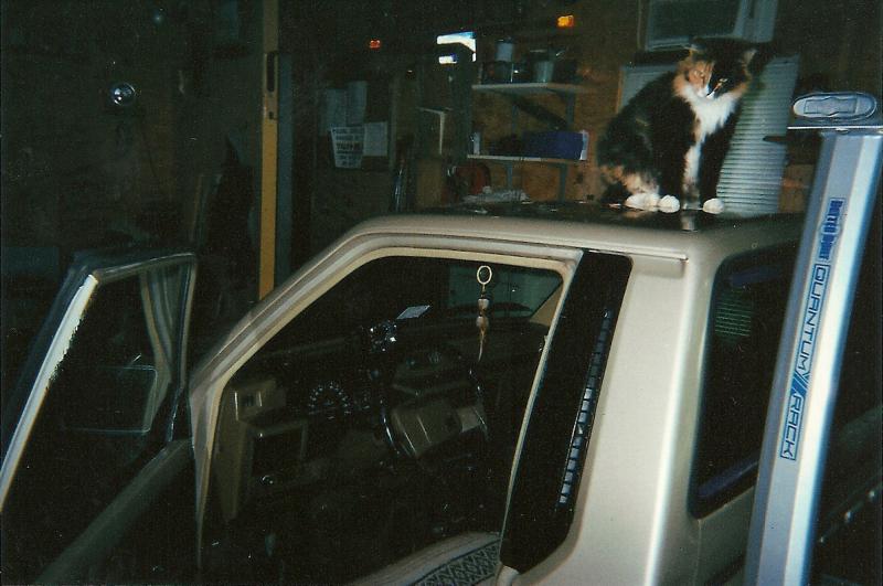

    Armrest
    The jury is still out about the material on the headrests: it's just there with saftey pins, for now.
    The little box I got at Mal*Wart for $6. I hacked it up and modified it to fit so passenger-access to the seatbelt base was easy. The black device on the board is dash light illumination.
    Behind The Seat Storage
    I installed some hooks to hold bungie cords. I have a flat Craftsman tool set that has a restraint and cover behind the driver's seat. Note the crank for the spare tire: it is mounted on a typical broom catch. A tire inflator is Velcroed to the carpeting.
