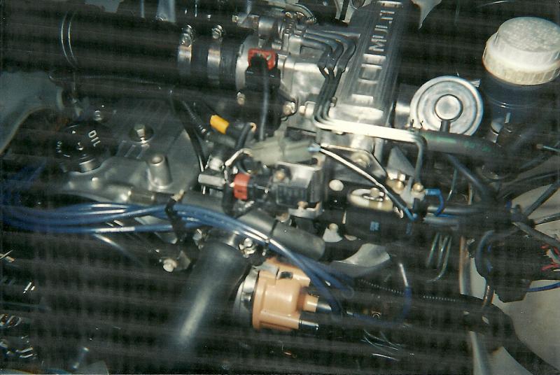

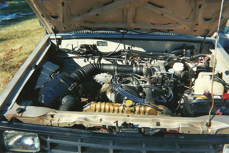

  1. #151
    1,273
    Rack Of Ram with Holiday Sauce
    Pony, in service, with the ladder rack I found
