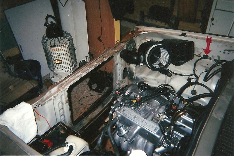

    Could somone take the time to walk me through the process of locating the ignition timing adjustment connector, and how to use it? The only connector I see is connected to the 02 sensor...then there are two on the firewall that I'm certain are for a tachometer. The area the manual indicates it should be points to the o2 sensor connection on the wheel well.
    I understand the importance of this procedure, but I am not sure how to carry it out. I'm avoiding driving the truck until the timing is right. I keep searching this forum but it's difficult to find specific threads, and the search feature isn't helping much.
    This is the only photo I have that shows the connection I see, it joins with the o2 sensor (red arrow).
    EDIT: That is indeed the right location. Below, I hold the cap to the connector, just near the connector itself.

    I have a few other posts, just they're not counted in the general section. I have many different Mitsubishis, but was more active on the original forum mightyd50. I see one guy here who copies my posts/information from other sites as if they were his own lol... so I'm sort of here still.
    The connector is a one wire plug, not connected to anything. Its fairly big, the same size and shape of the alternator plug.
    Use an alligator paper or paper clip to create a good connection to the pin inside, then ground to the intake manifold or block.
    I've always set the wheels straight ahead as possible, as per the factory service manuals. The reason is to remove any strain on the engine from the power steering pump so you can determine the correct idle speed. Same goes for any lights/heater/electrical equipment, so the alternator isn't under a load.
    Then engine must be at full operating temperature, and there must be no vacuum leaks (check your vacuum lines).
    Base timing is 5BTDC on older 4g64's as far as my experiences go.
    Marking the crank pulley timing mark with a paint marker, or white will make it easier to see.
    Its good that your dizzy is in the middle of it's adjustment range, that means you have the cam timing correct.

    Its probably near the firewall, close to where the harness branches off to the intake manifold.

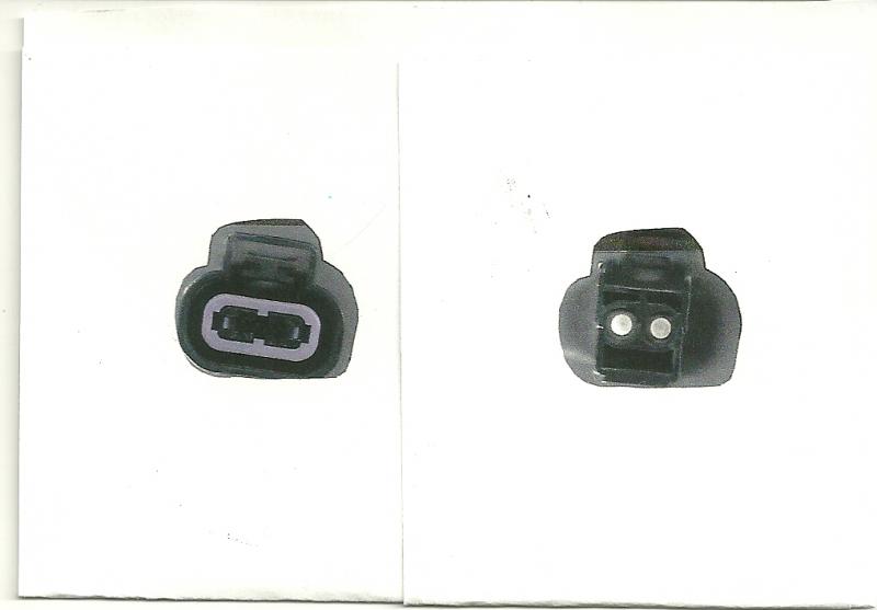

    From your description, and the one in the manual that says "remove the waterproof cover of...", I think I located it. It IS where the photo with the arrow indicates, but it's wrapped tightly with some other wiring.
    This is actually a photo-copy of the cover I took off (I don't have a digital camera) and there IS only one prong inside the connector. The cover has definite seals inside it for water protection.

    One wire terminated to just a cover, that's gotta be it. Verify by checking the timing with and without it grounded.

    I was indeed pointing right at it.
    Someone taped those wires together pretty tight (it isn't a factory detail). The fender had been replaced at one time, so maybe it was done then.
