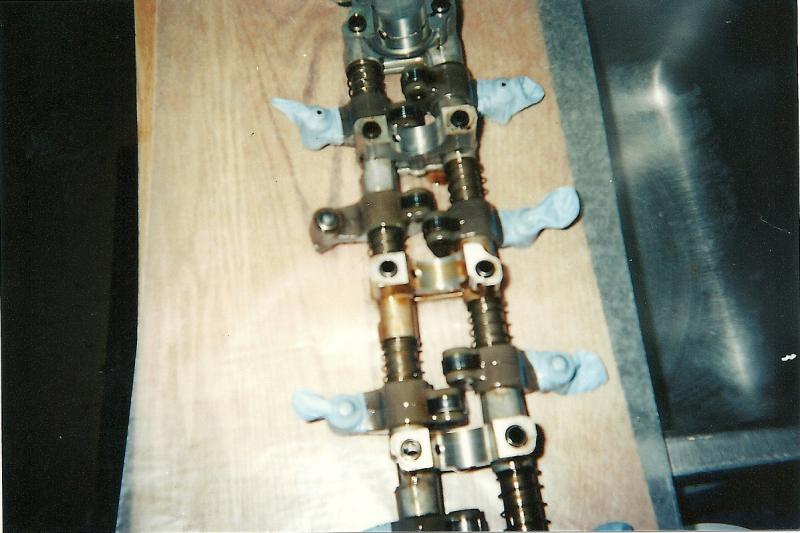

    Once I had the valve cover off, I slipped a piece of paper under #1 intake, which had a lot of play in it. Then I whacked the rockerarm with my hand. This left an imprint on the paper, which showed a circle with a hole in the center. So I knew that lifter was upside down. One was all it took: no need to check the others, the whole thing had to come off.
    The glove fingers worked terrific for holding the lifters onto the rockerarms.
    ROCKER ARM ASSEMBLY REMOVAL NOTE: Starting in the middle of the assembly, loosen the bolts 1/4 turn, moving outward to each bearing cap in a clockwise pattern. Take several cycles of 1/4 turns to allow the valve pressure to ease up equally: this is so the shafts don't bend excessively during the removal process. Once all the bolts are loose enough to remove by finger-turning, take them out and place them on a cardboard holder with the pattern of their placement. Re-installing them, take care to tighten, again, with 1/4 turns until tight enough to torque to specification.
    I loosened the timing belt tension and indeed, the rocker assembly came out with only slight rising of the cam shaft. I had taken the precaution of removing the distributor, just in case...avoiding any possible broken gear teeth. I weighted the firewall side down until I could get a spare bearing to hold it down. I also noticed, while the timing cover was off, somehow the oil pump timing mark was off. I corrected it, but I tell ya, having that radiator off made a world of difference the first time around. I didn't have that luxury this time.
    Both lifters on #1 were upside down, the rest were fine. (Photo enhanced to show lifters)

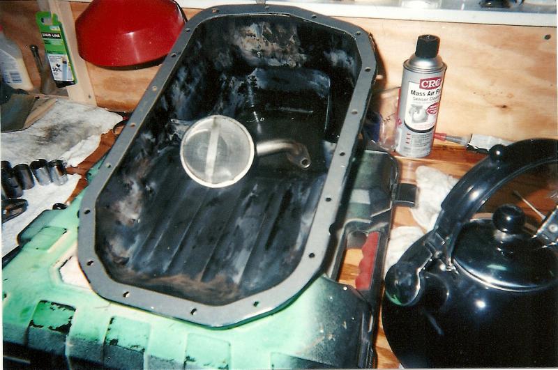

    The oil sump and pan, clean...oil sump installed

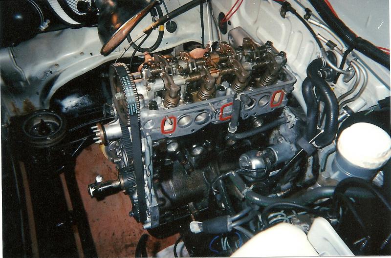

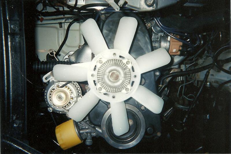

    Putting it all together
    So odd to see the truck like this.
    But it's all back together and ready for the road.
    This project is finished.

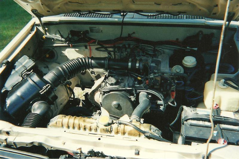

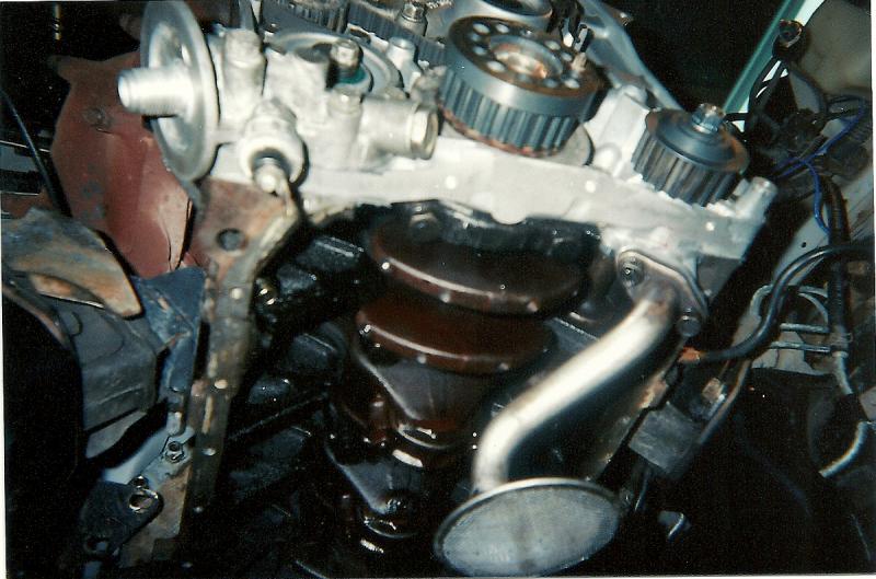

    The day I took the picture on the left, I knew nothing about that engine. I know quite a bit, now.
