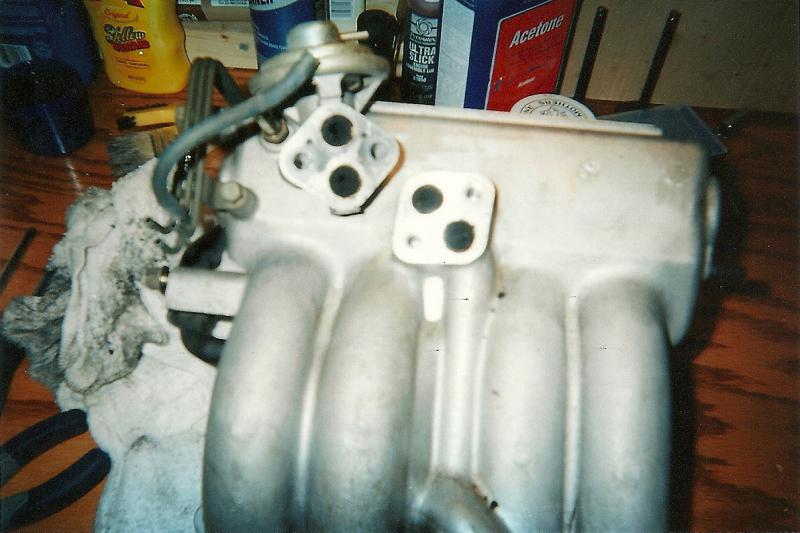

    Case In Point: there is a labrynth passage for the EGR valve. This is a little hole you'll see in the intake manifold, and it is likely filled with carbon. By seperating the plenium from the manifold, you see this passage is pretty well blocked up there, too. But when you take the EGR valve off, you can see this is a total of 4 square inches of carbon yuck that disables the EGR to do its job properly. It takes some doing to get that carbon out of the whole passage way AND the EGR valve. The "EG" in that stands for "Exhaust Gas" and it has...wonder-of-wonders...carbon. After 217,037 miles, it has more than just carbon crammed in there. It likely has a good amount of
    and where they stashed the rest of that guy is anyone's guess, but we HAVE discovered a good quantity of him in our various engine components.
    The EGR affects (among other things) idle and acceleration, and the valve can't detect the vacuum/pressure with all that Jimmy Hoffa particulate in there. The EGR valve channels vaccum to other components when the valve opens. If it can't open...and it has no vacuum to channel...the other components can't operate properly.
    So by having the courage and resolve to clean everything up...not for show, but for good operating function...yes: you have to get into the manifold and clean things up. This is the lesson I learned, and I assure you it is charactor building. Being a Minimalist yeilds minimal (or even negative) results. Going the full distance likely translates your TRUCK will give YOU "the full distance" when the temperature guage says "normal", the CD player is thumping sweet and you're passing Yugos with a happy heart.
    I started out hoping for a "quick-and-dirty" repair. I found, in true honesty, the repair has to be done with attention and care in order for the whole of the project to be satisfying. Yes: it will take more time, but it will also eliminate many problems that would crop up later. I don't WANT my D-50 parked on jack stands all the time. Once you get your little truck thoroughly serviced, then you are free to play with it. But to just slap a band-aid on the valve cover is not what these trucks want, and they won't let you get away with that.

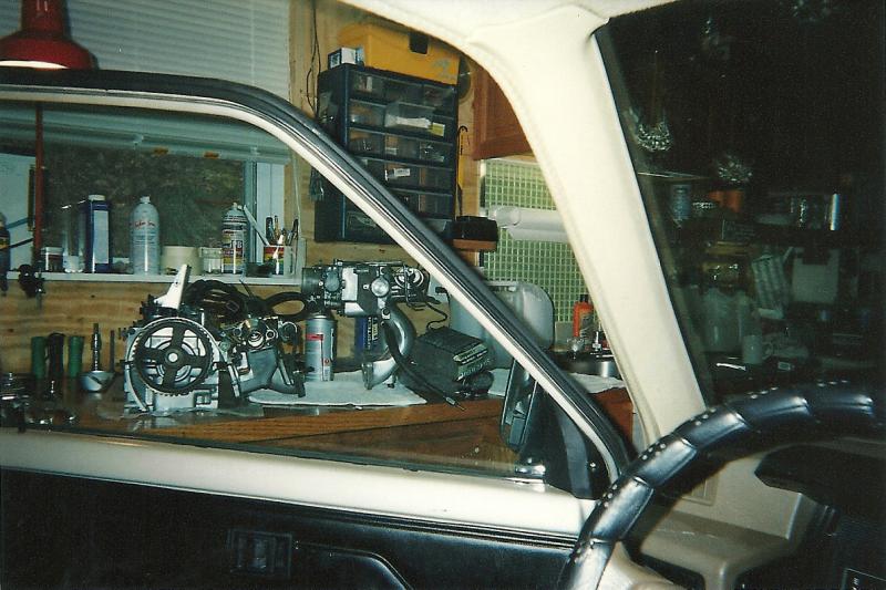

    The parts truck outside the garage. This little guy has been so valuable for what I learned from dismantling it. It also was helpful in referring to some placements..."When in doubt, look at the other one."

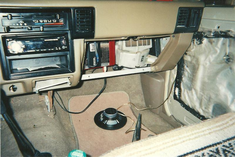

    When I went to install my pre-amp, I found brackets already there to bolt into. I have since learned that this was for hanging the optional air conditioning unit. I can say, in all honesty, I have a well-hung pre-amp.
