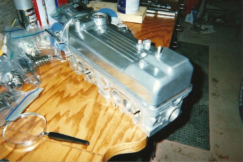

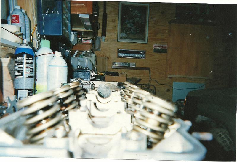

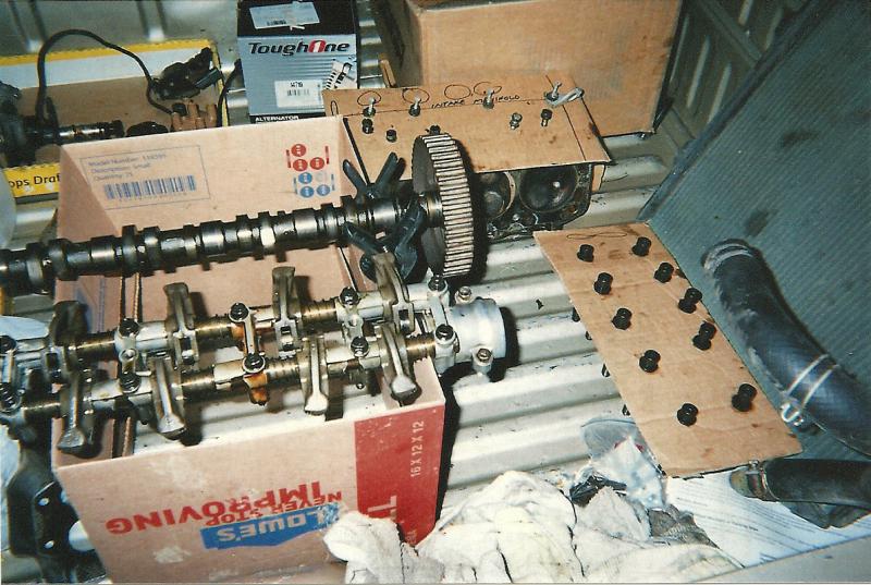

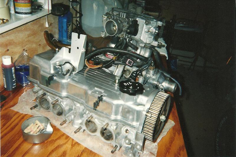

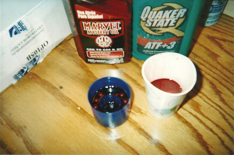

    Thanks! Those freezing nights I polished on it when I felt like it, in 1/2 hour stints. There was a point I just said "Enough is enough!"
    EYE CANDY Why YES, I DO!
    BELOW: A rear-engine truck? Naw: VW and Corvair did that already.

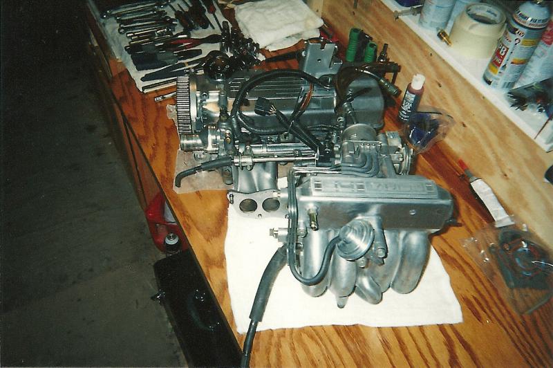

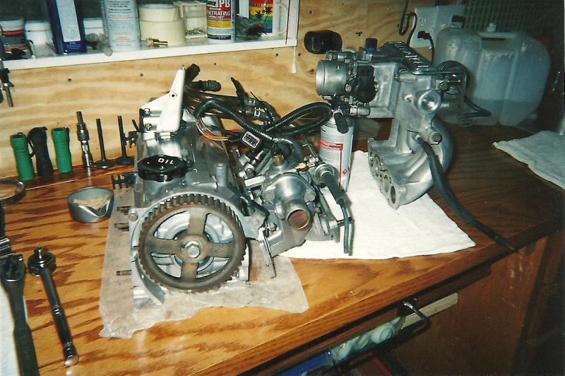

    Thought this was a cool shot. Note position of the (pre-surgery) valve seal on the left, and the one on the right: do ya reckon that caused a bit of an oil problem? (photo below)
    Implements that get me through the night - [not shown: inflatable Julia Child doll with optional attachments]:

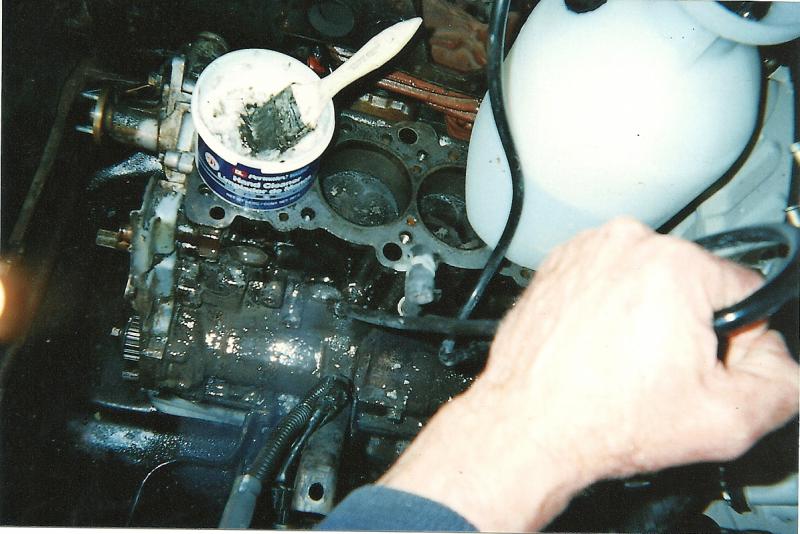

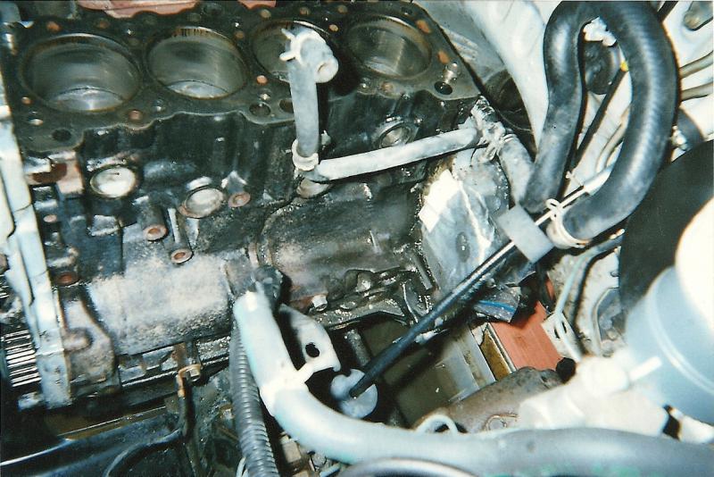

    Cleaning the block with hand cleaner then rinsing, and afterwards. Note catch-pan below engine area:
    How it came together, this morning:
    How I keep it together. (Cylinder head seen is from the 2.0)...
    And soaking the new hydrolic lifters in a 50/50 solution of Mystery Oil and Trans fluid (by recommendation)

    In replacing the gear, since the oil pan is off, I can reach up through the engine and jam the shaft...(does all this talk make anyone else horny? There sure are a lot of male-arousing words going on...) in a similar way to the right side. The right side shaft has a bona-fide bolt you remove to access the shaft. That bolt is just aft of the starter motor, about the same height.
    Speaking of that right-hand side shaft: know that you can remove that plate in front of the hidden bolt, remove the bolt, and the silent shaft will remain in the block. (See photo provided by camoit). The right-hand shaft has only one bearing: the left side has two.
    I have opted to set gaskets with silicone gasket sealer on the oil pan, oil pump plate, the sump connection and the oil filter holder before installing them. Allowed to cure sufficient time means I won't be fussing with gaskets falling off as I try to install stuff. I made use of the drying time to clean surfaces and some detail cleaning in the engine bay.
    Once the oil pump is re-installed, and the oil pan replaced, it's time to put the silent shaft belt on, and assure the timing of the engine.

    It is then a big moment in my pathetic life: installing the cylinder head, cam and rockerarm assembly. I am going to agonize every millimeter of the way to make sure the timing is as perfect as I can get it.

    Getting My Head Together
    I've been threatening to do that for many years. There was always some voice that assured me continuing to be stupid was beneficial.
    What a great day in my obscure and occassionally abstract life: the cylinder head goes on! I'm in no hurry to start the engine up, so I'm not pushing myself to have it running by tonight. I'm taking my time.
    But the repair has a really good feel to it, and having taken the time to clean the engine compartment was not only satisfying, it made putting the oil pan back on less messy. I was able to reach through the cross brace without soaking my arm in grease. Though I have no running water in the garage, I DO have a yard sprayer that I fill with hot tap water from the house, and I keep a kettle on the kerosene stove...you never know when Julia Child's ghost might show up and want tea...
    ...and boiling hot water is great for cleaning parts or spiking the temperature of the sprayer water.
    Since I have that nice big plastic drip pan (they sell them with rollers...supposedly for storing things under your bed, which is BAD Feng Shui) I decided it was a good time to clean the A-frames and front wheel components: my next task is to rebuild the brakes, and working with clean parts helps tremendously. Getting the truck to move forward comes before concerns about getting it to stop.
    A note about service prep: I removed the wheels and the front bumper for this repair. It was worth the few minutes to take them off, as it makes access so much easier. I was able to sit on a box in front of the engine, and read it bed-time stories and chat about current events. With a little sippy~cup, I was able to give the truck hot chocolate and Mai Tai's with little umberellas. We even played a few games of Scrabble, and I let Pony win, because spelling is not a strong point of Mitsubishi engines.
    In the scheme of my D-50 story, I had stopped driving the truck because the passenger-side caliper was locking up. I didn't want to stress the drive train or engine, so I had it parked until I could locate brake parts. While waiting, I would start it up occassionally. Starting it up one very cold day the timing belt stripped. Though the truck hasn't moved but some 500 feet in the past month, it has taken me on one of the most meaningful journeys of my life.
    And once it's purring happily, no doubt it will help me on my journey to get my head together.
