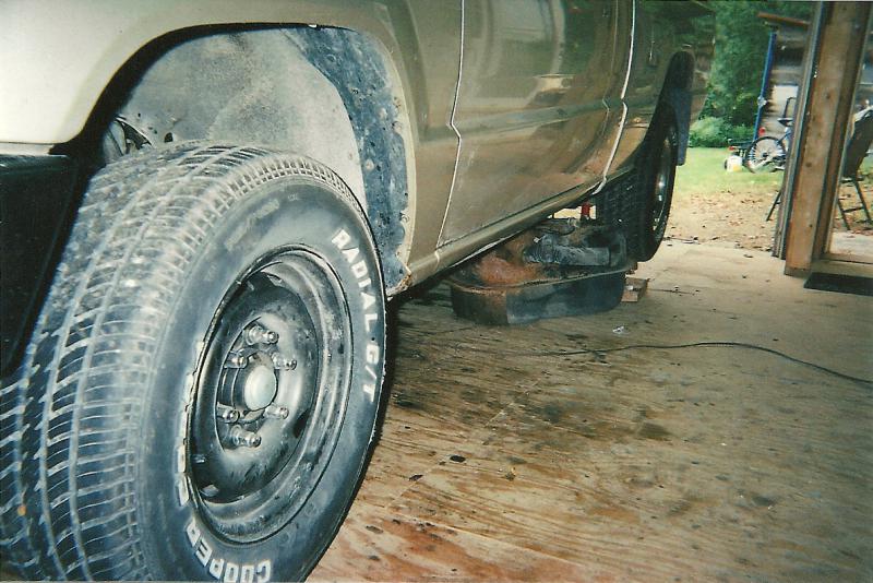

  18. #43
    1,269

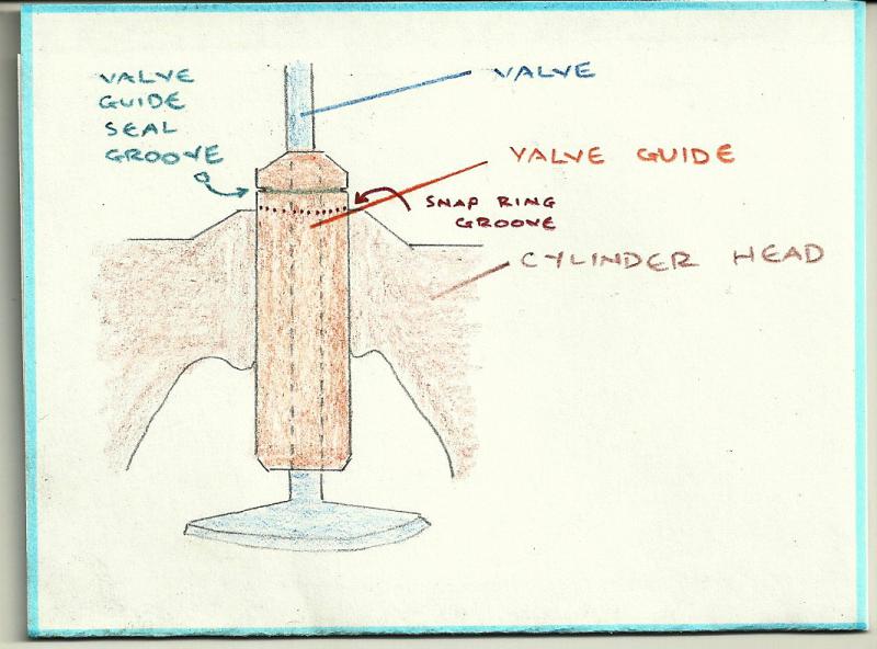

  21. #46
    1,269
    When the time comes for a head rebuild, I'd be prone to cut grooves in the valve guides before replacing the assembly. Mark, the machinist, said that the snap rings were hard to come by, any more. Like so many things on these trucks, we have to resort to what's available.
    I drew a picture to show how the valve guides fit, and where a groove-and-snap-ring would do the most good. Mark says that without the snap rings, the repair lasts only one year: the problem returns.
    More than being worried about The Beave, I'm suspicious of that Eddie Haskell. I've heard rumors about him.

    Here's a video I found that helps to understand the process. (Another video explained what to listen for regarding the sound of when the seal is properly seated).
    http://www.youtube.com/watch?v=OVMbFA8cy-E
    I noted the importance of making sure the seals are well lubricated.
    For the experts, this simple task is second-nature. For those who have never been through the process, it's baffling.
    The videos show a few specialised tools, the Chilton book uses everyday available tools...like using a deep socket to tap the seal into place. I did not like the minor damage this did to the seal top, so I'll locate some tubing to match the hard surface top of the seal: mine are metal-jacket for exhaust, 'rubber' for intake.
    The confusion about the "o" rings was cleared up by BradMph's valve seals 101 post: knowing the difference in "umbrella" type seals and "positive" helps me to comprehend the task in front of me. I do not have "umbrella" seals in the 2.4 .
    Without any feedback about installation, I went ahead and installed one seal WITH an "o" ring...not knowing better. Consequently, I destroyed the seal...more so when I removed it. I learn as I make mistakes. Sharing those mistakes is beneficial to others, so here you are.
    I want to take the time, again, to thank BradMph for providing information useful to keeping these engines in good order
    In looking at the parts catalogues, I found each set of replacement seals comes with a plastic installation sleeve, that fits over the valve stem. This is great for protecting the seal as it is lowered into place, and the sleeve slides off easily after the seal is finger-pressure tight on the stem. What confused me about the head gasket set the seals came with is now obvious: the set is designed to accomodate several engine types. A small plastic sleeve was provided for the jet valves in the 2.0 engine. Not having jet valves, I do not need the sleeve.
    FOR THOSE WITH THE 2.0 JET VALVES:
    A racing mechanic told me that the jet valves can be removed and the holes welded shut. The jet valves are more trouble than they're worth. I expect forum experts to correct me if I'm wrong on details such as this, or validate their positive usefulness.
    Beginners, such as myself, need to get over a couple psychological blockages: we cling to the book in regards to ordering parts: yes, ours' is a Dodge D-50, but Mitsubishi originally manufactured the vehicles and their engines. It's okay to order Mitsubishi parts instead of looking for D-50parts...in some cases, a better choice is getting the Mighty Max equivelent of D-50 replacements. Funny little glitch, but one I'm sure many have encountered.

  25. #50
    1,269
    What led me to think the o-rings belonged in there was looking inside the old seals. It appeared they had o-rings. But when a cotton swab was used to clean the inner surface of the old seal, I realised I was seeing oil, not rubber. I then understood that plastic provides the actual seal between the valve stem and flow of oil.
    A magnifying glass is extremely usedful in your tool collection...especially if you're getting up on years. Oh no: I'm...I'm...
