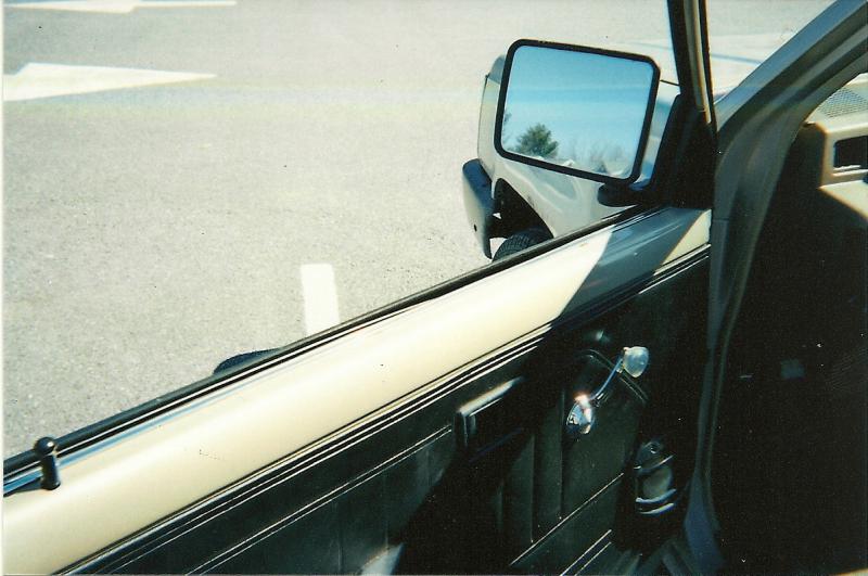

    I like the top 2 inches of plastic naugahyde removed from the door panels, revealing the painted metal. But there are clamps on a strip of metal to stretch the plastic and attach to the top of the door. That strip has holes to fit in. I agonized about how to trim that out.
    I had a couple ideas, and one was to use plastic chrome stripping with self-adhesive backing. I didn't want to go that route, but finally got desparate to do SOMETHING. Turns out, it works okay. We'll see how summer heat affects the trim pieces. For now, the adhesive is holding good.

    The plastic-chrome strips on the doors have held up well, even in the summer heat. It was a great solution to an annoying problem. (For those who don't know: I modified the door panels, cutting off the top 2" of naugahyde, which exposes the door's painted metal underneith, nearest the window. Square holes were visible where the top of the panels attached near the window. These self-adhesive chrome strips covered them up perfectly).
