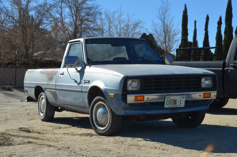

    I just picked up a D50 for $400 bucks. It starts and runs but has a bad knock. I am thinking of doing a swap right after Christmas and will be documenting the entire thing.
    My question is what type of swap should I do?
    I was going to go with a Chevy small block, but after adding up all the parts I would need it isn't worth it.
    Should I rebuild my current motor? G54B? I am looking for more power maybe even go turbo. My buddy has a full operational shop where I can do all my fab work and do the swap fairly easy. Would really like to become a sleeper over time so being able to do upgrades afterwards is always a plus.
    Please give me some input on what you would do or would like to see done.
    * I have attached a few photos that I took with my iPhone. I will be doing full shoots with it once we get started.

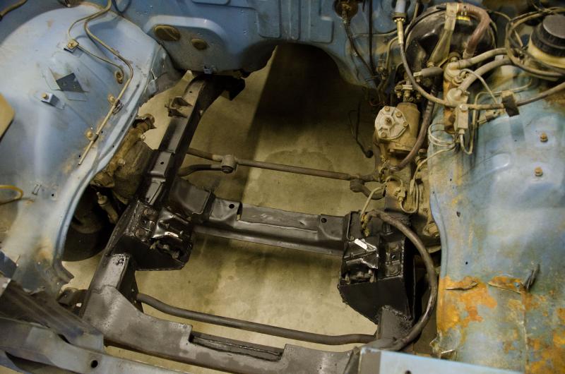

    After taking a look at what I got myself into, I ended up pulling the old motor out and found a great deal on Craigslist.
    We headed down to Bakersfield Christmas Eve to pick it up for $400 after talking with the owner. Once we got back to our shop with it, we discovered it was actually a Turbo 400 Trans, not a 350! He even threw in an extra small block to the deal and we closed the deal at $400. The next day with some minor troubleshooting, we were able to get it to start within 10 minutes it was a great feeling.
    We started with a check list of things we would have to do,
    (New Battery 700+ CCA, Air Cleaner / Housing, Throttle Cable, Radiator Hoses, Hose Clamps, Thermostat, Alter the Drivershaft, Radiator Fans, Custom Shifter, Gauges, Idler Arm & Steering bushing, New Tires - What do you recommend? , Oil Fuel Plug, Throttle Cable, New Spark Plugs, Exhaust shit, Engine Mounts, Trans mount, Gaskets, 3/8'' Fuel Line, Lock Rear end)
    The list seemed to get longer and longer as we went on lol. But so far I paid $400 for the truck, $400 for the used small block and turbo 400 Trans. I was able to pull the stock motor our and get $250 for it locally. So I'm not that deep into it yet. ($550)
    Trying to fit the new 350 was a hassle. We didn't have enough clearance and ended up having to cut out some of the front just to get it in. We did it with no care as we started this project as something to do over winter break. I also found a guy on this forum named Mike, (818) 268-3012 who is the go to man for any D50 parts you may need. I picked up a brand new set of OEM tail lights and after meeting with him I will definitely be giving him a call if I need anything else.
    DSC_0822.jpgDSC_0834.jpgDSC_0845.jpgDSC_0850.jpgDSC_0851.jpgDSC_0855.jpgDSC_0862.jpgDSC_0863.jpgDSC_0865.jpgDSC_0870.jpgDSC_0873.jpgDSC_0882.jpgDSC_0896.jpgDSC_0900.jpgDSC_0903.jpgDSC_0905.jpg
    Once we had the motor in we had clearance issues all over. There was no room to mount the radiator up front, so we thought about running it back to the truck bed, but I really didn't want to go that route. We decided to hold off until summer and hit the firewall in so we can set it up how it is suppose to be. Any recommendations would be helpful again, this is a learning process for us so feel free to say whatever you like. We enjoy hearing peoples feedback positive or negative.
    We still want to lock the rear, figure out the shifter, run new fuel line 3/8'', figure out exhaust, tires and driveshaft!
    I have video of the whole process once we finish this project over the summer we will post it on Youtube for you guys to check it out.
    We were trying to think of a cool name to call it since its now a Chevy, Mitsubishi, Dodge but we used the words "FOR NOW" often and think that is the perfect name for this project.
    Rad is easy.just have one made like I did using a 4 core forklift center and custom tanks. Set the rad under the header between the grill and the rad support. strange that you had to cut the top of the rad header as I didn't need to with the 302 and the SBC's are shorter then the SBF's. I did have to cut the tranny tunnel opening back about 3" then move it up 2" to clear the AOD's bell housing. Driveshaft again an easy fix, just shorten the front and weld a chevy yoke into it, if it a 2 piece only the front needs to be shortened and rebalanced. Name maybe Mitsulet as I have the Fordubishi Tranny cross member again easy 3"x 1/2" flat bar lined up with the factory frame holes and a piece welded to line up the TH400's mount. There should be pic's of some of what I'm talking about in my build post. hope this helps it's looking good so far, keep it up.
