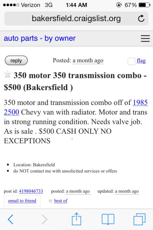

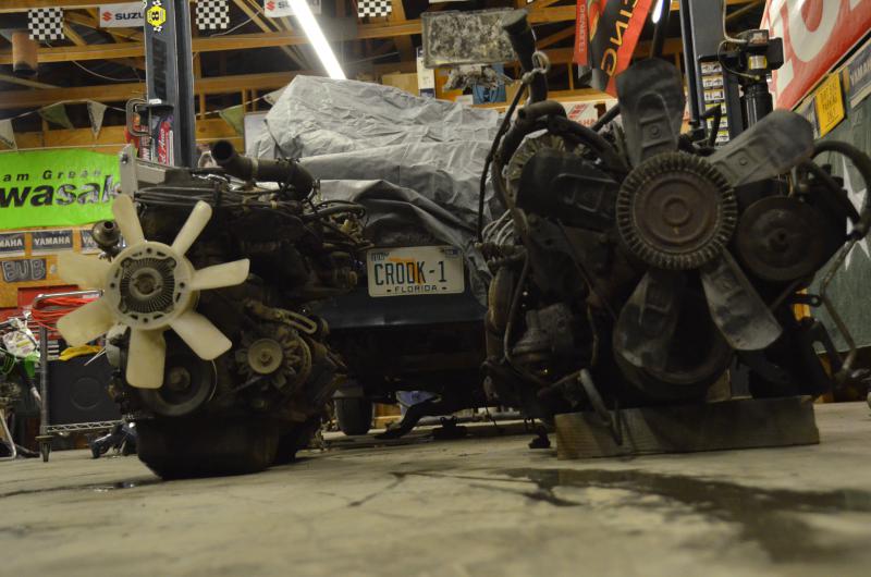

I just picked up a D50 for $400 bucks. It starts and runs but has a bad knock. I am thinking of doing a swap right after Christmas and will be documenting the entire thing.
My question is what type of swap should I do?
I was going to go with a Chevy small block, but after adding up all the parts I would need it isn't worth it.
Should I rebuild my current motor? G54B? I am looking for more power maybe even go turbo. My buddy has a full operational shop where I can do all my fab work and do the swap fairly easy. Would really like to become a sleeper over time so being able to do upgrades afterwards is always a plus.

Tranny cross member again easy 3"x 1/2" flat bar lined up with the factory frame holes and a piece welded to line up the TH400's mount. There should be pic's of some of what I'm talking about in my build post. hope this helps it's looking good so far, keep it up.
