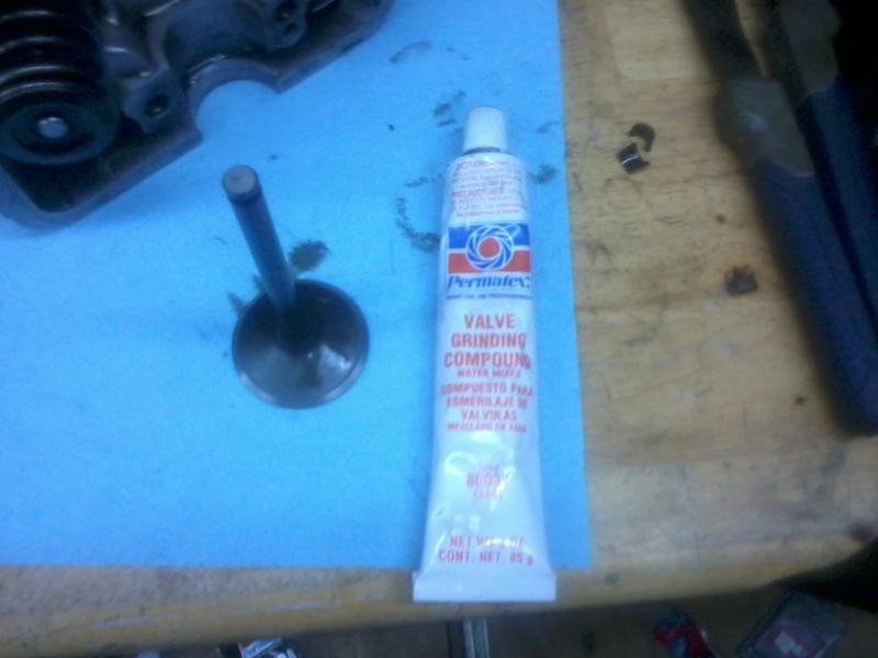

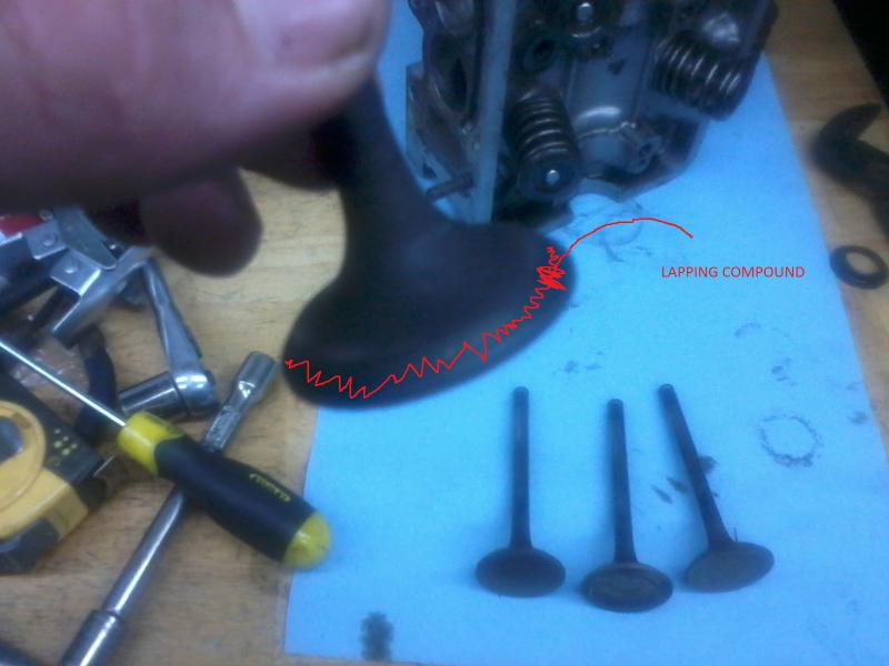

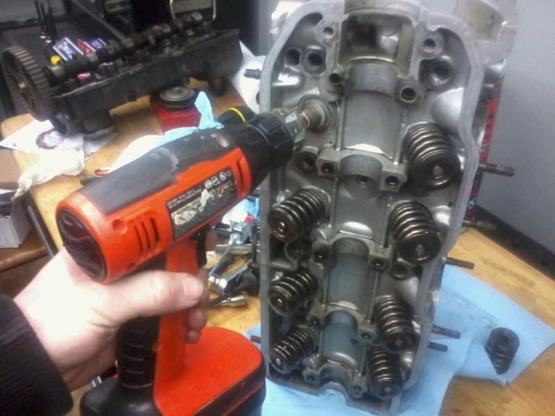

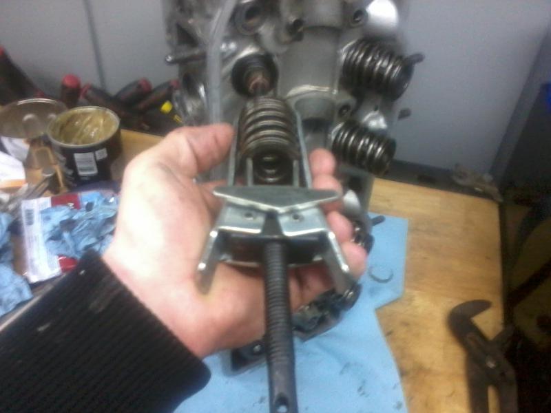

    I had the same problem with my 94 the owner ran it hot and coolant blew back through the radiator. My case was a warped head was able to salvage it with mill work. Take your head off don't mix up the head bolts, remove the rocker arm assembly don't mix bolts, remove valve clips/springs/retainers DO NOT THESE MIX UP you can rent a spring compressor form a auto parts store. I would pressure wash the head get all the carbon, burnt oil off scrape the old gasket off with razor. Examine for cracks, their most commonly found between the in. ex. valves. After that find a good straight edge the length of the head make sure you have no gasket material left on the surface lay on the head I/X/- like so, get a feeler gauge and if 0.05 mm (.0020 in.) will not clear under the straight edge there is no need to mill head your good to go. Repeat the same procedure on the deck of the block as well. To lap the valves get some valve grinding compound dab some on the face of the valve. slide valve back in head get a cordless drill lock it on the stem and slowly lap the valve, after all are done clean up the mess. Replace all your valve stem seals with this tool #MD998729 if not you will damage them. I prefer u change all the lifters also.
