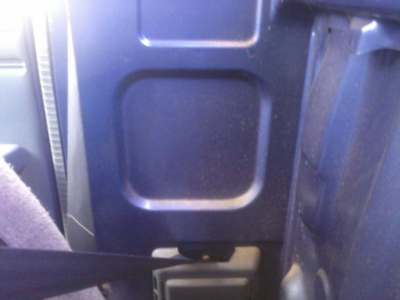

    Speakers should come with a template. I would try to stick with a basic size speaker incase you ever have to replace one or both and have a strange size hole to recut for replacement speakers. Also get some insulation to fill in the post area behind the speaker. Probably will help the sound not be so hollow. I also am not sure if your seatbelts on that year will bang your speakers after time. Something to think about.

    Your right they do come with a cutout template on box face palm! Installing pioneer ts-g1644r 250w/40w (rms) They require 5" cutout for flush mount, and they do include covers to protect from the wind whipping seatbelt buckle. I had speakers in the door of my 93' and had problems with the wire getting cut in the door jam. Removed them and had a big ugly hole there. Bought 6.5" foam "boom mat" baffles for mid bass so I shouldn't need to pack insulation, but we'll see...
