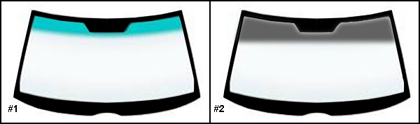

    The 2 ways that most people apply tint on front windshields is as follows. There is the curved way shown in fig.1 and the way I like best, the straight across bottom way in fig.2.
    Fig.1 is applied by wetting the outside of the window and apply your tint to the outside. Take a razor blade and being careful not to cut yourself or scratch the window, cut the tint right on the window how you would like it. Be sure you place it correctly with the adhesive side up. This way you will reverse it to fit inside your window. Use lots and lots of water with about a few drops of dish soap to help make it adjustable to the window.
    This way is also the hardest way to get it to look right on the windshield. It takes time to scoot it around and the curve in windshield can cause issues with ripples in the material as you install it.
    Fig.2 is the way I like best and it looks better too. You would place it on windows just like shown above, but instead of curving the bottom so it follows the curve of the top of the window, just run the tint straight across the window level. This way you can use the one straight edged side of the tint and then just cut the top to match the very upper part of the window. This way also hides your cut marks at the top of the window incase your cutting is not perfectly done. This way is faster and looks much more sportier. Looks at some IMSA race cars and you will see this is their favorite way as well. It gives you more tint drop in the corners where it is needed since these areas seem to be the bright sun nuisance we all fight with.
