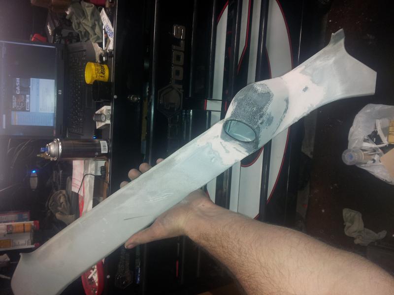

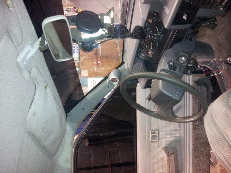

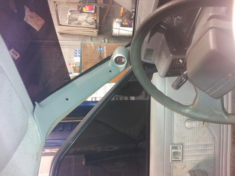

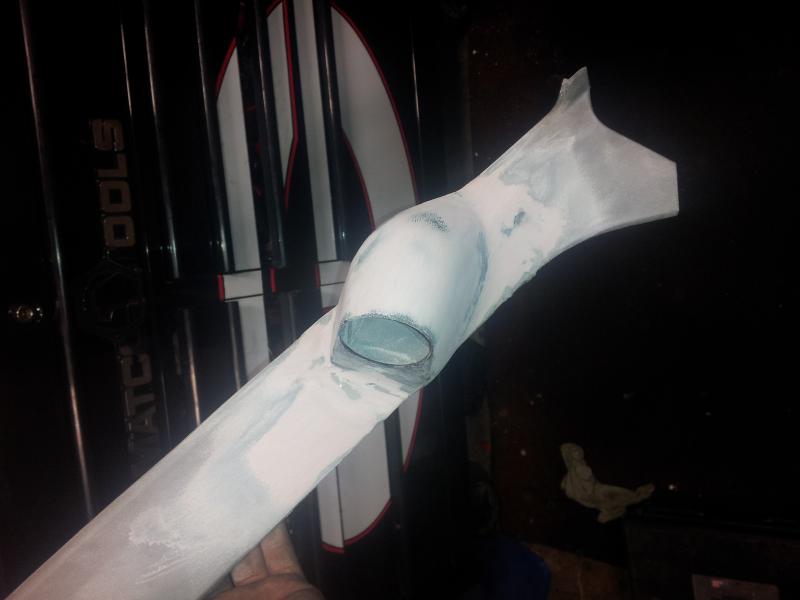

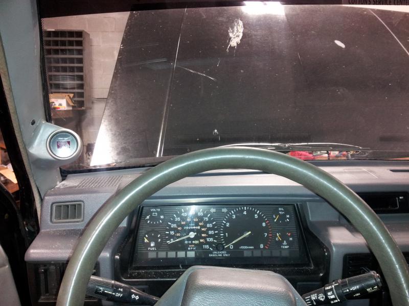

    since i could not find one after market that would work with these trucks, i made one for mine.
    20131117_174128.jpg20131117_174146.jpg20131121_221033.jpg20131121_223633.jpg20131122_222659.jpg20131122_222712.jpg20131122_222740.jpg20131122_222803.jpg
    the pod it self i bought from advance auto, it was a cheap universal that i cut and modified to fit and be angled right to the driver seat, then i screwed it the pillar and started to glue it. then once the glue set up, i pulled the screws out and grinded the edges smooth, then bondo it, roughed it in with 80 grit, and then 300 grit, then final with 1500 grit. Then i picked up some interior plastic paint to match the original color.

    lol i wish i could, it would be cool to make a mold of it to make fiberglass ones. i dunno if that would work tho.... thanks for the compliments

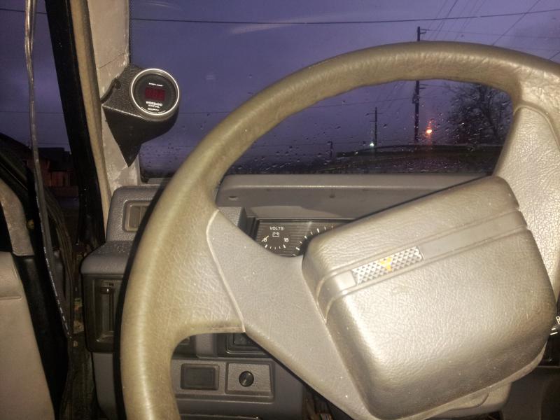

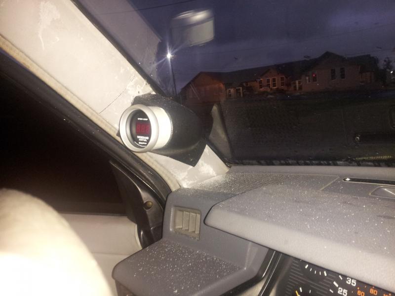

    Looks good, what gauge is it your running there.
    09-11-2013
    38
    Ringgold ga
    autometer wide band a/f ratio gauge
