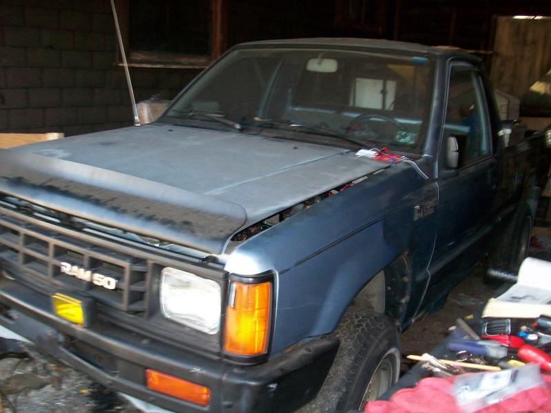

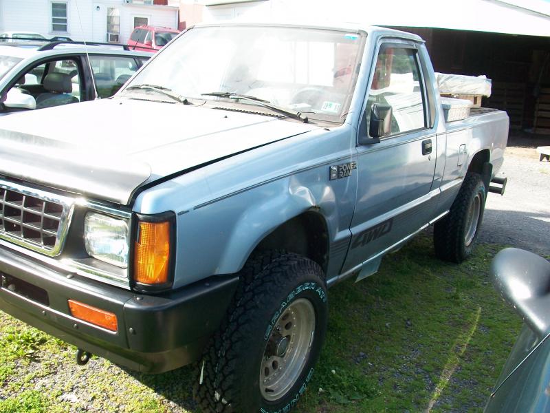

    Since I am no mechanic (or at least wasn't 2 years ago), this is has been a learning experience. Most of the initial work that I did was more cosmetic. However as the years went by I went deeper into the engine to fix more and more issues as they arose.

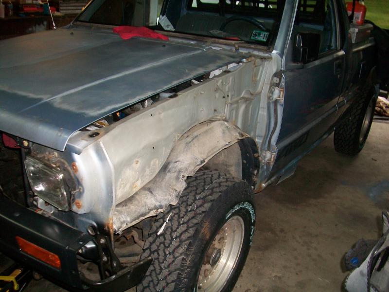

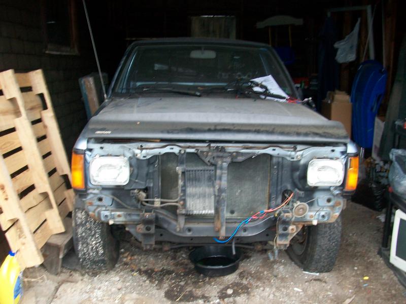

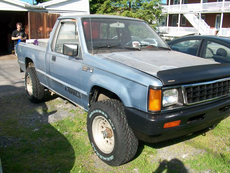

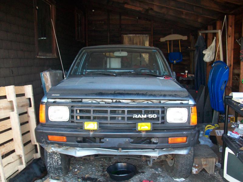

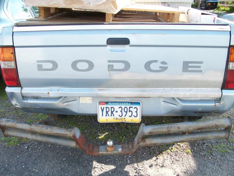

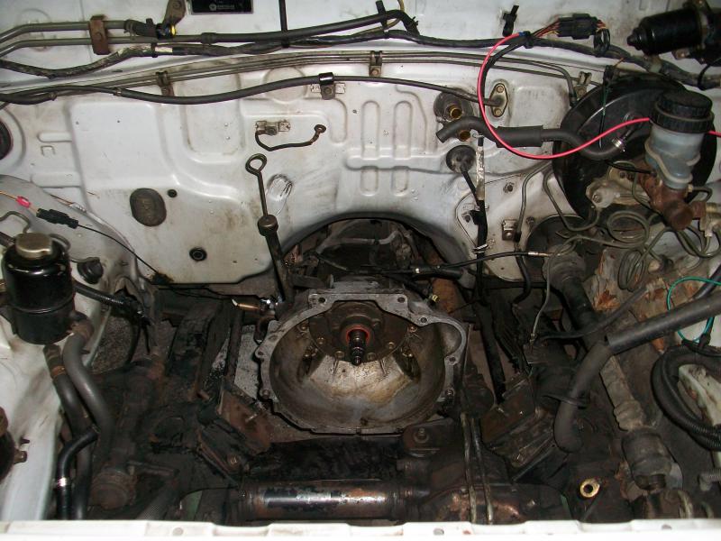

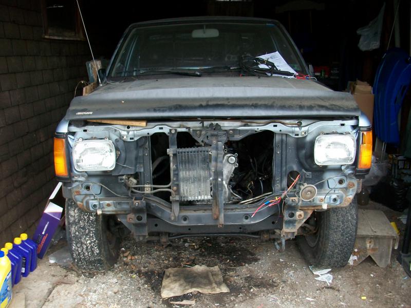

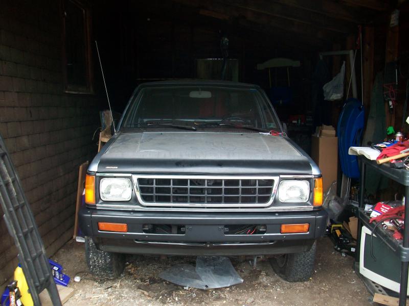

    First set of images are from the first year, in a rented tiny garage. This is the way Ol' Dirty Blue looked when she first came to me.

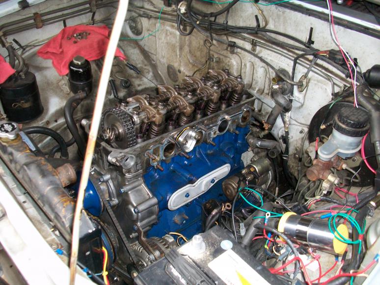

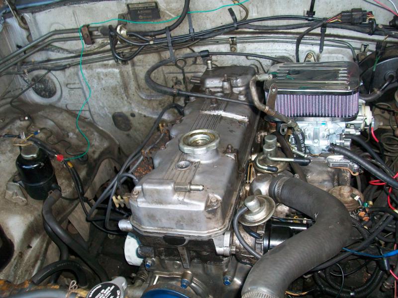

    After adjusting some timing issues, she still wasn't running right. So I elected to remove the Mikuni Carb since calibrating these can be tricky and opted for the Weber 32/36 DFEV conversion.
    Now that she was able to start up and run; though she smoked abit (burning oil). I decided to hold off on tackling the leaks in favor of more cosmetic changes.

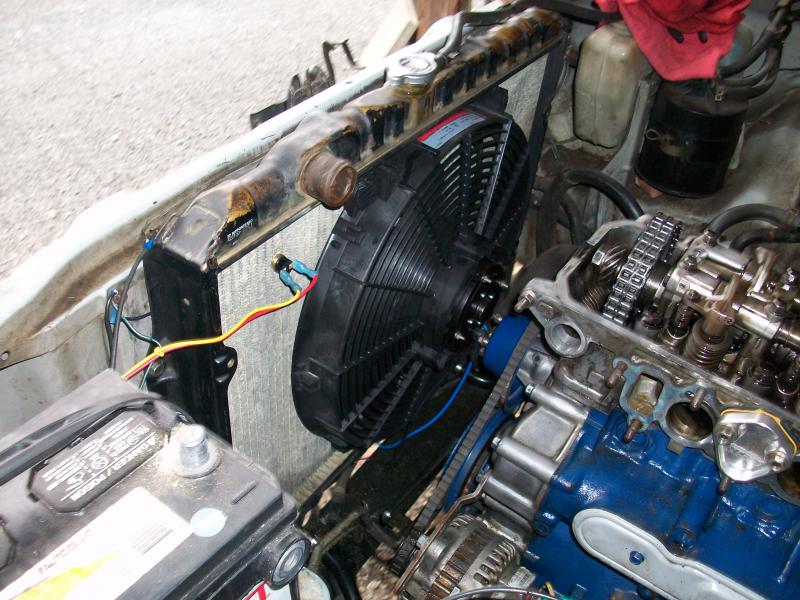

    Then came the gasket replacements and fan upgrade.
    Then she was almost ready to roll, though she still smoked abit. But she was still sitting on flat old tires...so new tires were ordered and she rolled out of the garage. Unfortunately, no test drive that day because she really didn't have much power. Plus getting in her in the sun allowed me to see the damage that years of road salt and sitting had done to the frame.

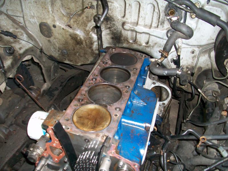

    Then we moved and I started sharing our neighbor's garage to really dig into the oil leak more aggressively. So first the head came off.

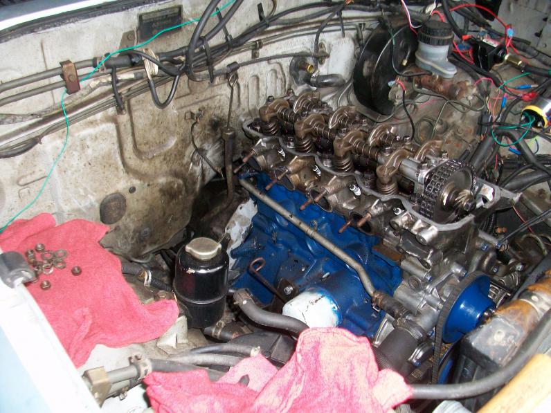

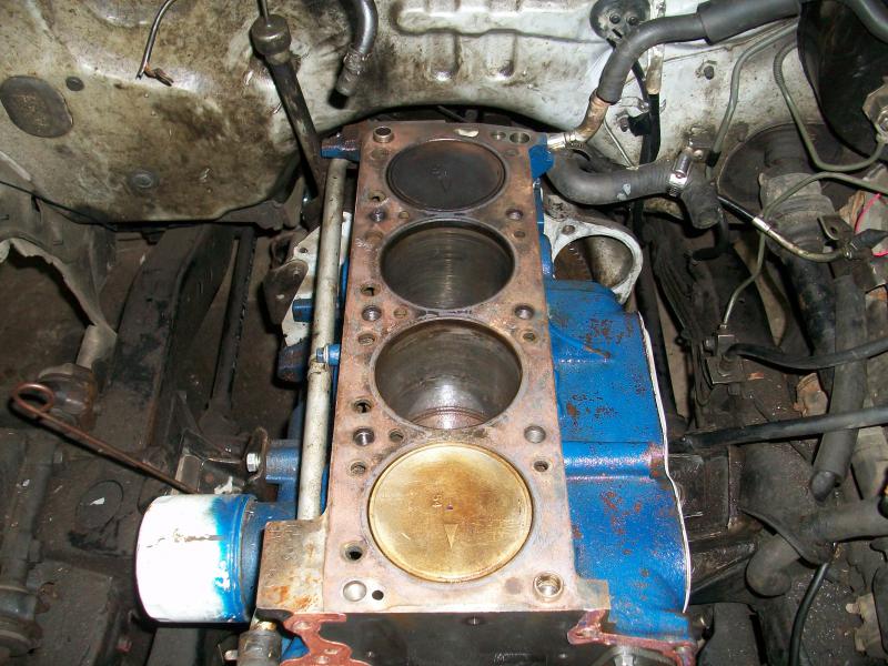

    Then as I waited for additional parts; valve lash adjusters, new valves (one exhaust valve was found to be bent), and more gaskets. I decided to clean under the hood and work on replacing the fenders.

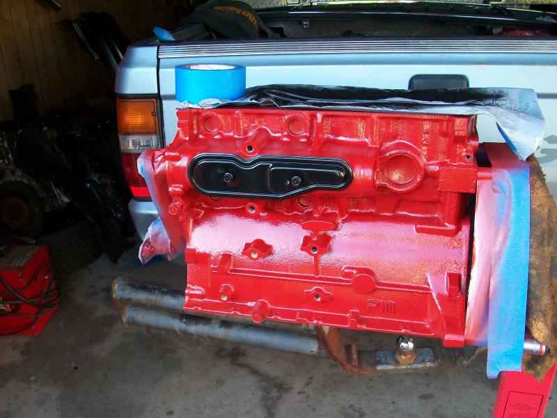

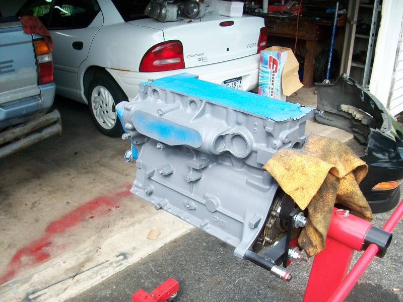

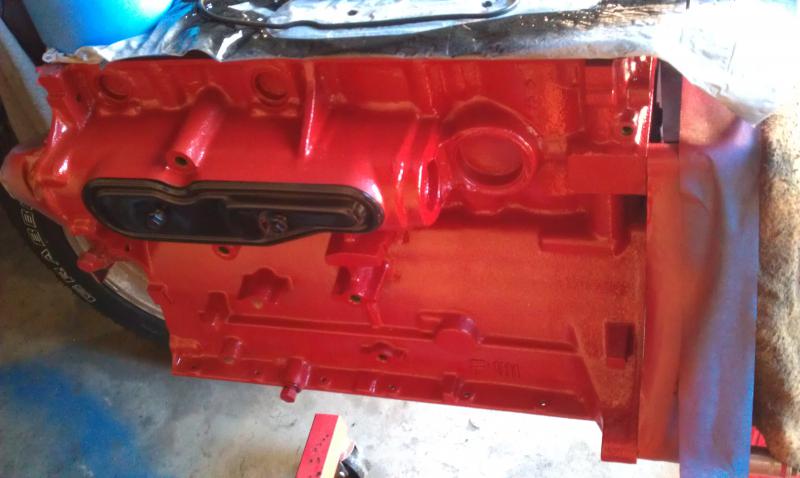

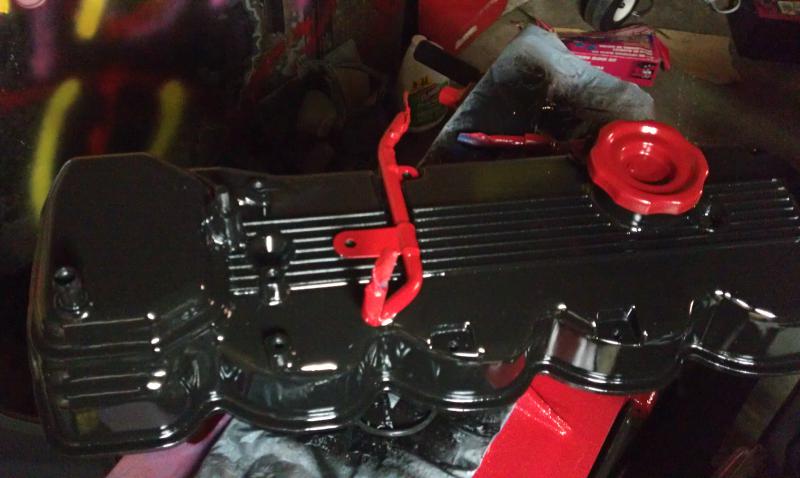

    Then, with the help of my more mechanically inclined neighbor, I decided to pull the motor and replace the rod bearings, re-ring the pistons, and lightly hone the cylinders. But figured, while it's out let's paint it up.
    05-02-2011
    75
    Waynesboro, PA
    1987 Dodge Power Ram 50

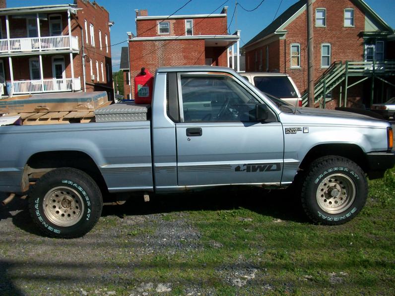

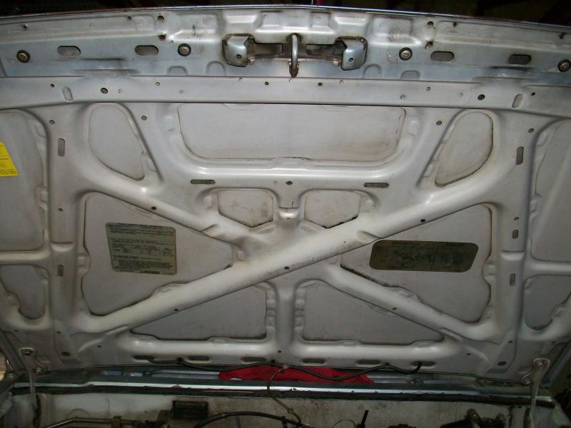

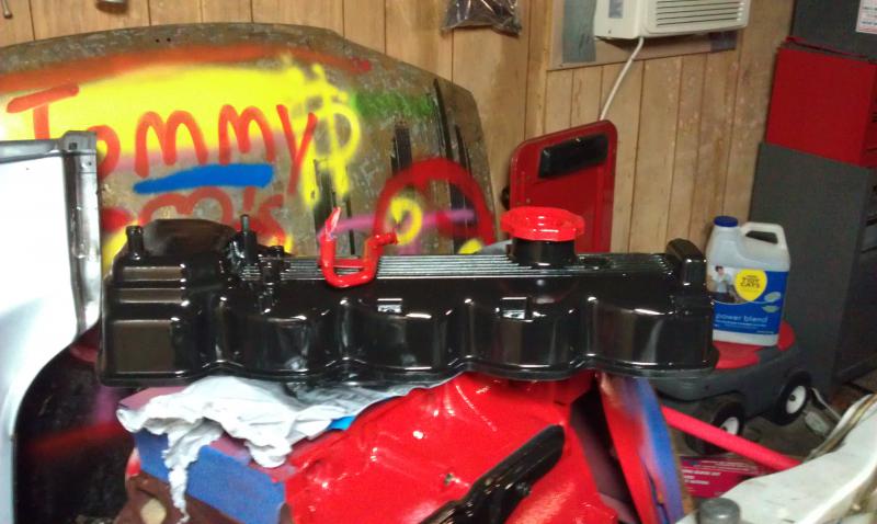

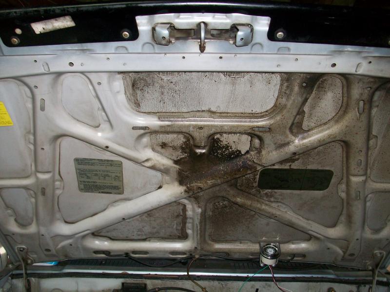

    After a good paint job (IMO), everything went back in and was tested. Less smoke and she started to really come to life. She still ran a little rich so had to tweak the carb a bit.

    The truck has basically been used as a farm truck for the last year, because of complications with getting the title / registration in my name. The most recent work being done now, is focusing on the rust removal from the back half of the frame. The pictures are little tight on the frame, because my space surrounding the truck is a bit small.

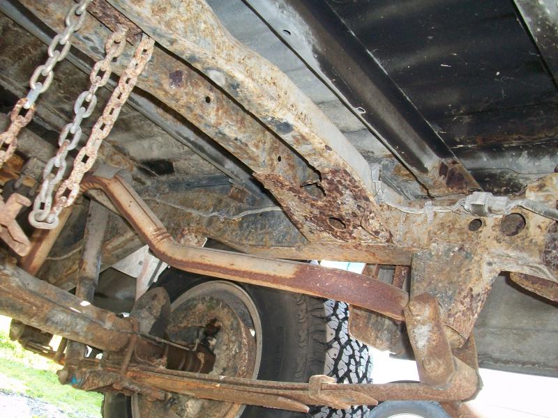

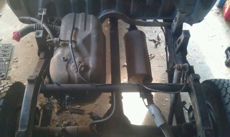

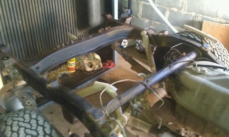

    So as I wait for the temperature to heat up so I can treat the frame rust, I decided this might be a good time to plan the install of the Carter P4070 fuel pump. Ideally, I'd like this pump mounted close to the tank (similar to Mopar_ja's Setup), but with the Gen2 it appears that the main fuel line hose is routed between the two frame brackets for the bed.
    So I guess the choices are remove and rerun the fuel and brake lines routed along the frame to accommodate the pump to be mounted in front of the tank on the inside edge of the frame. Or, determine if there is a way to use some creative engineering to mount the pump in between the bed supports and still have the fuel tank hose routed above the pump (body lift maybe). Any thoughts?

    Wow, Ol' Blue sure is inspiring! How much trouble was it to take the bed off? That is certainly the way to tackle that rust, and mine is just as bad. I want to arrest the rust, and also get some reinforcement welded on. If removing the bed isn't traumatic, that is certainly the way I'd like to go.
    I have no ideas to offer regarding the fuel pump placement. It's frikken' TIGHT in that area. My '90 has fuel injection, the pump is inside the tank, and the repair I had to make didn't allow for much fudging room. On my '89 parts truck, the fuel pump is right on the intake manifold, running off the cam.
    The repair to my tank involved doing something to connect the rusted metal outlet and return pipes to the fuel line...a leak brought my attention to the problem. In dropping the tank, I saw the lines were rusted and 'sweating". My first repair actually caused the pipes to break off. Broken off with only 1/4" stubs to work with, I used that PL S10 concrete caulk to adhere fuel line. When the caulking cured, I put hose clamps on. I also surrounded the area with Bondo, sort of like putting a cast on a broken arm. The repair was a success, but it made me keep my eye open for a replacement tank.

    The bed was easy removal, however if you plan on doing itself, I'd rig a pulley system; I did a make-shift attempt with ratchet straps. It worked until it was time to lower the bed . There are four bolts in the front of the bed, four in the back, and then just disconnect the wiring harness to the tail-lights and hoses from the fuel inlet down pipe; not sure the mechanic's term for that piece. Then the bed just lifts up, if you have the brackets in the four corners of the bed, just latch your chains to them and connect to the pulley system and up it goes.

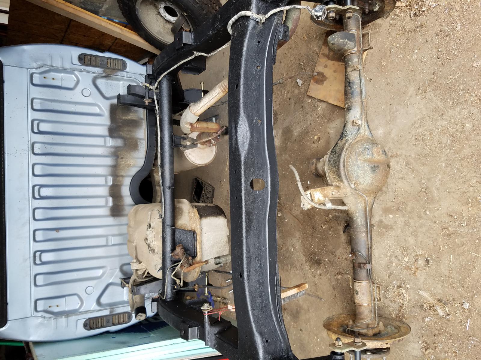

    Has it really been 4 years since I posted to this thread??

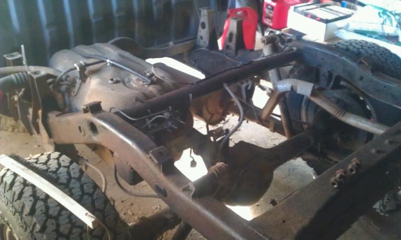

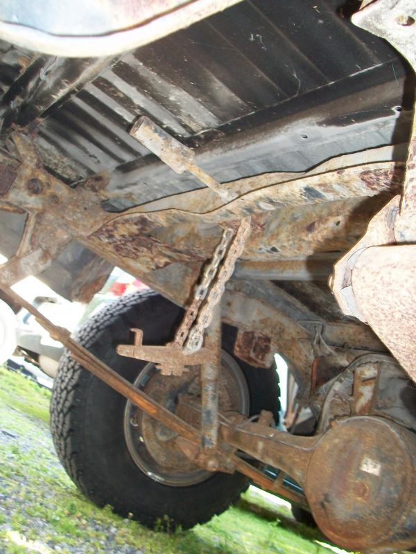

    I would love to come back and say the build is done and it has been a very productive 4 years. But sadly not much progress was made since the last post. However, I am back on the Ram 50 project and have spent the last few weeks completing the following:
    - Cutoff old upper leaf spring bolts
    - Pulled off the leaf springs
    - Striped all remaining pieces from the back half of the frame
    - Prepped the frame for painting and coated with Eastwood Rust Encapsulator (x3 coats)
    - I have ordered new bushings from Siberian Bushings (before the big political crap started kicking each others delegates out) - hopefully doesn't cause economic turmoil, as I am still waiting on the bushings to leave the country.
    - New rear shocks - Gabriel G63419 - they are little bigger than the old stock shocks

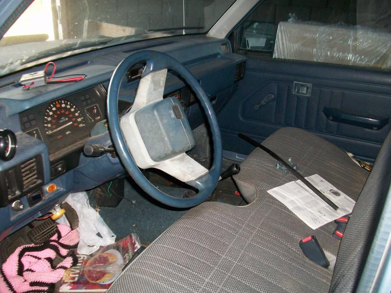

    I am at the point where re-assembly is on the brain. I want to get everything on the back-end put back together so she can leave the garage again. I know there was still a smoking (running rich or burning oil) issue when I started on dealing with the frame rust, so I know that still needs my focus before she is road worthy.
    Once that is taken care the next phase is the interior. My wife is a project/diy enthusiast and we are looking to re-upholster the seats, new flooring, roof panel fabric, etc... The one big mystery I still need to solve is how to deal with the Sunroof hole, now that I can not find a replacement piece of glass. I figure I'll likely close it up, just need to settle on how I want to accomplish this.
    Please don't judge what you see in the photo, I thought about cleaning and painting everything, but decided leave the fuel tank and axle alone for now.
