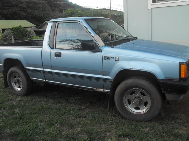

    The strip below where the door is, on the outside of the truck, is rusted out and I'm wondering if it can be taken off and replaced. If not any way to fix it without taking it to the body shop? It's not real visible on the photo, but it is bad on both sides.

    I believe what you are speaking of is the "rocker panel"....its welded on as part of the truck cab. If its rusted you need to cut out all the rusted metal and sand down or grind any areas that havent rusted through. You have to be real careful with rust because its like a cancer that keeps coming back. The best way is to get a patch panel from another truck and weld it in place. If you dont have a welder you could use some pop rivets, but that would be a less than ideal repair. Most body shops charge 35-40 per hour I think and you could get them to weld a patch for you and then you can get some spray cans and paint it yourself. Then there is always bondo, fiberglass, or bondo-glass but that type of repair wouldnt last as long as with a metal patch.

    It shouldn't be too bad. If you find a max or ram 50 in the junk yards with rockers in great shape. Unless it'll have to be a patch job. Gl.

    Have the same problem as you. Clean out the body drains just under where it rusted, very likely why it did in the first place (full of water).
    What I did to "fix" it was to cut out the rusted bit, sanded out the rust, and hit it with some rustoleum paint. Then rather than patching, I just got a couple pieces of stainless sheet metal cut and bent to fit, set it up for rivets, sealed with silicon and covered the hole. Looks like vanity trim and still works as a repair.
