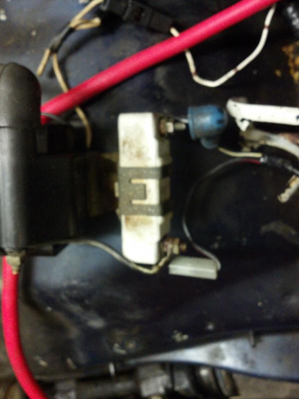

4. Got rid of the old ignition coil and put in a msd blaster coil with resistor

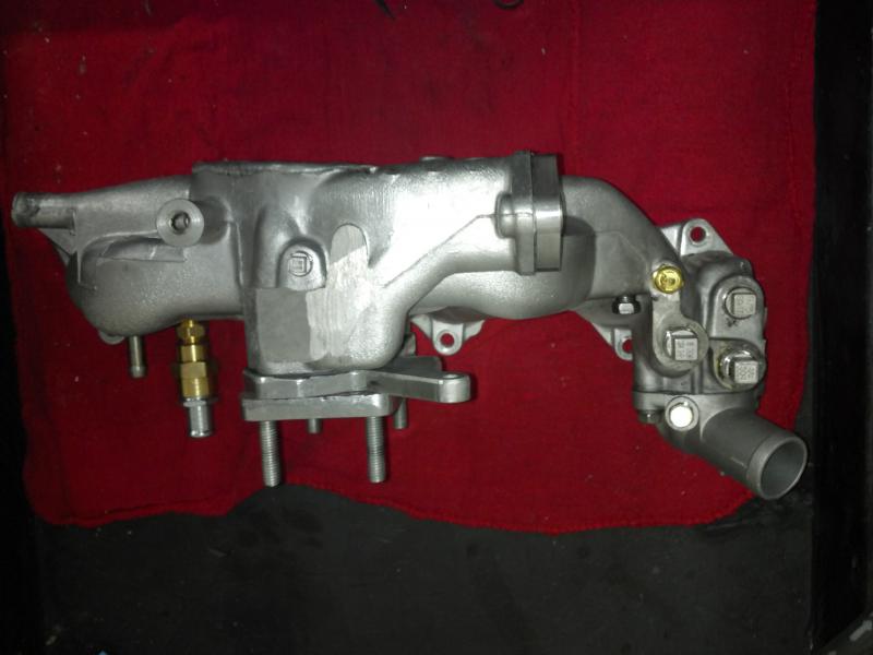

6. My dad and I machined the intake hole from stock 2 holes to one oval that fits the weber and we cut the egr down on the primary and filled it with machinable j/b weld, so no gas would flow down the hole and sit. We also machined it down to help the flow in the intake better hopefully. And then i cleaned and removed all the vacuum switches and plugged the holes with stainless steel plugs, put a 185F thermostat with a new thermostat housing.

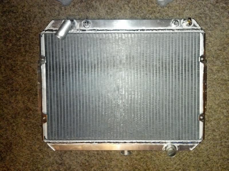

7. I bought an all aluminum radiator and had the valve cover powder coated black.

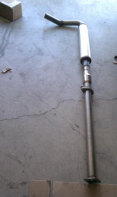

8. Then on the way I have new single port distributor advance, cap and rotor, mds 8mm plug wires, and pacesetter armor coated header.( pacesetter wasnt my first choice but for now it will work i hope without to much fixing.)
