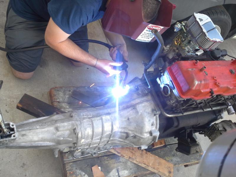

still a project in progress, the body is an 83 mighty max but the engine is out of a mid 80s dodge d-50
and its a diesel (4d55) to gas swap 4g63, 4 speed stick, with a new carb. i have spark and its timed, but its still wont start just back firing and spitting out of the carb. checked the plugs, wires, idk i could use some ideas. im going to do a compression test this weekend and see.
