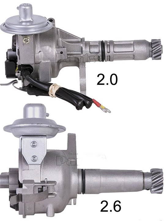

    anybody know the difference in 2.0 and 2.6 distributor,are they interchangable?
  4. #29
    I doubt it very much that they are compatible at all. If you need something out of a 2.0 dizzy, I have a couple of them sitting around with internals.
    Count the sprocket teeth and if you have both, match them up.

    thanx BradMph.mines is 2.0 but i picked up a 2.6 distributor at the pullapart today just because. also got the carb coil and ecu off it.i cant help myself,going back tomorrow to see if i can get the whole truck

    the only 2.0 distros that work on 2.6 are the 79-82 years, but the curve for the advance is different. the 83 up 2.0 is a different series of motors than the 2.6, so they definately won't work

    the gears look the same but 2.6 shaft is shorter and thicker. I just snag parts when I see em doesn't matter if I need em or not
