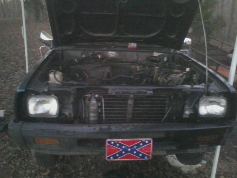

    sooooo, it begins. got it tagged today. me and this tag have seen a many of projects together!securedownload (4).jpg
    you will also need a front sump oil pan,pick-up, and timing cover off a 70's something with the dipstick in the cover.
