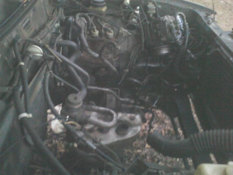

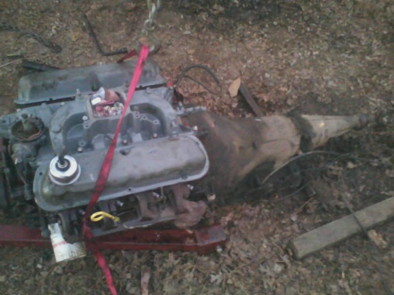

    302 edelbrock 4 barrel intake and a c6 tranny. not as pretty as Fordibishi's but im not going for looks this go around! the guy told me the engine came from an 84 mustang but looking at the exhaust manifolds,im not so sure about that.securedownload (3).jpg

    you will also need a front sump oil pan,pick-up, and timing cover off a 70's something with the dipstick in the cover.
  18. #43
    11-29-2013
    33
    dawsonville/ga
    1985 Mitsubishi Mighty Max
    Fordibishi, I yanked the tranny from a 78 van with a 302,the engine was complete with the exception of the carb and half the dizzy.. imagine that,huh. anyways the timing cover should work out fine and im guessing it should have the front sump pan also. ran out of daylight today. thanks for the intel.

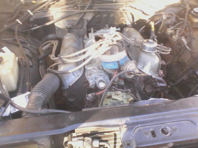

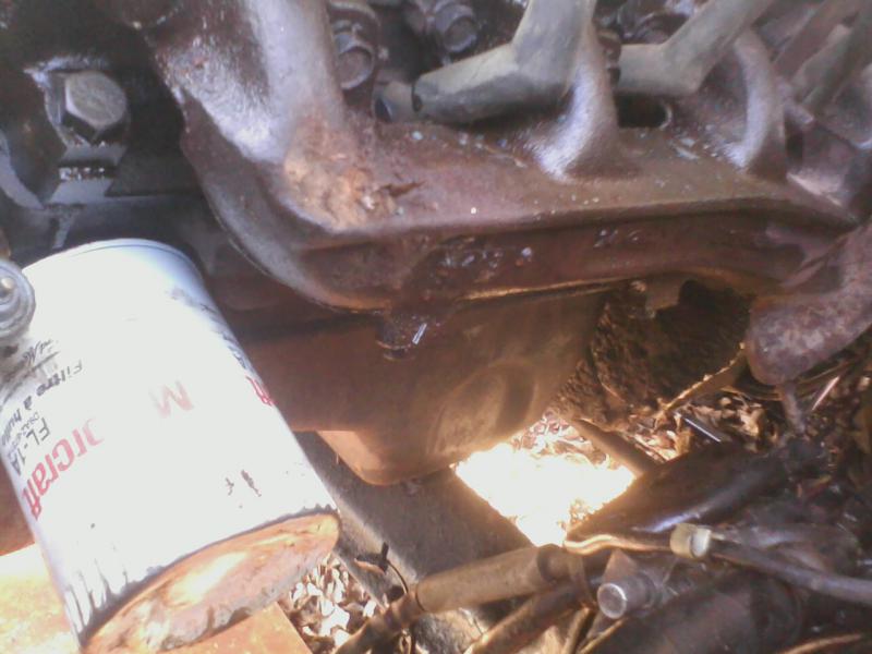

    and this why Fordibishi says to use front sump oil pan, this is pic of the rear sump. it sits on the frame, STUCK. Not because I didn't believe him, I just had to see why.securedownload (6).jpg
  23. #48
    lol yep. that's why I went to a front sump, you can get a cheap chrome one from Summit. The reason you need a new timing cover is the dip stick is on the right hand side at the front to go into the front sump. Or you can use your existing one and drill a hole to put the new dip stick tube into again Summit carries them in chrome or go out to the wrecker and pull one off a 70's car and you will see where the hole is. You will also need a front sump oil pick-up tube that you can get from any auto parts store.
