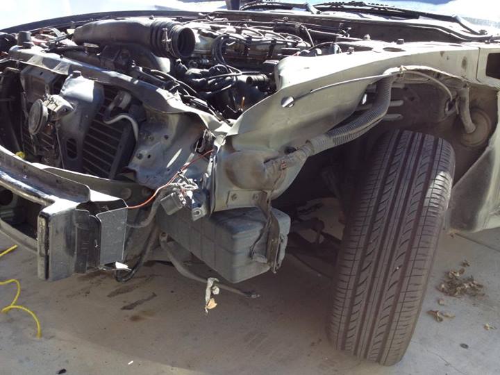

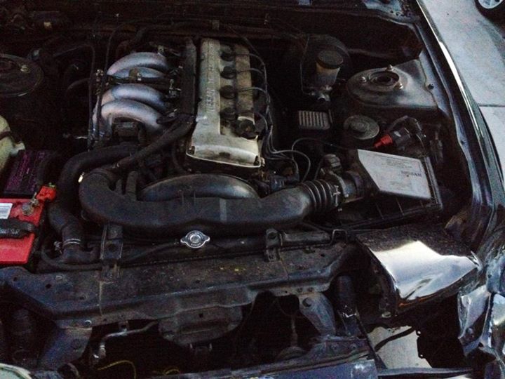

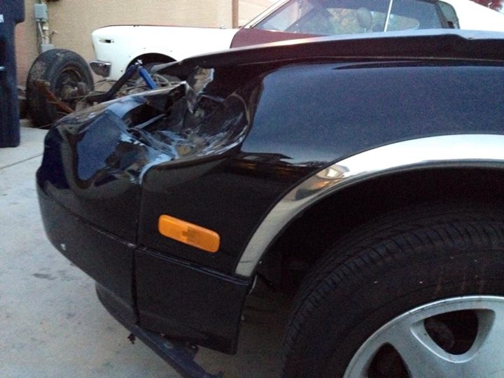

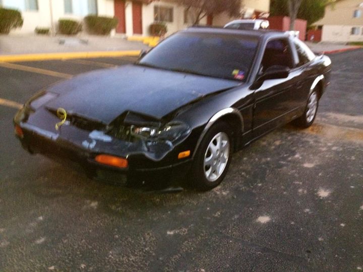

    Here's what we started with. Previous owner got run over at an intersection for driving like all the other idiot drivers in Albuquerque. Perfect.
    1381710_710801858948049_501406922_n.jpg 1379849_710801875614714_395036841_n.jpg 1394324_710801895614712_1309382177_n.jpg

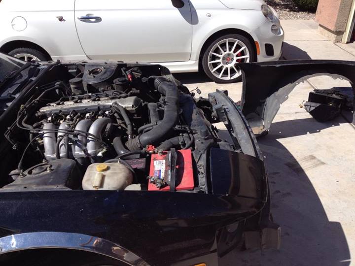

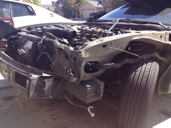

    I pulled the front end out most of the way. Still needs some slight tweeking.

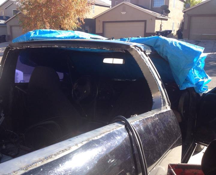

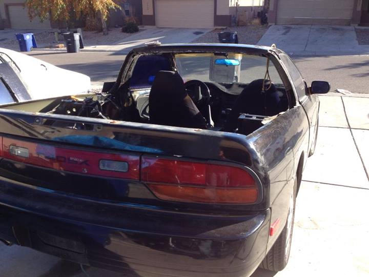

    Bradmph- haha, that's not the reason I cut it. The previous owner did take care of the engine pretty well, but the rest is questionable. The exhaust is falling apart, interior is garbage, and the front end wasn't the only damage. The doors didn't shut right (prior to cutting). It's all a bunch of little stuff that adds up. It also had a moonroof at one point that was replaced with a half-assed ragtime sunroof. The roof skin is pretty bad, I'm just going to replace it and leave it a solid roof.
    Prior to cutting, I welded braces in between the pillars. Then I moved the section of frame i cut out from the rear of the pillar to the front of the pillar. I didn't get pictures of it so it may not make sense, but in the end, there will be plenty of reinforcement so it will not fall apart.

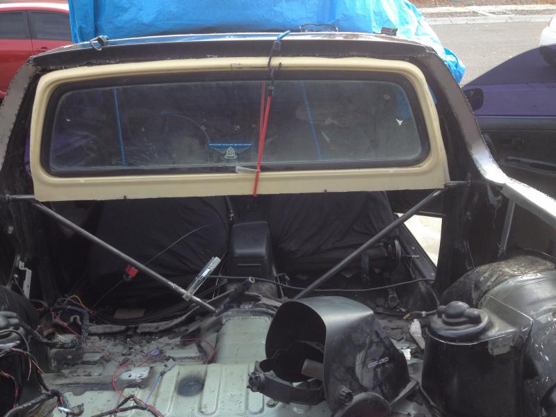

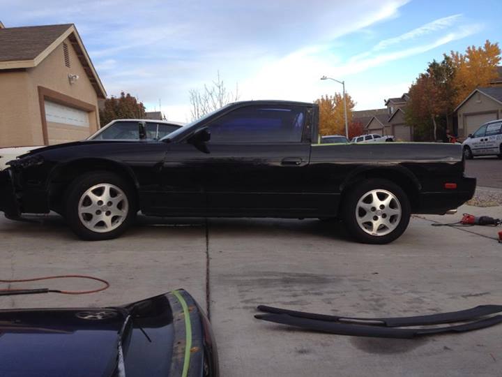

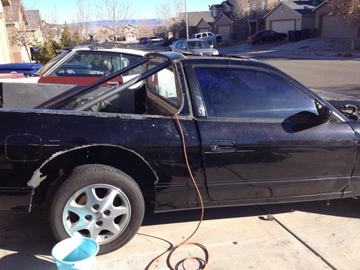

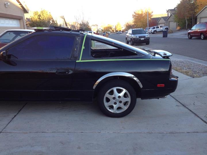

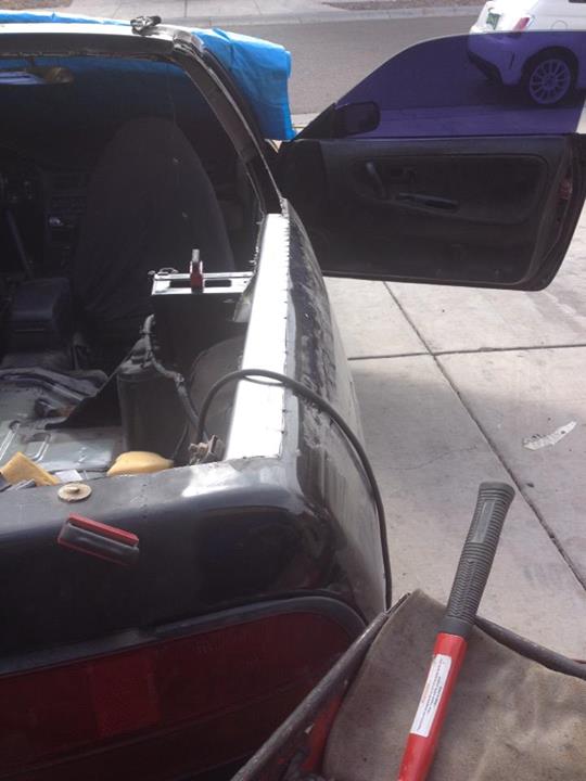

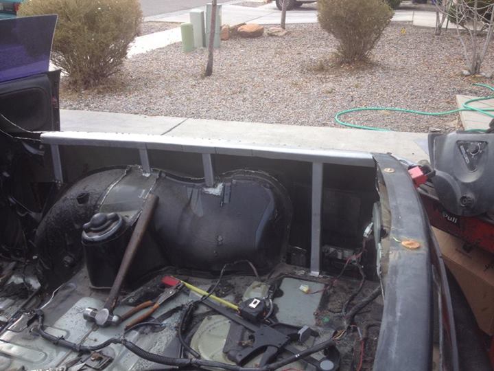

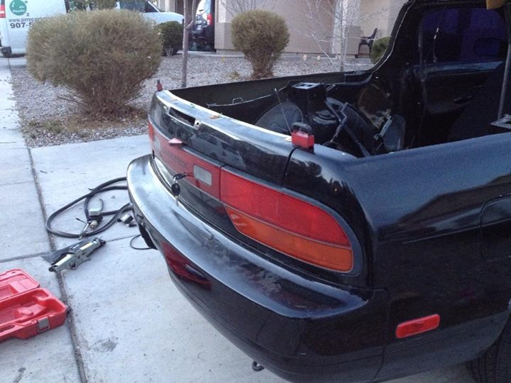

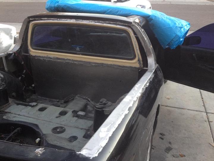

    Well, no luck finding a del sol or sw20 to cut up and the only Porsche 914 had a smashed rear window, so I defaulted to an 83 toyota pickup window. It's smaller than most other mini truck windows so it was the best choice.
    I built a triangle brace to tie the sides together more and be a frame for the rear wall.

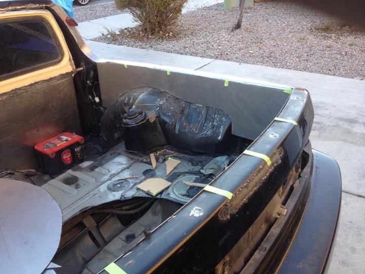

    A little more done. My bottle is empty now so I couldn't get very far.
    62331_735866819774886_1943162214_n.jpg 1425682_736944206333814_1044571866_n.jpg 1454662_736944236333811_1796891008_n.jpg

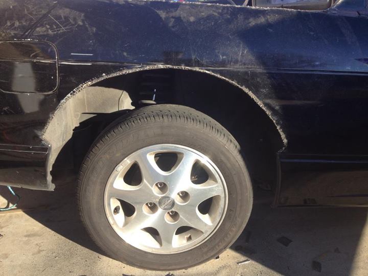

    Took a break between making panels and cut the right side wheel arch and tacked it together.

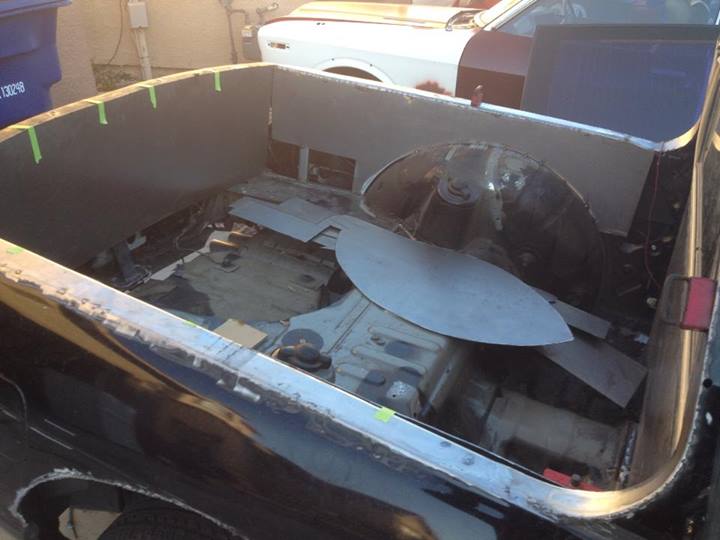

    I'd like to give a special thanks to one of your mighty max brethren for donating a piece of itself for this build. lol

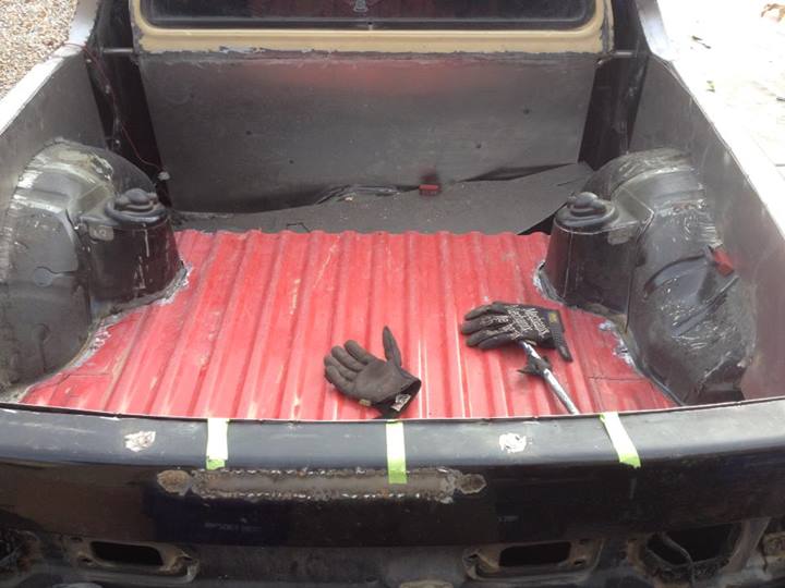

    Got half of the bed floor done. The front half will be a hatch with the battery and a misc supply spot.
    1453375_737478996280335_1787139561_n.jpg 1451534_737866052908296_325226861_n.jpg 1471246_738484256179809_256468433_n.jpg

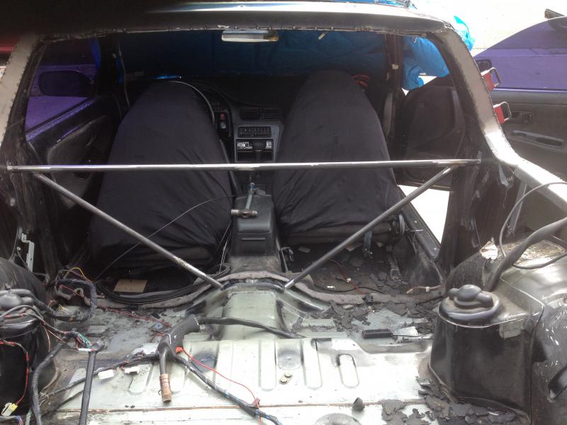

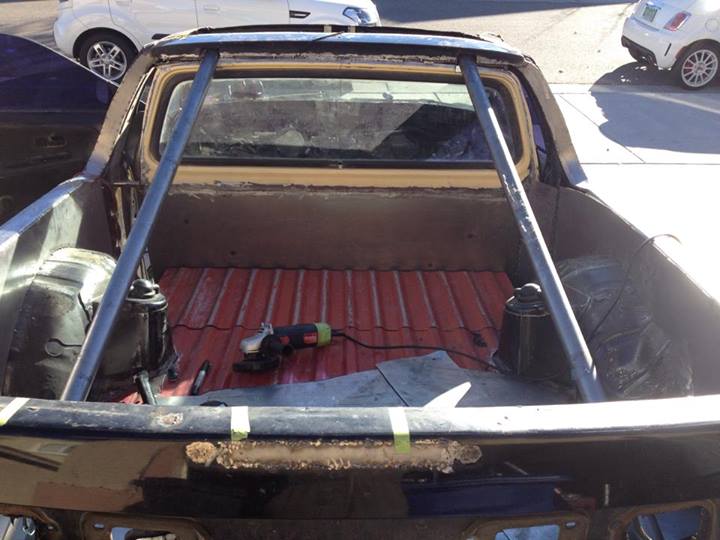

    Last weekend and this weekend;
    Got the front half of the bed made. It will be a hatch with the battery and tool compartment under it.

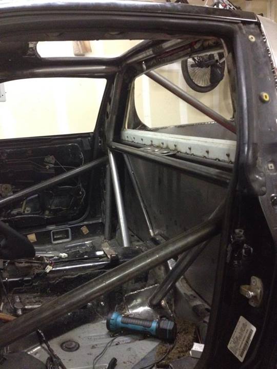

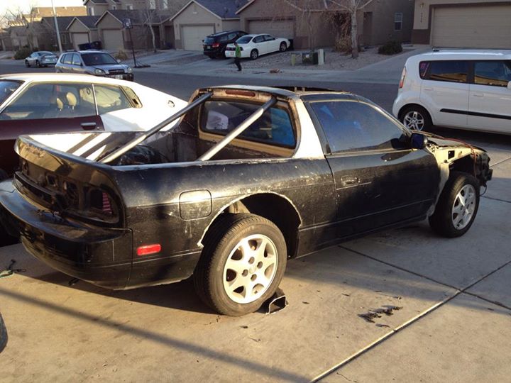

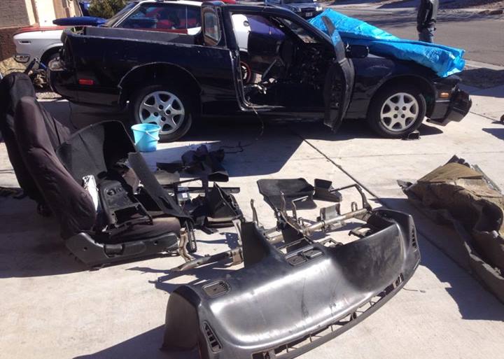

    Stripped the interior out and mocked up the main hoop for the roll cage and the rear bars.
    1505335_746276785400556_535553130_n.jpg 1526461_746276855400549_751024727_n.jpg 1479124_746276892067212_916757892_n.jpg

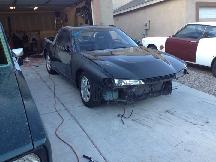

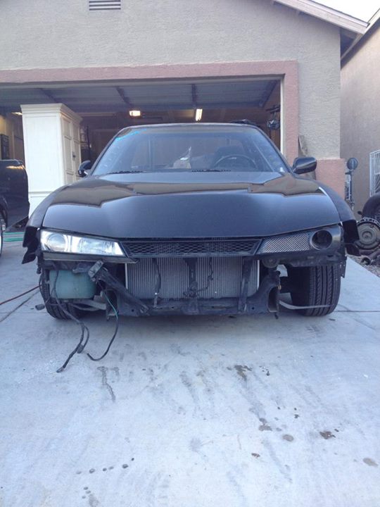

    Sorry for the lack of updates. I've been busy doing work for other people lately. Just took some leave to try getting this on the road for the first event (march 16). Let's hope it's not wasted leave.
    I would add a bunch of progress pictures, but even after the amount of work I've put in over the last 2 months...doesn't really look very different. lol
    Cage is 80% installed, should be done tomorrow. Fenders, hood and misc suspension parts are on the way. The bed floor is permanently in and the hatch is attached (not the way I originally planned, but it works for now). The front corners inside the bed and the pillars are really what I spent the most time on. and the whole rear section is stitch welded.
    Here's how it sits as of today.

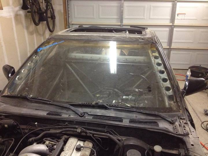

    Cage and gussets all installed.
    1609715_821367727891461_636279776842932722_n.jpg 1513725_821367757891458_4044794898572468133_n.jpg

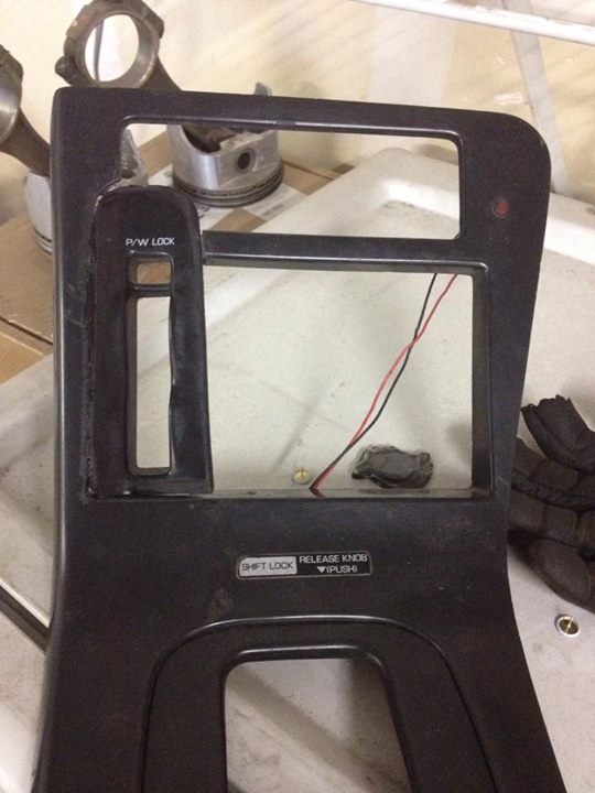

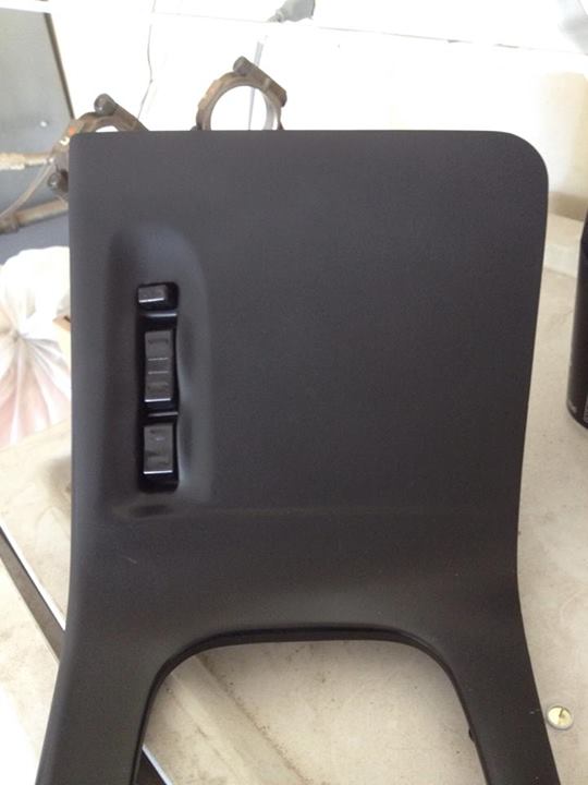

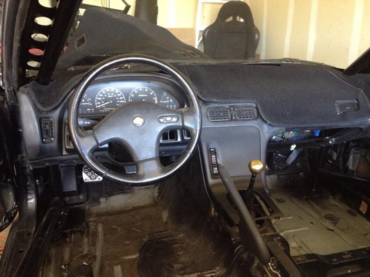

    A little modification to relocate the window switches to the center dash.
    10262219_821957121165855_8076223633103697812_n.jpg 10247200_825870814107819_1291578611564091863_n.jpg 10320560_825873714107529_1181547259447334753_n.jpg

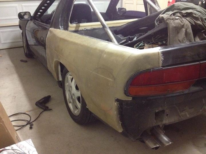

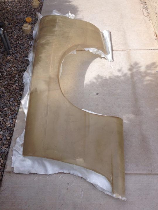

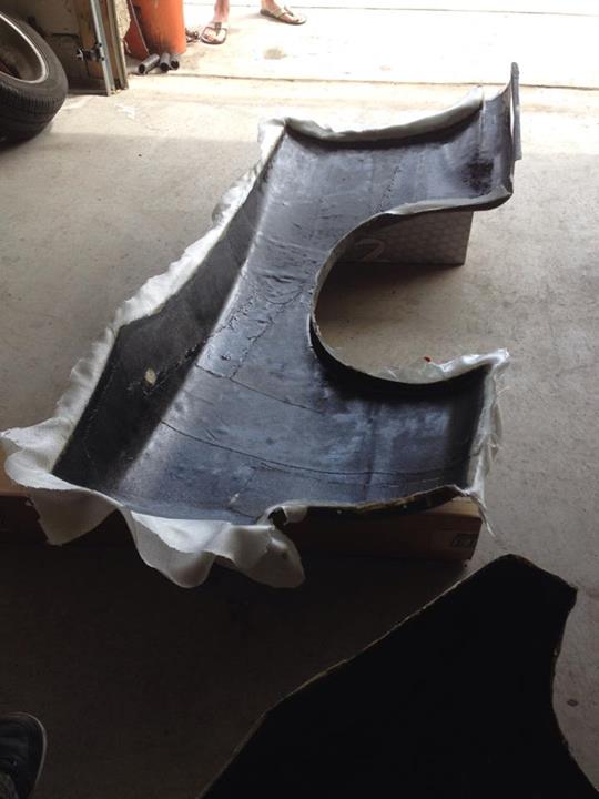

    Put the body kit molds to use and made the quarter panels (50mm oversize)
    10338253_826401977388036_7743987376632203171_n.jpg 10270315_827550743939826_4845013683425417549_n.jpg 10308166_829805453714355_3839853485566545953_n.jpg

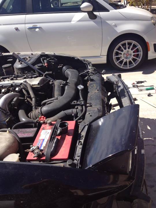

    And after 4 months of waiting, the correct hood finally came in. Test fitted the fenders, hood, headlights and grill. Still a lot of work to be done and brackets to be made.
