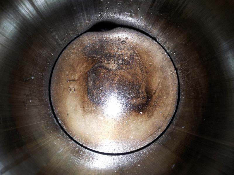

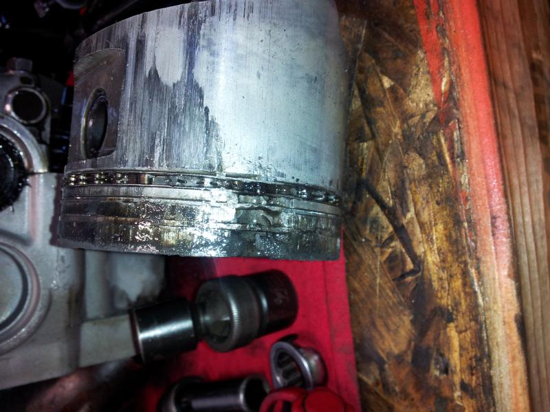

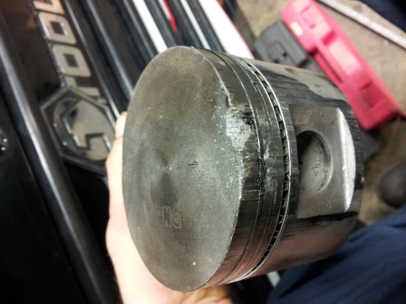

    I had the motor rebuilt 3 months ago, put it in the truck and got it street legal 2 weeks ago. hit the interstate thinking it was all good and didnt get a mile before this happened
    pulled the motor and sent it back thinking it was mechanical failure, they warrantied it got it back put it back in the truck got it running good and took it down the road. then bam!! it happened again trying to maintain 55 mph round 2
    so needless to say, im not going to send it the machine shop for my screw up. so im stuck fixing it. no problem there.. but what im looking for is the root problem to this. i run 93 in the truck, with a new weber. set to factory timing specs.. Bad distributor? im at a loss

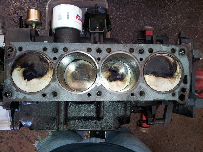

    Yeah this has been a head scratcher for me, brand new carb (weber) i set timing to factory spec. One thing that i forgot to mention is that it only happens on number 2, the rest of the cyl look great, plugs looked rich..

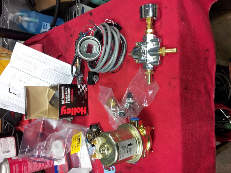

    ok so i got the motor tore down, the head is at the machine shop getting checked, new piston being pressed on the rods. i bought a new carter 4070 fuel pump, and a new regulator with gauge to set for 3 psi for the carb, then i also picked me up a air/fuel ratio gauge kit so i can keep a eye on the running of the motor, plan on making a pillar mount for the gauge for a clean look. and with any luck i should have this truck up and going!!

    20131116_135727.jpgI was trying to find a regulator with return outlet so it will not burn my pump up, but i ended up with a holley 12-803 (1-4 psi)
