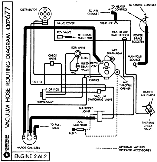

    Hey kla, welcome. I don't know if you might find this helpful (assuming I embedded the image correctly), but I found this diagram back when I was trying to do my weber conversion on my 2.6L engine. The only catch is, if you have the Mikuni Feedback carb, there are more hoses then what is pictured. But this should give you an idea of the hoses under the hood.
