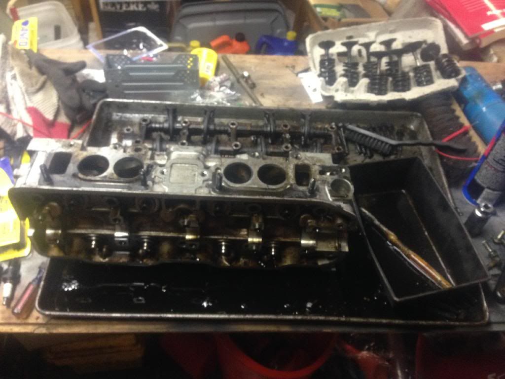

    its this
    so the truck has had a slight overheating problem where it will go most of the way on the gauge when the truck first warms up but once it hits im guessing 230ish the tstat opens or something finally flows and it goes to the middle of the gauge and never moves again and when starting the coolant system will pressureize so i figured what the hell it leaks oil has the coolant issues so ill just rip the damn thing apart gaskets are cheap enough

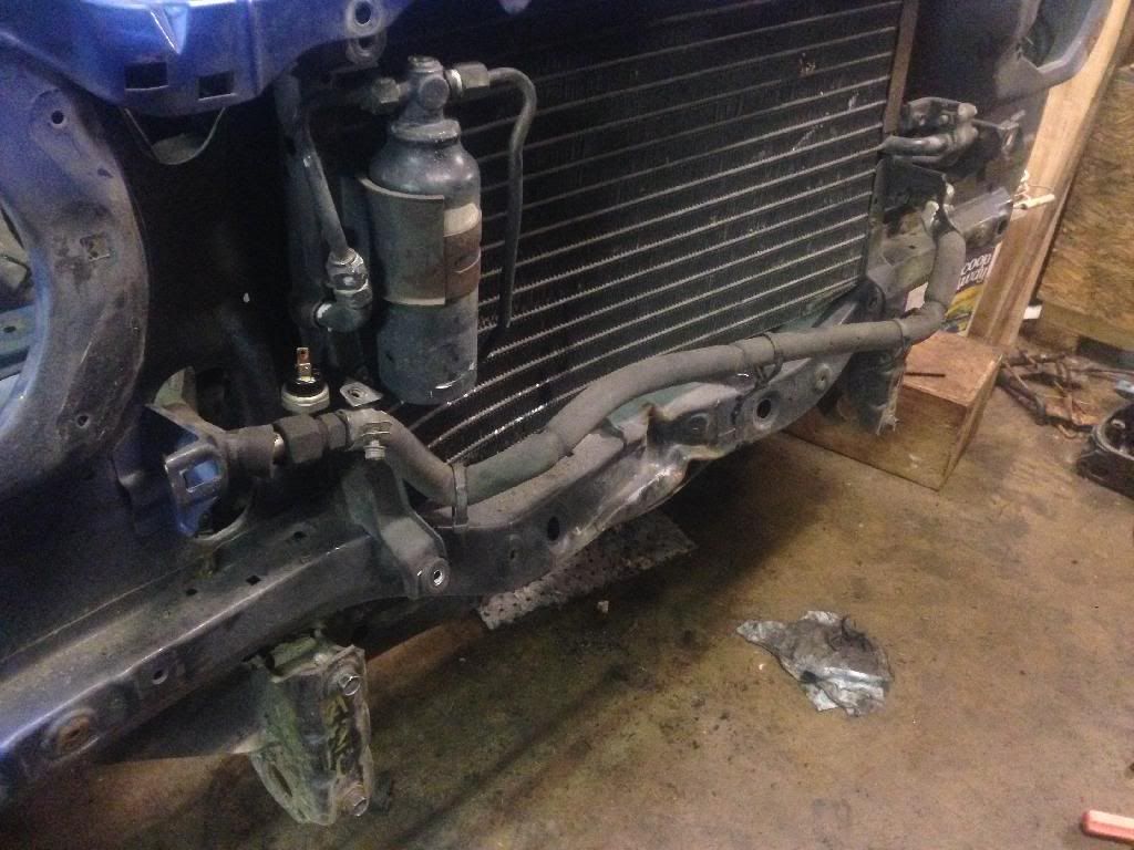

    and since i have all of this going on ill take the front end apart and replace the destroyed core support once i get the a/c system emptied and try to get this truck back to 100%

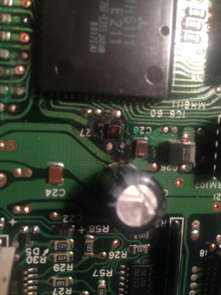

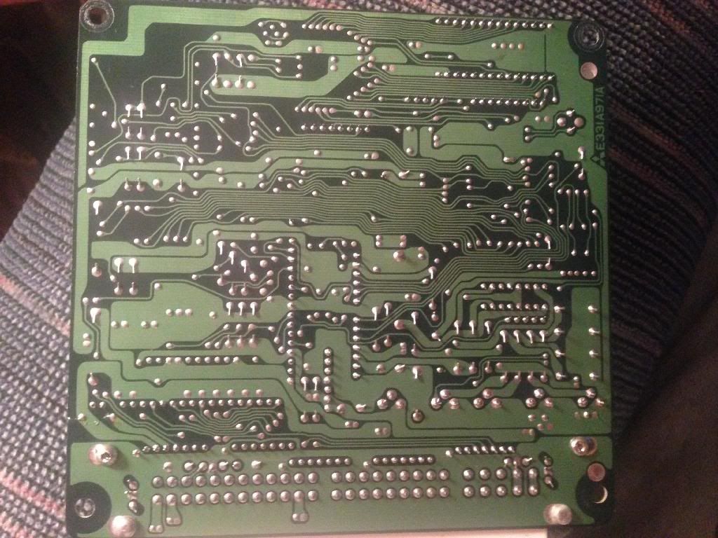

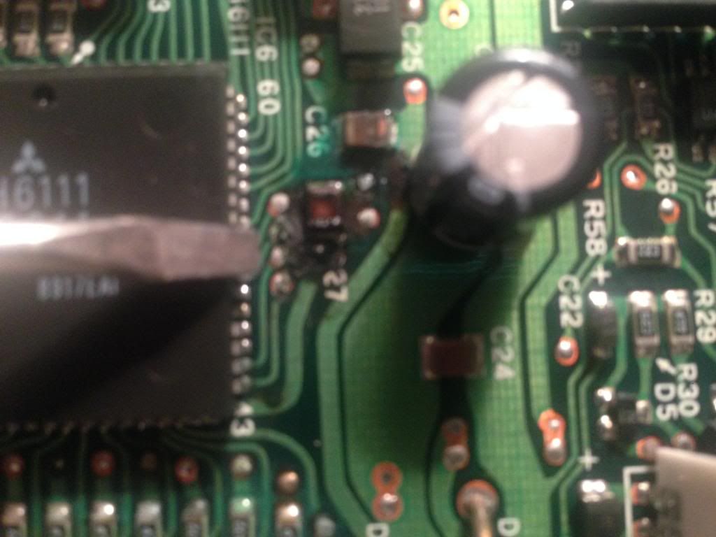

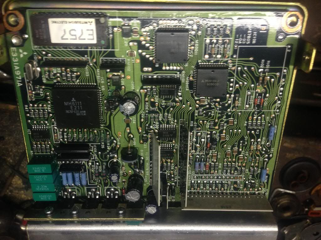

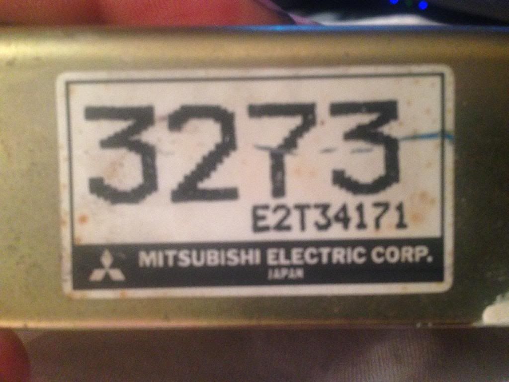

    pictures of the ecu as requested from the shout box
    the backside of the board

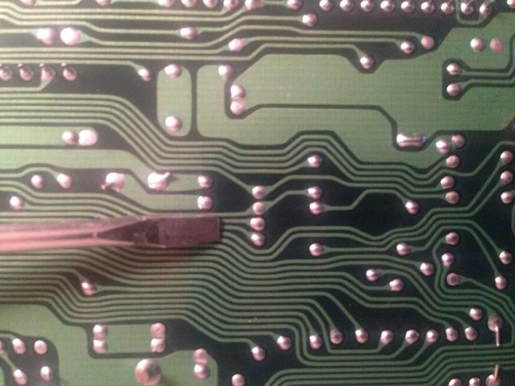

    the damaged area the 4 solder points the screwdriver is pointing at are the same on each side

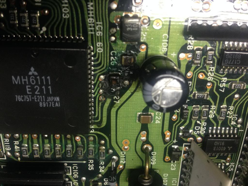

    better pic of the damage

    You are one determined sleauth, RNMM! And to find that circuitboard problem took some not-giving-up.
    How cool, the way you used an egg carton for the valve assembly!
    Since we have the same trucks, your posts really help me in many ways...including what to watch for and what to do to fix it. Thanks, though sorry you had to go to so much agony.

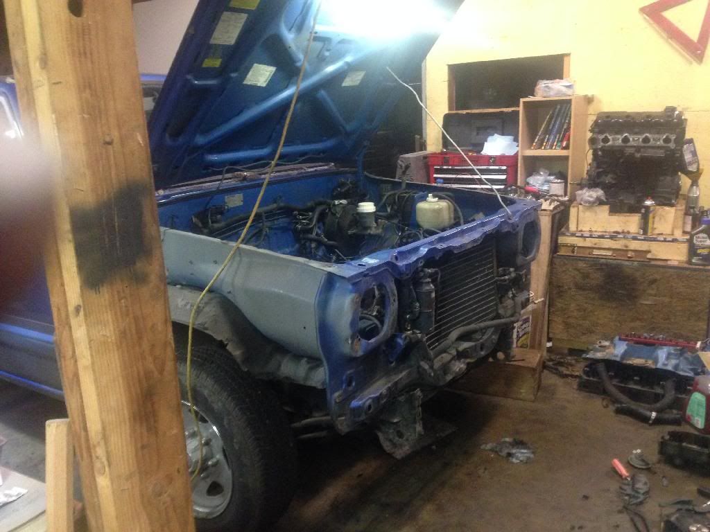

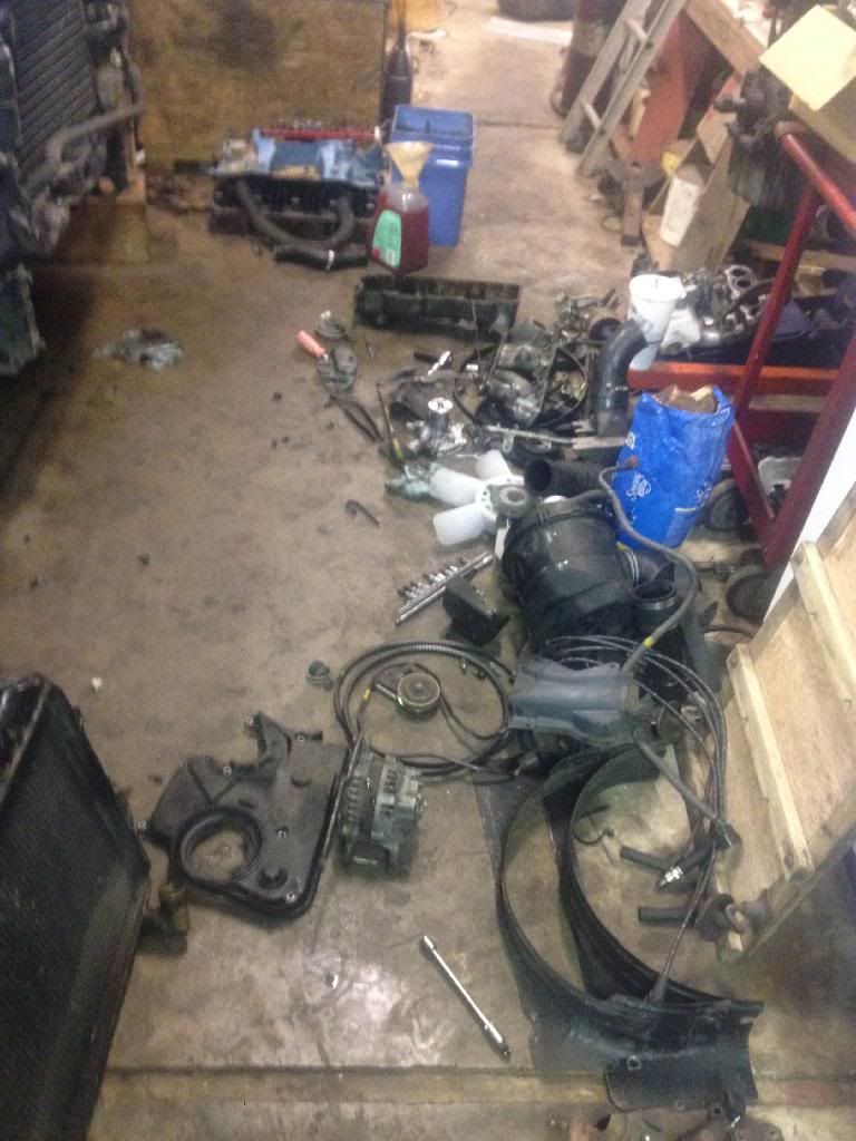

    I use egg crates for all my disassembly you can keep them seperate that way like i have a 18egg carton with all engine bolts one with body stuff and so on keeps things organized to make reassembly a lot easier now im gonna go yank out the ac then core support then engine and trans and just go through everything while im here gaskets and oil are cheap and my labor is free so ill go have some fun!

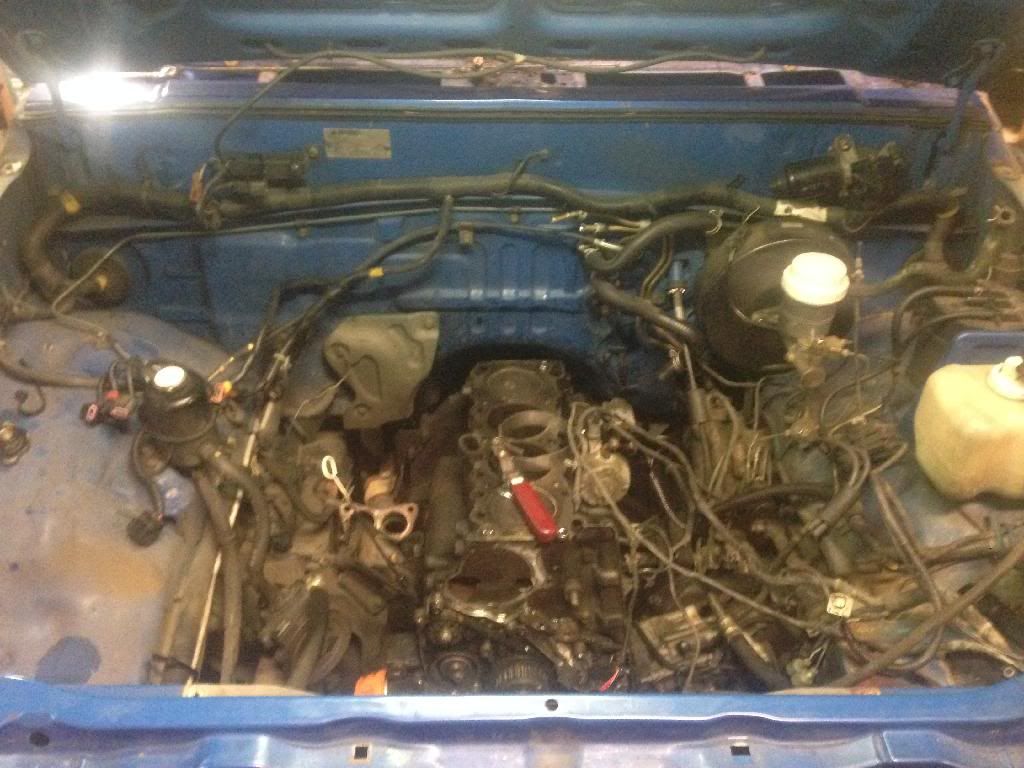

    no more pics yet but the trans engine driveshaft is all out of the truck awaiting either a refresh and install or a new heart havent decided yet but ive got a start on removing the core support so i can get the new one put on and at least try and make the truck look good lol what a major PITA it is to drill out all the spot welds though but it will be done soon and then go sit under cover so i can take care of other projects

    Are you going to clean up and rebuild the ECU yourself? There was a good tutorial on this on the net and you look like you have the skill and patience to do it. The capacitors that leak and should be replaced are pretty inexpensive from what I have been told.

    Idk i might its worth it i suppose but other pices might be fried so who knows might just get megasquirt so i can log view data and tune it to my liking
