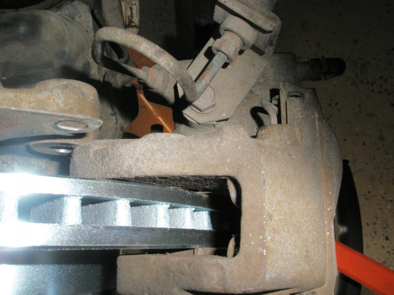

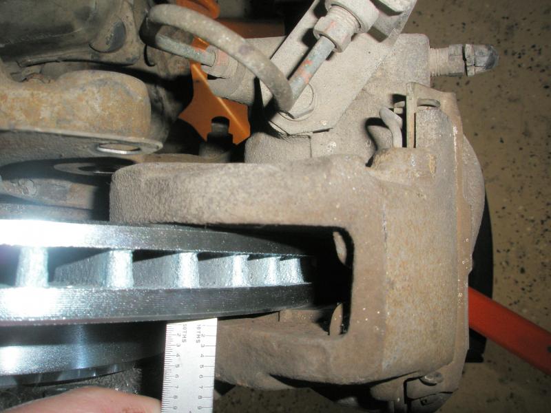

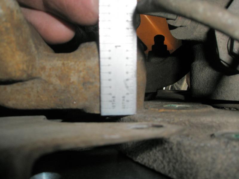

    Here are some pix I just took. You can see the caliper is hard agaisnt the inside surface of the rotor, yet is still too far inboard to be able to slide it back over it's mounting bosses on the back of the spindle.
    At this point, I think my solution is to take the caliper mounting brackets and have about a .100 machined off, .050 just to allow it to slide back over it's mounting bosses, and .50 to center the caliper over the rotor.
    Thoughts?

    Did you use toyota tacoma rotors or toyota pickup (pre-1995) rotors. There's like a 1/16" difference in mounting depth of the rotor which is why may not be centered in the caliper.
    Yep looks like the rotor center line is just a little different from the stock rotor. The only way to see how much the difference is would be, to take a new stock rotor put it on and measure from the caliper mounting on the spindle to the rotor surface. You might need to take some off of the spindle mounting area also.
    Please place everything you come across in the thread just like post above. It shows the important things that people need to think about before someone takes it upon them selves to do the swap. Good pictures too......
    I had the same problem with my 81 so I went to the junk yard and got the brackets and calipers off an 88. the only mod I needed to do was grind a little off the spindle bolt holes and they now line up fine. The other thing being that the first gen are sliding calipers where the Sec gen are floating and are a much better brake and as they use the same spindle and rotor it doesn't matter which style you go with.
