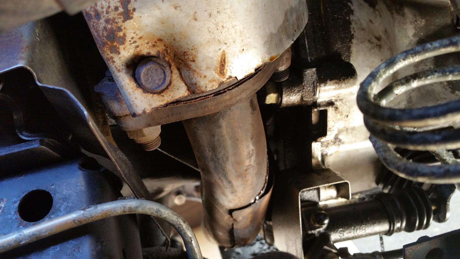

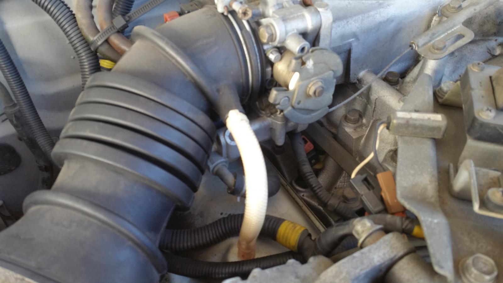

    I have failed twice now with the V6 mighty max. I attached the two tests to this post. The first test was before the catalytic convertor replacement.
    High NOX, is failure reason, but O2 is also high. Tech guesses that my combustion temp is too high, due to lean condtion, and that I might have a vacuum leak, and exhaust leak.
    It does run rough before it is warmed up, and has extreme hesitation on acceleration (to the point it sometimes dies when gas pedal is pushed) before warm.
    I did lose a tube that goes from passenger side valve cover to the rubber duct right before the intake manifold. I replaced it with a tube I made myself from an old shower hose. The cover side is really tight, but the duct side is just slid in but not a super tight fit. You can see from the picture that the hard inner plastic tube has no barb. Could that be the reason? I will tape the tube to the intake duct, and see if that helps.
    (Pictures attached)
    There also may be an exhaust leak on driver's side exhaust manifold. Not sure, as oil also drips onto mainfold and pipe from the slow valve cover leak.

    27

    Ok, here are comparison pics of where my book says the EGR system should be, and what is not there on my engine.
    Also, it appears that I have an engine built to federal smog regulations, and not CA as can be seen on my engine under hood sticker.
    Perhaps that is why I don't have the EGR system?
    If anyone is familiar with an EGR system that is located in a different place, let me know.
    I did notice on the pic of the header, to exhaust, that my gasket looks pretty bad. That may be one of the locations I have an exhaust leak.

    Also forgot to mention,(sorry), replace that 'shower tube' with a correct size piece of vacuum line.
    -The loose fitting is a potential area for 'unmetered' air - read not 'seen' = no signal to ecm= no inj
    pulse width increase net result lean mixture.

    Repair all exhaust leaks !!! -any- exhaust leak will dilute the machine sample, simply put, sample is lean
    Engine is not running lean.
