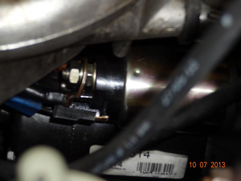

    A couple of days ago I tried to start my truck and all I got was a "click". After a couple of minutes of inspection, and trial and error, I wacked the starter a couple of times and it fired right away. So the next day I went and picked up a new starter and installed it. All excited, I hoped in, and "click". A buddy helping me, loosened the bolts slightly, and gave it a giggle. Tried turning it over and it fired right away. So I turned the engine off, and tightened down the bolts. Went for test drive, and drove to destination about 5 minutes away. Turned it off, tried turning it back over, "click". Inspected wiring and everything a 5th time, and gave the starter a couple of taps, and it turned over. On the drive back home, the vehicle died out on me 3 times while in motion (but would start back up while still in motion, I never stopped). Then it finally died after pulling in at home, and that was the last time it ran. Since then, I have ran a couple of new of wires for some fresh connections, added the MSD 0.8 ohm ballast resistor, and put on new battery terminal clamps. My 2 big concerns at this point are a) why do I only have 1 wire coming off my alternator (blue wire in pictures 2 & 3) where there is a "t" connector and autozone is telling me I am suppose to have a second going "somewhere" and b) why my starter won't engage to turn over the vehicle.

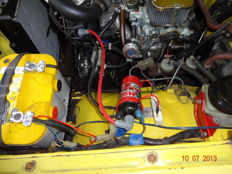

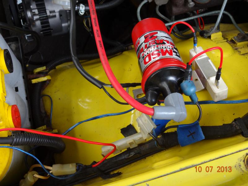

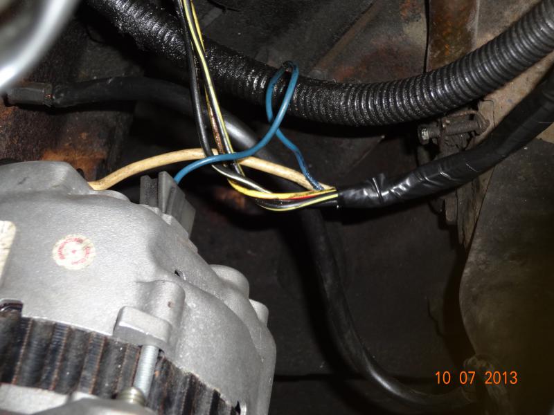

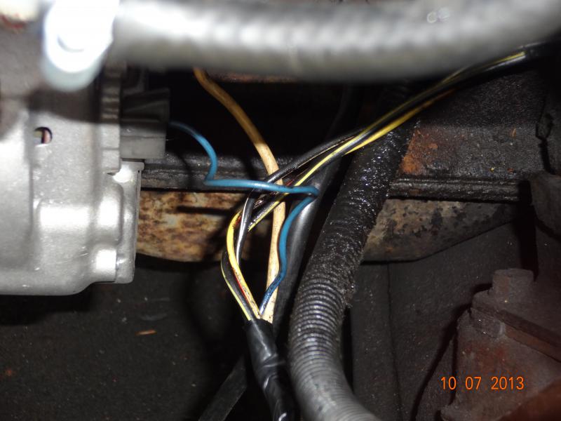

    Now, I've been really frustrated by the lack of info I have found for the wiring scheme for the alternator. Apparently I'm suppose to have 2 wires coming out of that "T" connector in photos 2 and 3 in the original post. I pulled back the shielding and I can't find any trace of any other wires. What is the deal there? Is it something I need to worry about or no. I just haven't been able to put my head around what it is for.
    Blue wire should go to the ignition and a white wire with yellow stripe should go to the charge light on the dash. you won't have the white/yellow wire if you have an amp or volt meter.
    the other thing to check is the starter exciter wire they sometimes break at the back of the connection and when you wiggle or move the wire a tiny bit it makes contact and will fire the starter. Also check the plug in under the dash that hooks up to the steering colume.
    Ok. perfect. that help put my mind at ease about the wiring. What am I checking for with the plug in? That it is properly seated with a good connection or what? My gut is telling me that it is boiling down to my starter. Is there anything I can do to make sure that the starter gear is properly alligning with my motor?
    Unplug the small wire going to the starter, use a test light or logic probe at the end of it then turn the key and see if the light turn's on. After that just have a buddy move the connector around and see if the light goes out while you have the key in "start". if the light goes out while you have the key turned on then you have a break in the wire somewhere. The break is usually with in the first 6-8" of the connector. A rusty connector will also cause this problem. take a real good look at it and replace or clean the end if it's rusty and try the starter again.

    I finally prevailed! Fordubishi you get the gold star on this one buddy! It ended up being the exciter wire on the starter. It had a less than secure connection. I pulled it off and put it back on (making sure it would stay in a well connected state), and it fired right away. Further more, it is running SSSOOOO much better with the ballast resistor that I added to the MSD ignition coil. And the cherry on top........ on the test drive, I finally managed to swing by the place where I had my exhaust done, so they could finally put the tips on that I paid for, and never got a year and a half ago. So here are a couple of pictures I hoped out and took when I got back from my test drive.
