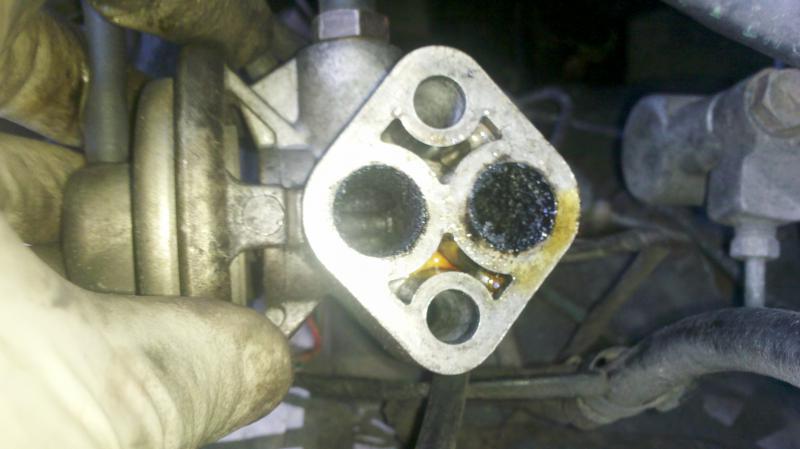

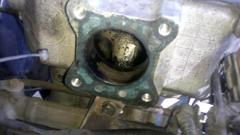

    Is that how I can have good compression across all four cylinders, an engine that runs solid, but still be burning oil at about the same rate you mentioned? My intake manifold and EGR look like that slime on Creepshow that lived on the lake and jumped up and ate that girl.

    Yes. Mine was fine (didn't pull intake tho as I just did exhaust seals. (since they run hotter.) That has stopped oil burning or lowered to insignificant level and NO smoking at ALL, cold or hot.

    You could have a PCV issue also to foul your intake...maybe replace the pvc valve...easier and cheaper also, first.
